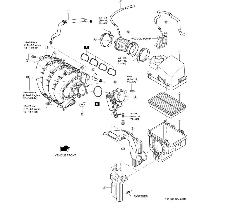

I have been trying to crack this one and can't figure it out.
This problem began in the late summer of 2022. It has actually improved in terms of frequency, and is considered intermittent, but it does still occur. I noticed a tendency for this to occur more in rainy cold weather as opposed to dry sunny weather. When the issue first began it was much worse. The car would not even idle for five minutes before shutting off. When I added coolant, it stopped stalling so much.
The following list is all the circumstances which surround the stall/shut off:
- Only occurs at idle in park. Does not occur while idling in drive or reverse.
- Only occurs when the vehicle has been warmed up and driven around for at least a half hour. It never occurs when the engine is cold or unused.
- There is no feeling of power loss. I.e., no shuddering. It does not vibrate at all. In fact, it feels like I'm just pressing the start button to shut the car off. It simply stalls.
- When this happens, I typically see the check engine light, charging system light and maybe the thermostat light or something else. The A/C and electronics continue to run for several moments, and the ignition button glows orange. The ignition button is unresponsive, and the car eventually shuts itself off.
- it can always be restarted easily without elongated cranking, and the light goes away within three to four start-ups
- The check engine light never flashes; it just appears solid once the car stalls.

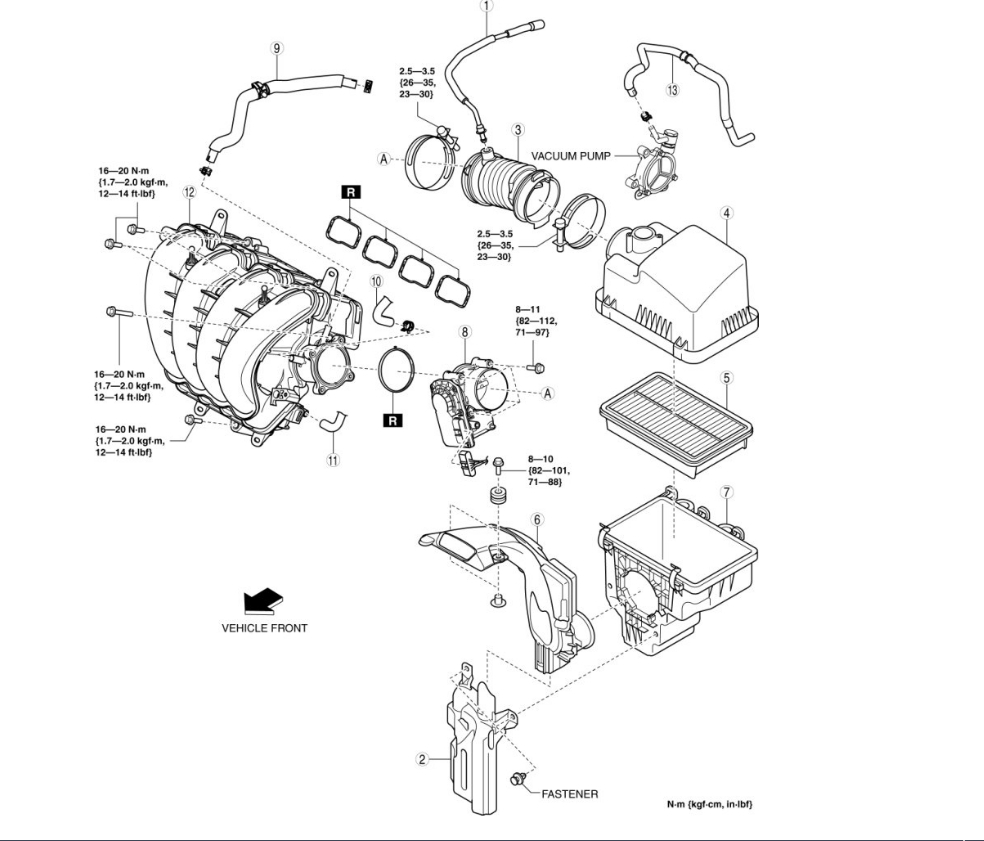

Thanks again for the detailed explanation. Even though the check engine light is not on we need to run the codes. here is a guide to help run the codes for the engine:
If no codes come up let's check the engine for vacuum leak when the engine is cold only. Please follow this guide:
And this guide can help as well:
If you have not cleaned the throttle bore, I would do that as well.
Check out the images (below). Let us know what happens and please upload pictures or videos of the problem.
