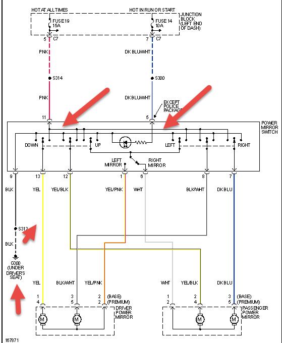

my electronic in the car are inop.
2003 CHRYSLER 300
164,000 MILES • 3.5L • V6 • AUTOMATIC
AJISALW
The radio, mirrors, dome lights, and door locks are all inop.

check fuses first windows and door locks are underhood then get it scanned for codes may be the tpiim module

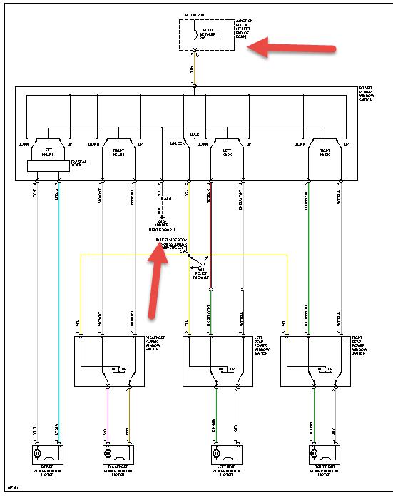

check items in pics fuse 19 runs radio, powr mirror etc. check circuit breaker 1 and 2 for locks and door and ground under drivers seat as it's for everything except radio and lights. fuse 19 is also for lights and have scanned for a body module problem.

I just checked under the hood it don't even go by numbers its letters and da 19 fuses on da side of the driver side dash is dome lights

have a pro look into this as I think it's something he can find for you the circuit breakers are in the dash panel fuse box. I think you have a broken wire between door and jamb is causeing the problem unless it's a switch
