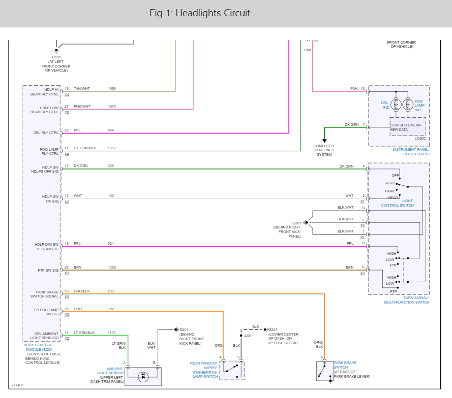

My drivers side low beam headlight does not work
2008 CHEVROLET EQUINOX
170,000 MILES • 3.4L • 4 CYL • 4WD • AUTOMATIC
90ZKIDD
So me and my pop have been going at it for a few days trying to figure out this problem. when i first got the car it worked, but after a couple weeks it stop working. I then change the blub and it worked again for like 3 months. now I'm just trying to figure out this problem. we checked connecter seems like I might be it but wanted a second opinion.
May 20, 2021 at 4:04 AM
  • 55,456 POSTS

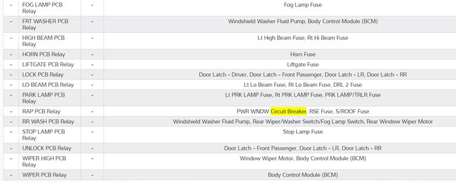

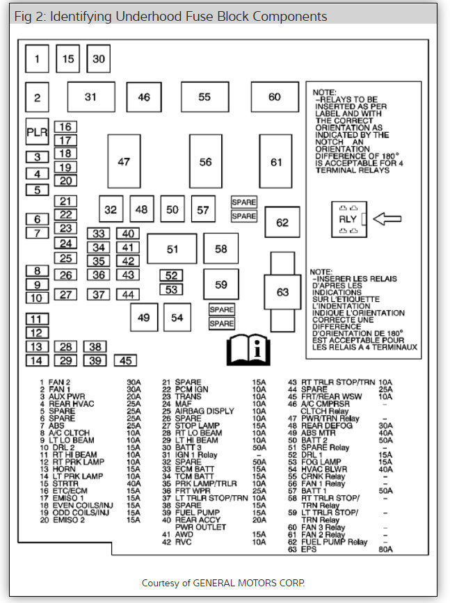

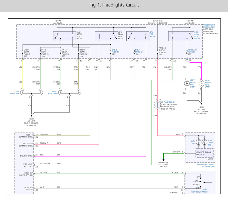

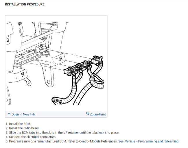

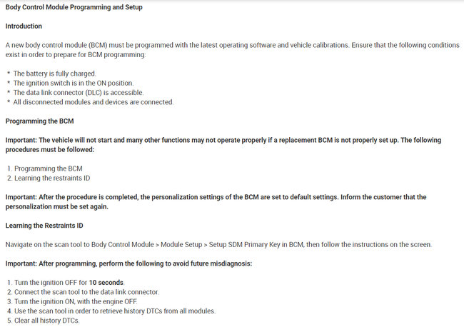

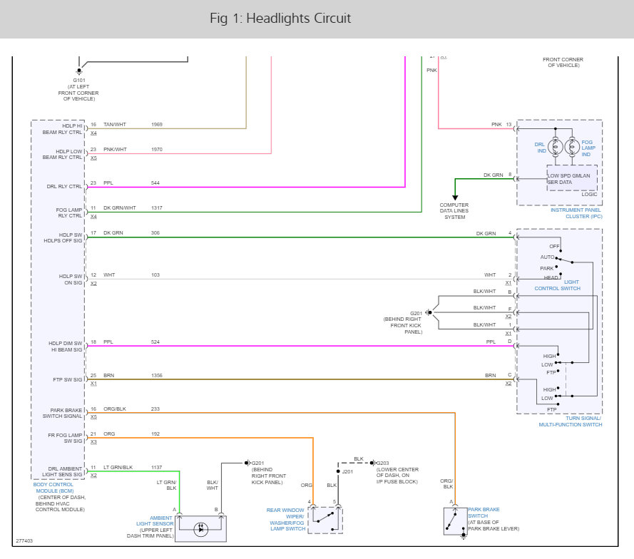

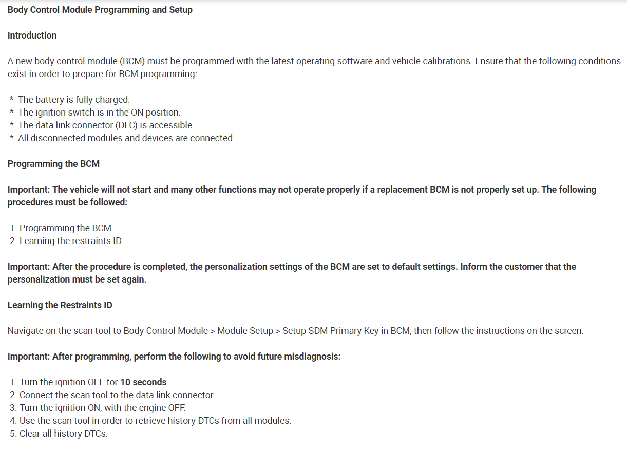

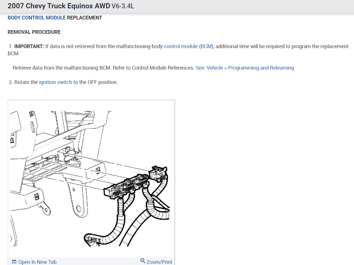

Is the bulb out again? if not lets check for power at the headlight. this guide can help. also I have included the headlight wiring diagrams so you can see how the system works. It could be the BCM which I have included the replacement instructions for that as well.

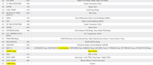

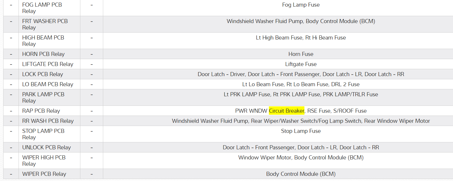

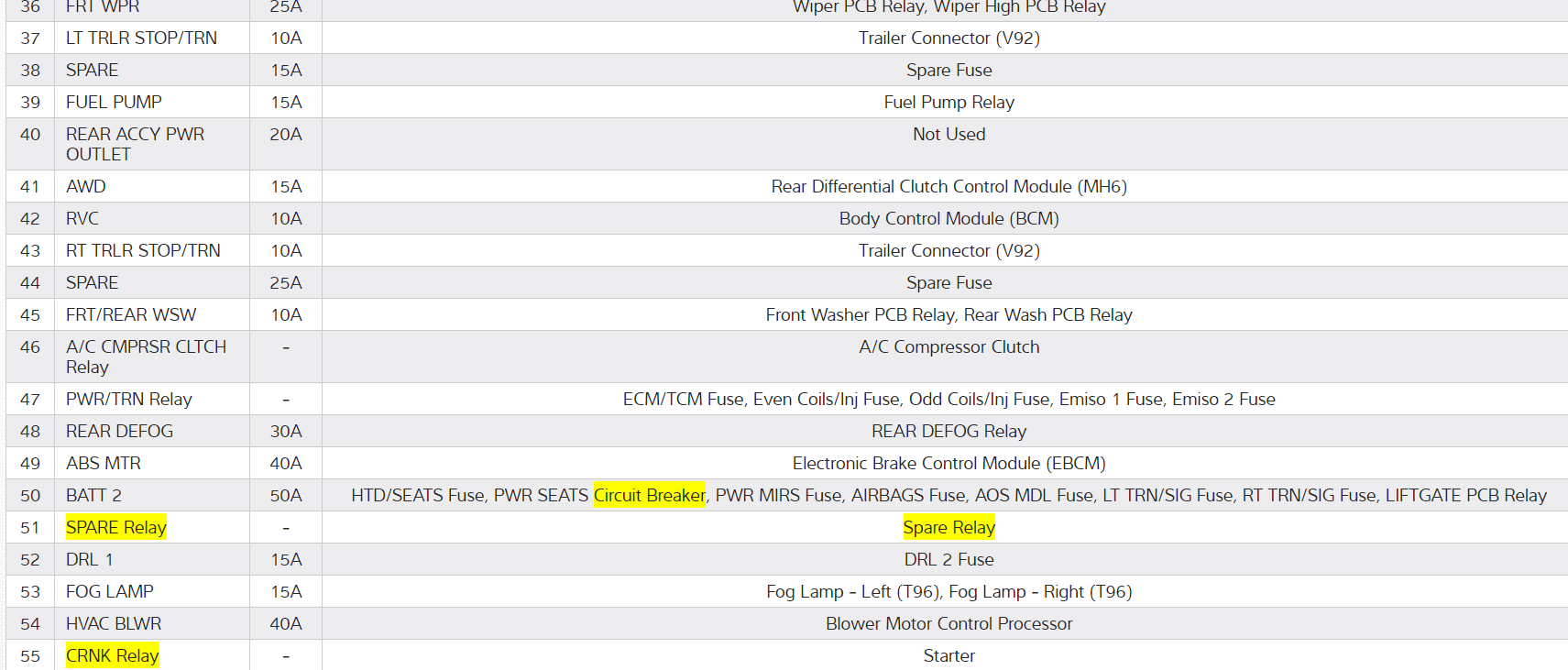

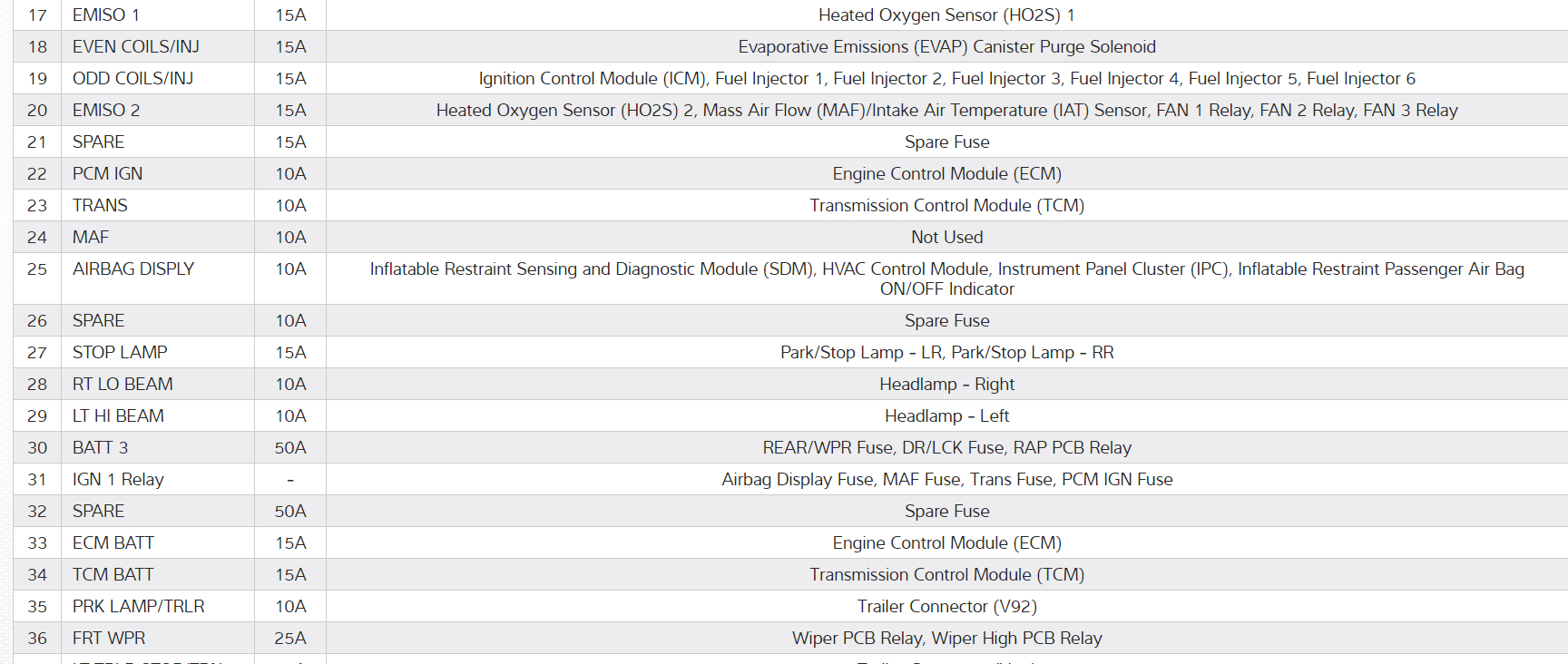

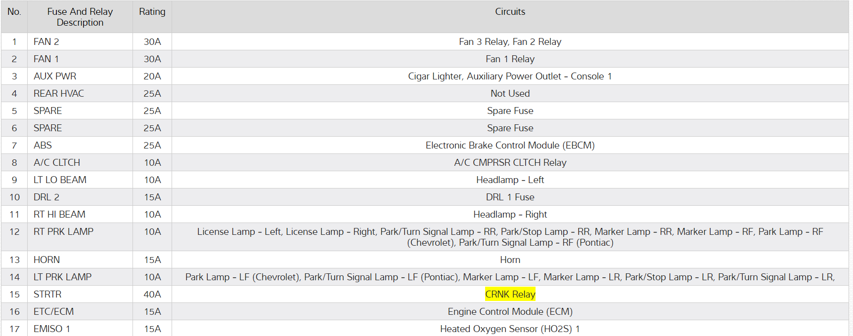

Okay, I would check for power at the fuses # 9, #11, #29 and #28. this guide can help us with the fuse location in the diagrams below:
