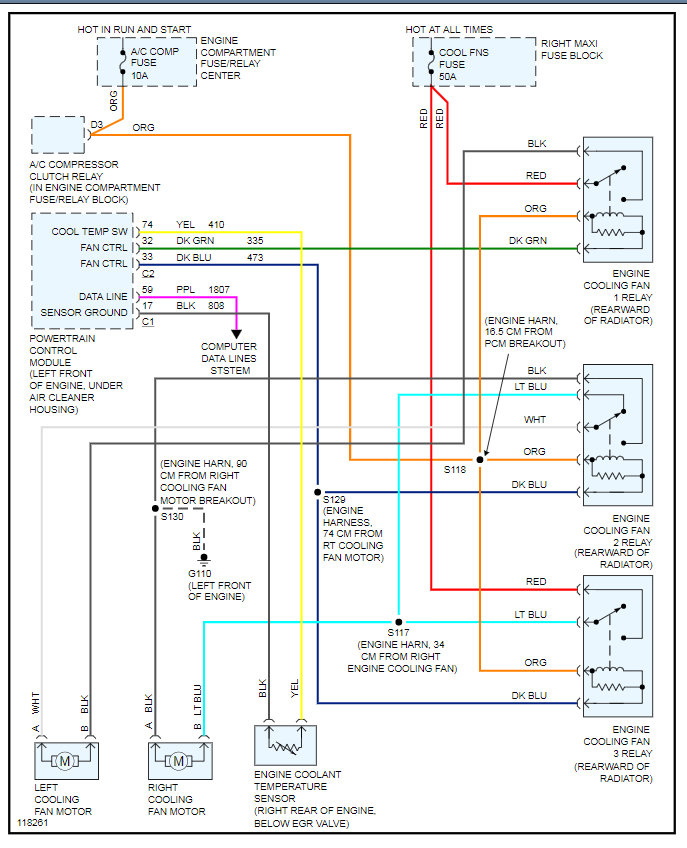

The other thing we need to check is make sure both fans turn on when the engine is warm and the A/C is on. I attached the wiring diagrams for this so we can start working through it if one or both are not coming on.
Jul 15, 2020 at 12:03 PM
RMDEMOUY
Both fans are new and working properly. They usually come on when the temperature is high 220's or as soon as I turn on the A/C.
