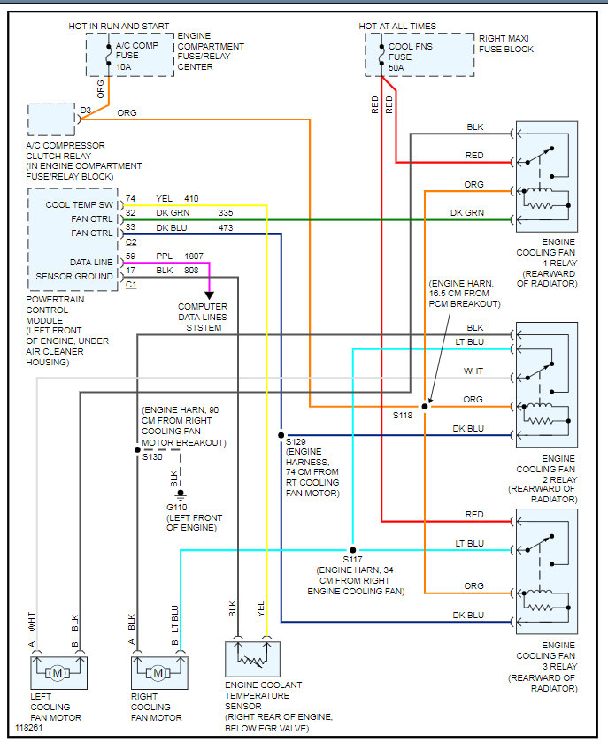

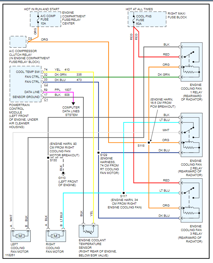

The other thing we need to check is make sure both fans turn on when the engine is warm and the A/C is on. I attached the wiring diagrams for this so we can start working through it if one or both are not coming on.

RMDEMOUY
Both fans are new and working properly. They usually come on when the temperature is high 220's or as soon as I turn on the A/C.
Jul 15, 2020 at 7:13 PM
