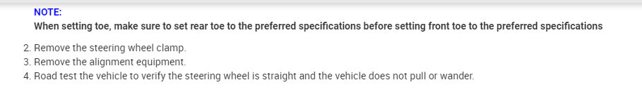

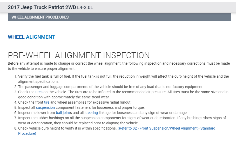

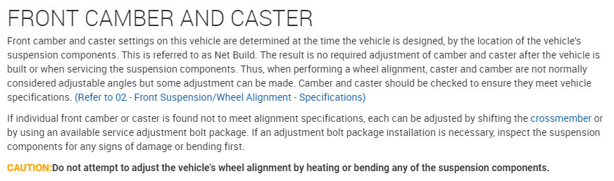

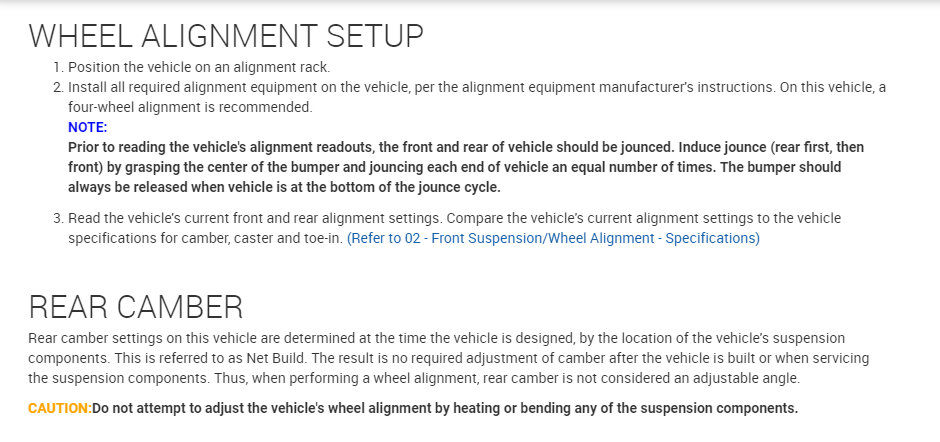

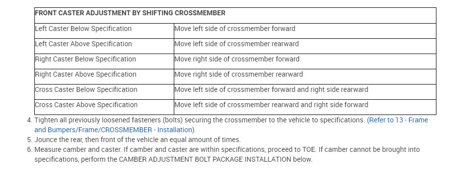

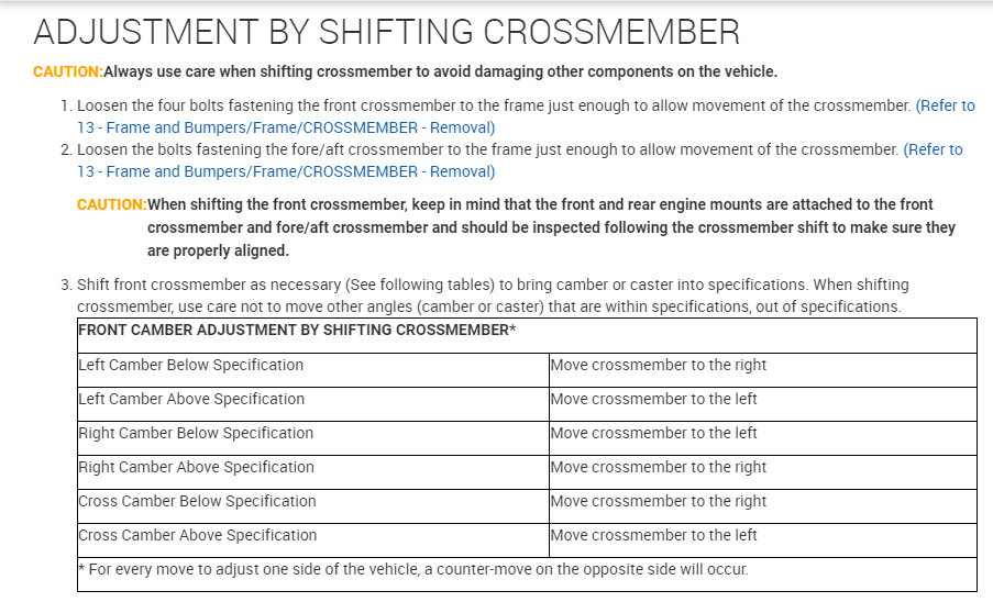

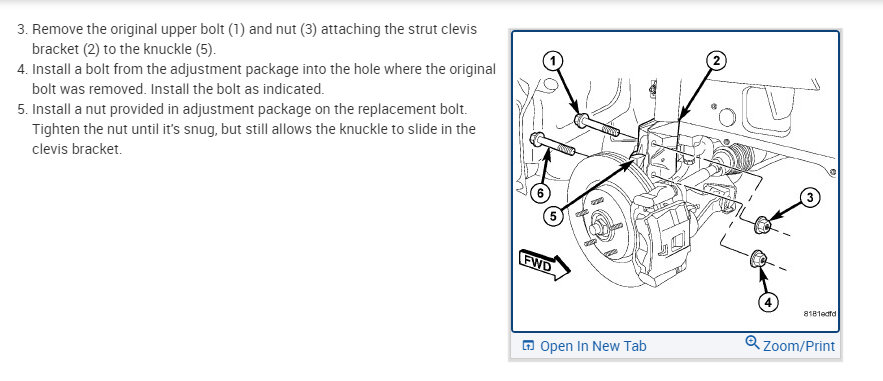

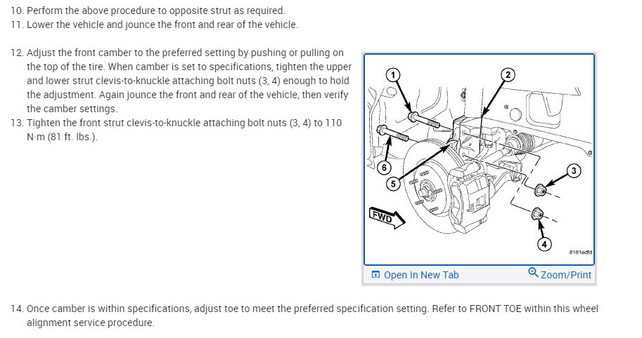

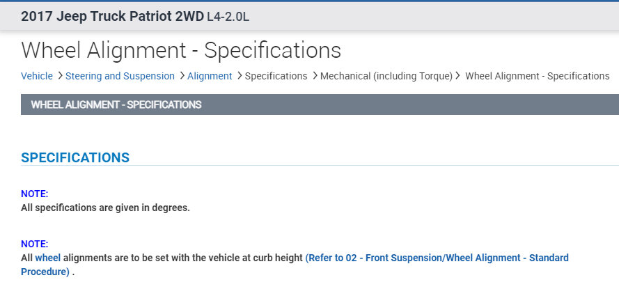

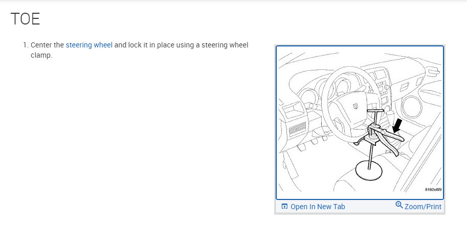

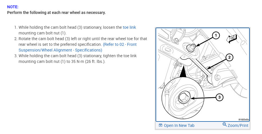

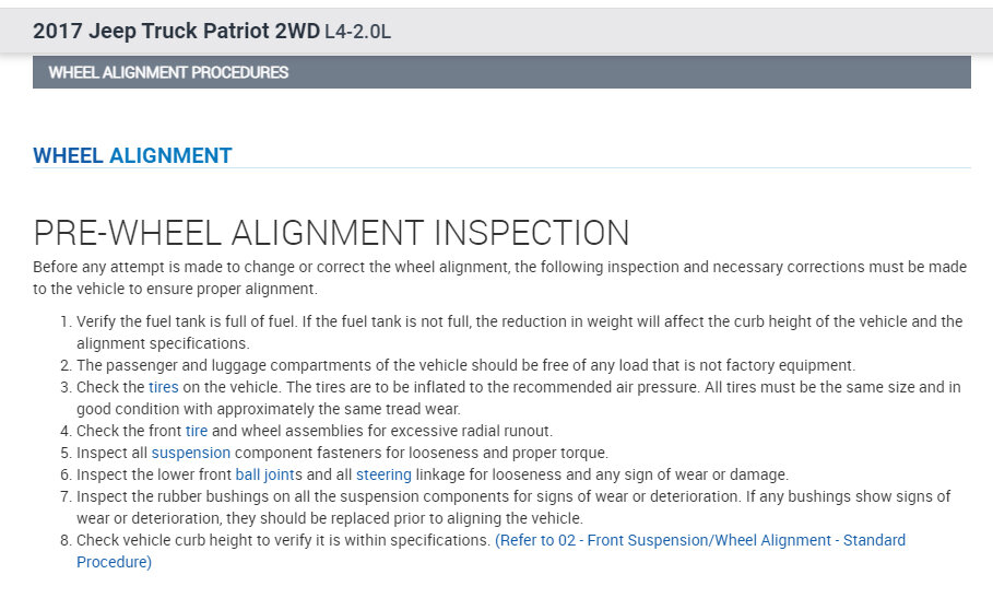

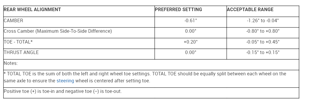

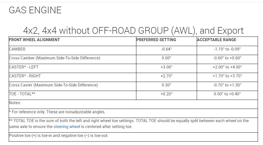

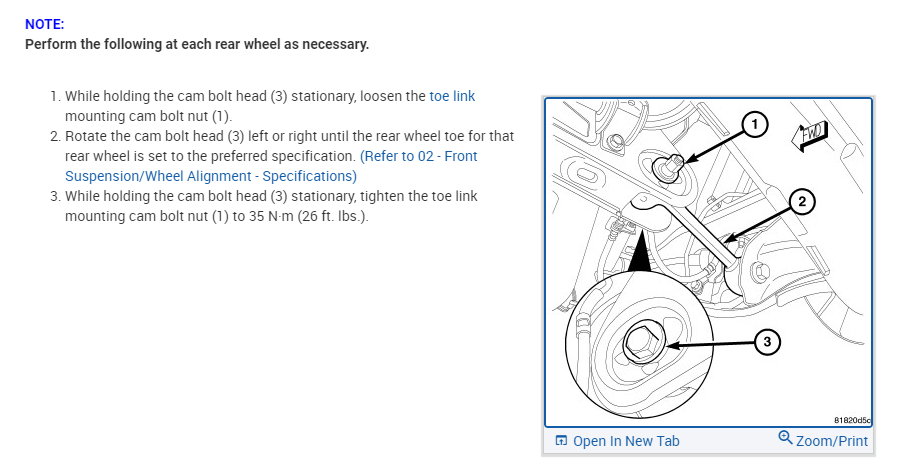

You are very welcome. I'm glad to know it was helpful. As far as the alignment is concerned, I do them on an alignment machine. I have all the specifications, but they are in degrees.

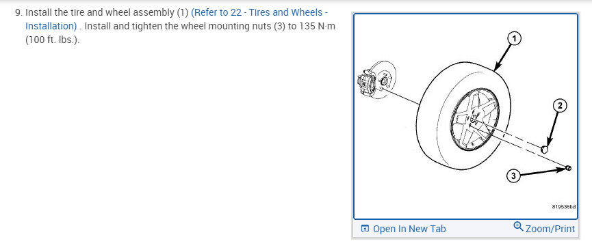

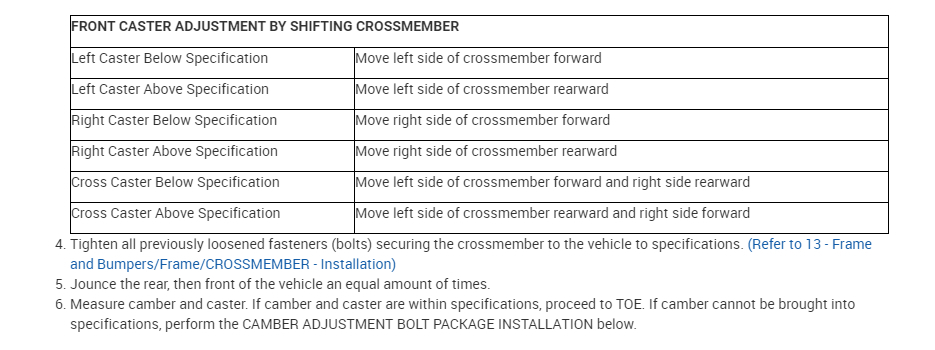

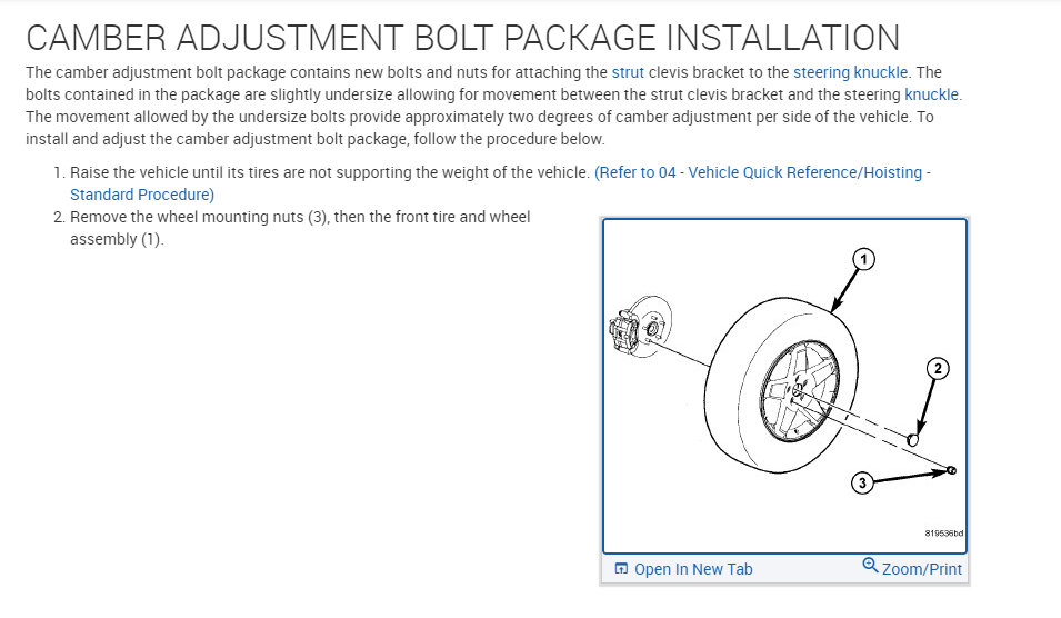

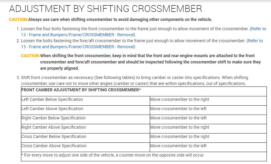

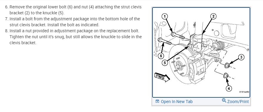

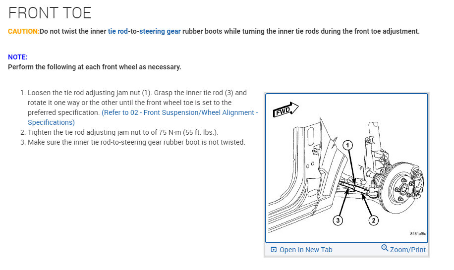

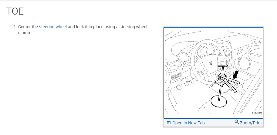

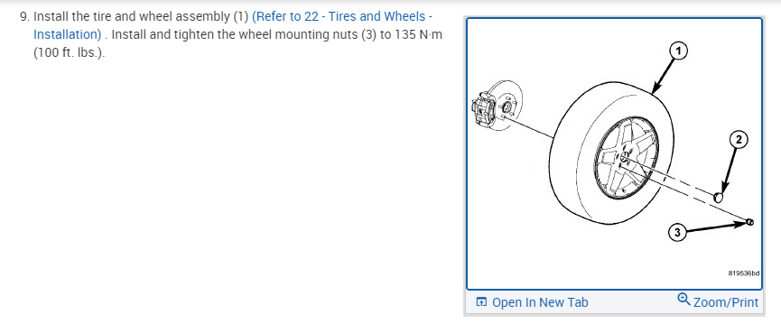

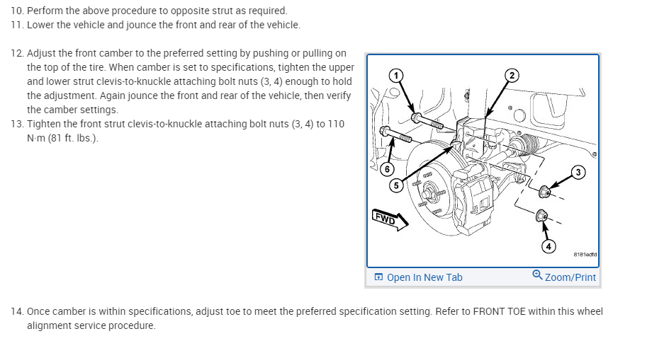

If you look at the first three pics below, they provide the specifications. The remaining pics are the directions. The directions provide adjusting caster, camber, and toe-in. The only thing you need to really worry about after the work you've done is camber. That is what is adjusted by the lower bolts on the strut assembly.
Let me know if this helps.
