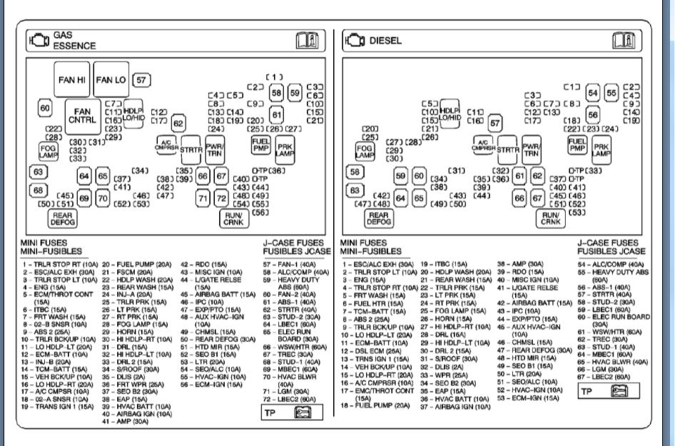

is there a fuse I should check? none of fuse indicate cruise?
May 7, 2021 at 6:59 AM

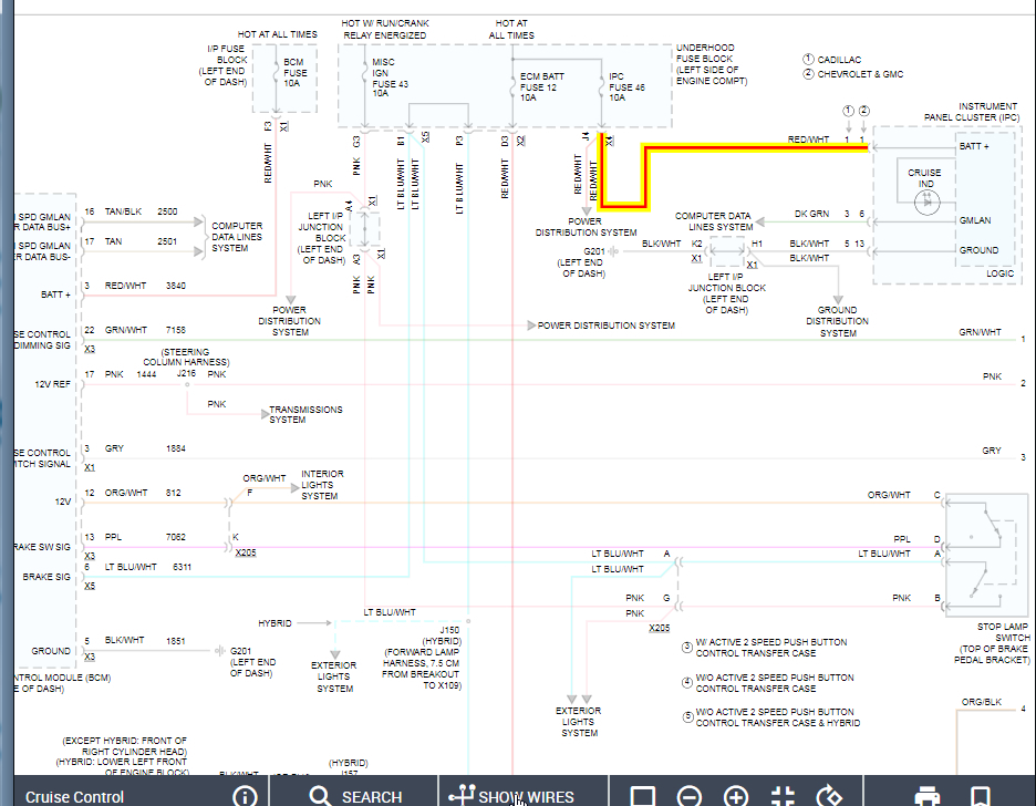

Does the cruise control operate? If it works properly then I suspect the fuse for the IP is the issue.
However, if the cruise does not work then we have another issue.
Let's start with this and I attached the fuse info below which is in the underhood fuse block.
Let us know what you find with this info and we can go from there. Thanks
