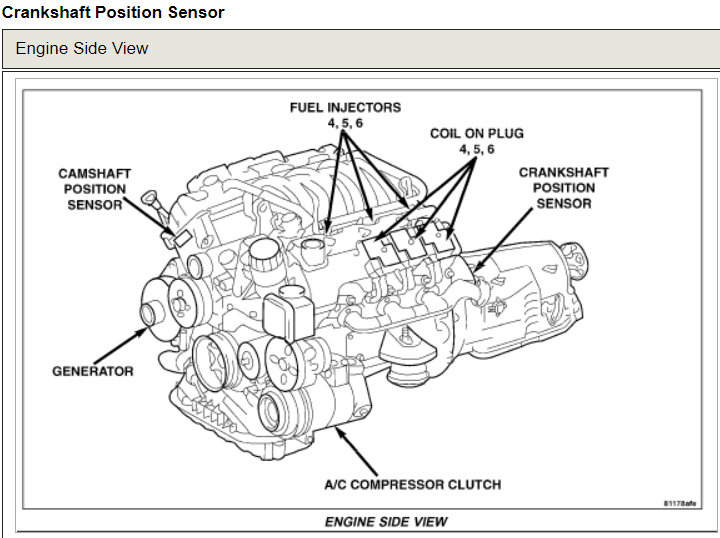

My car turns over but it wont fire. It takes a while then it starts and runs beautiful for a few days without the check engine light on then it does it again and then the check engine light comes back on. Any advice please? It's been doing it a few weeks now. Thank you.

This sounds like you have a crankshaft angle sensor that is going out. Here is a guide to help you see what you are in for when doing the job and diagrams to show you what it will be like on your car.
