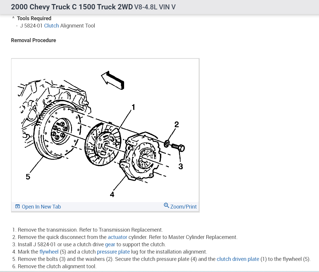

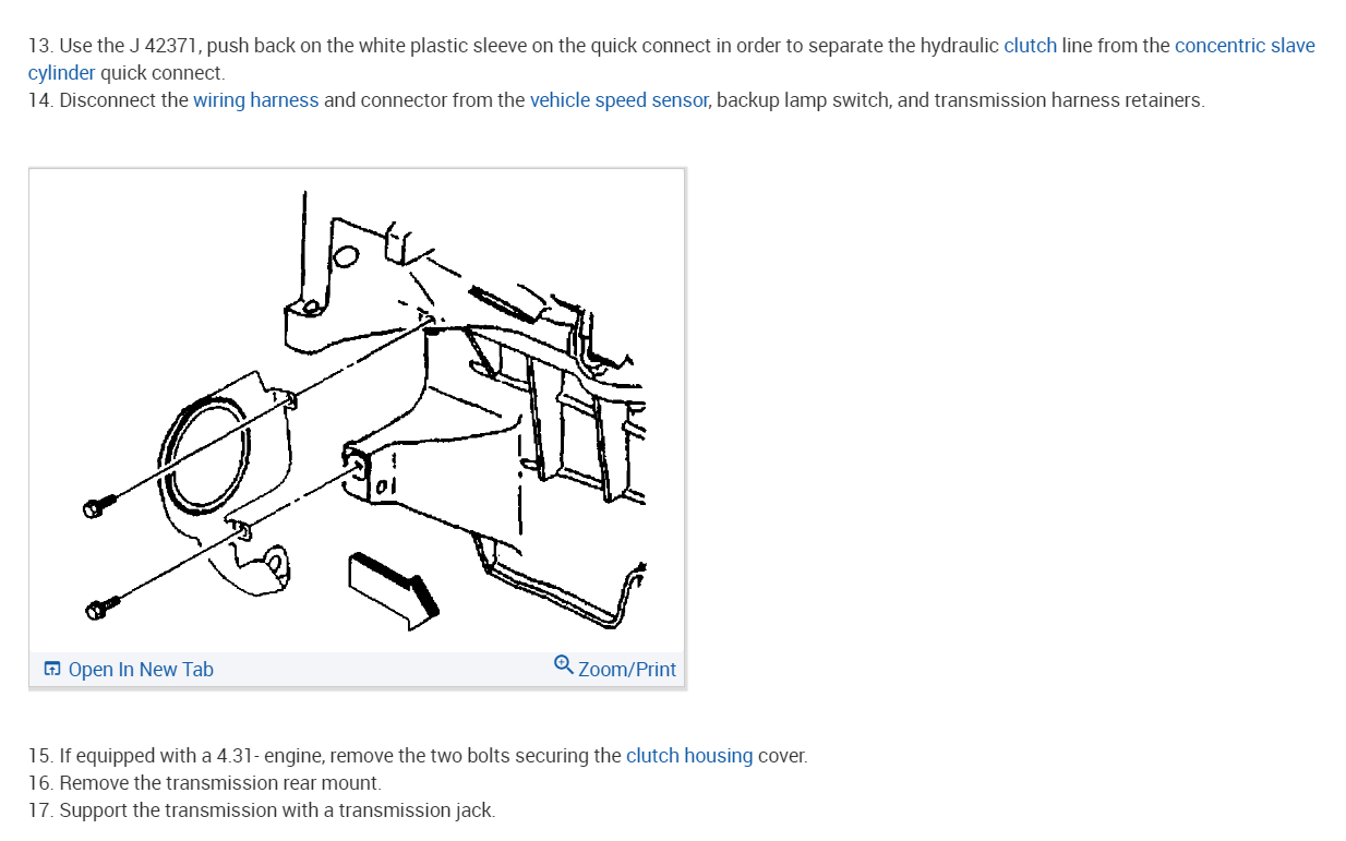

Clutch slips when accelerating?
2000 CHEVROLET SILVERADO
140,000 MILES • 4.8L • V8 • 4WD • MANUAL
DICEGOD13
Feb 2, 2023 at 2:59 PM
  • 54,837 POSTS

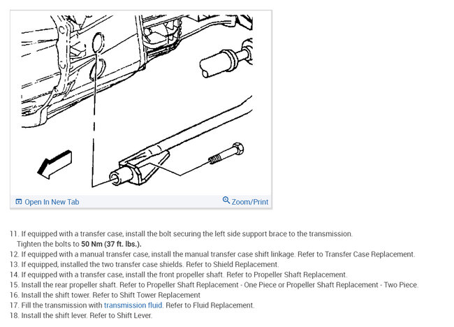

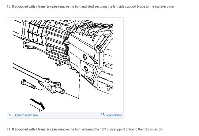

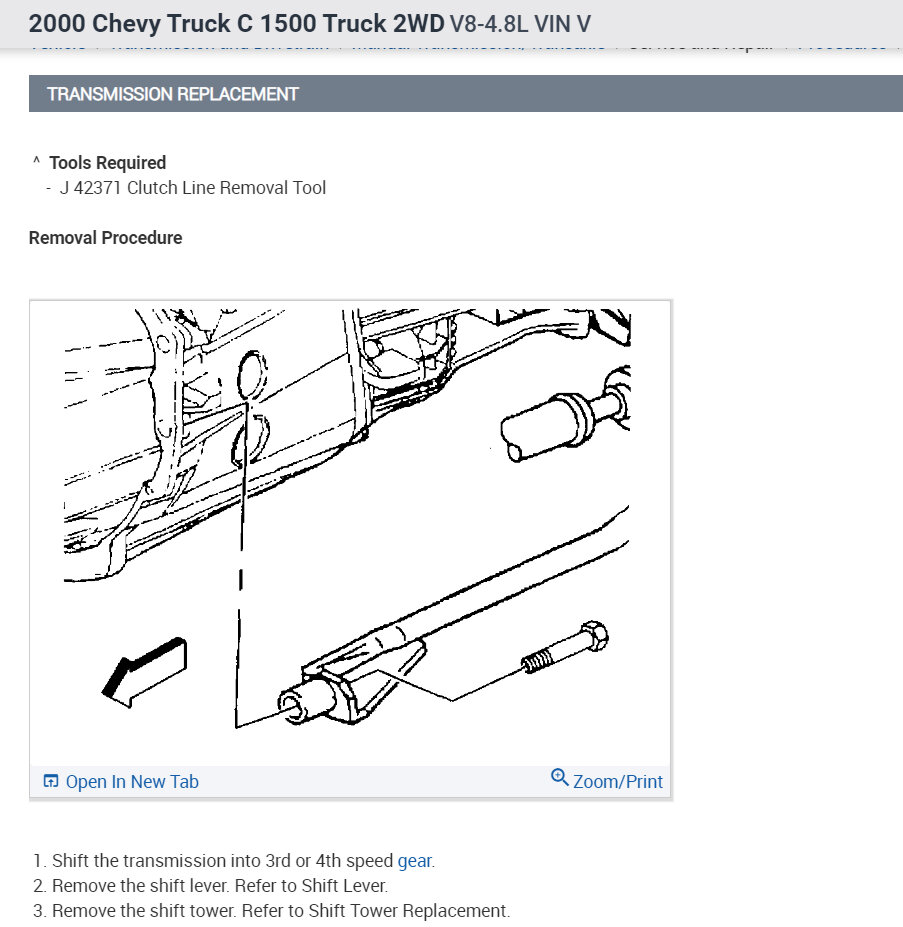

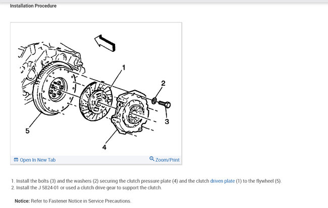

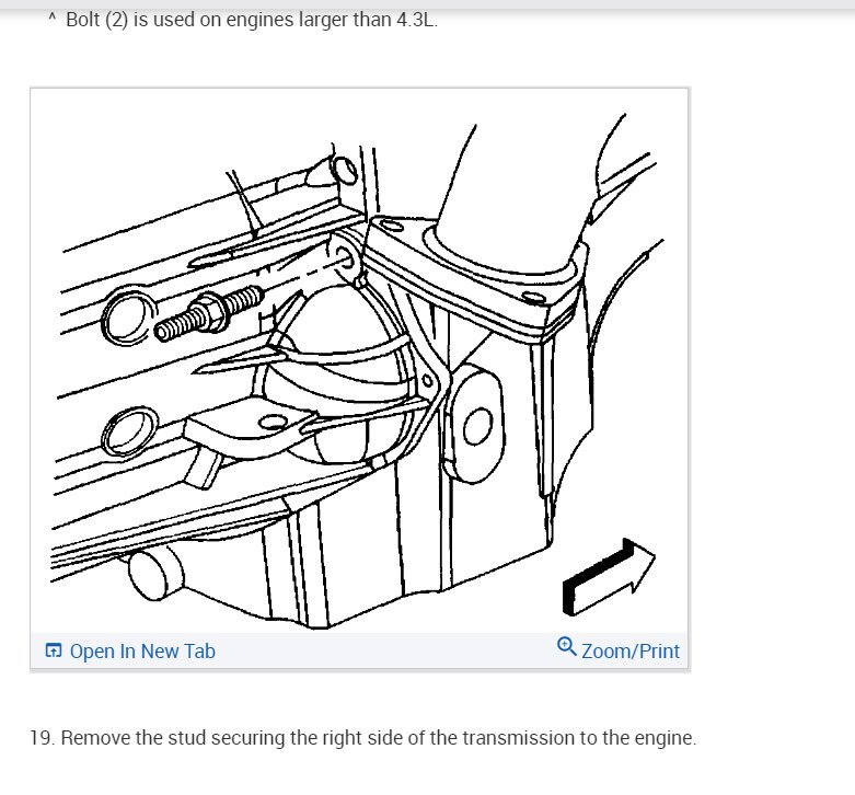

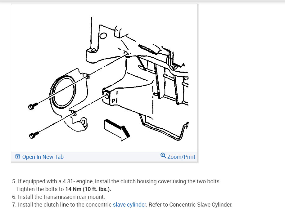

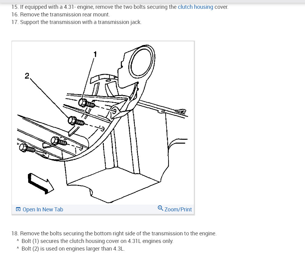

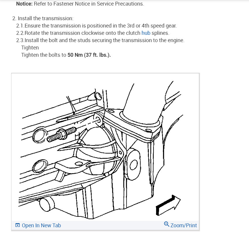

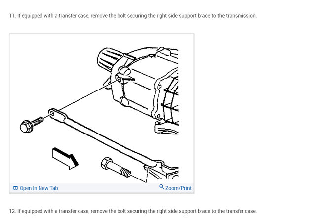

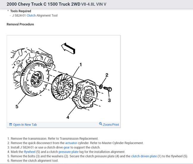

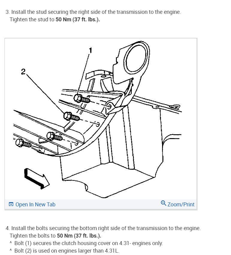

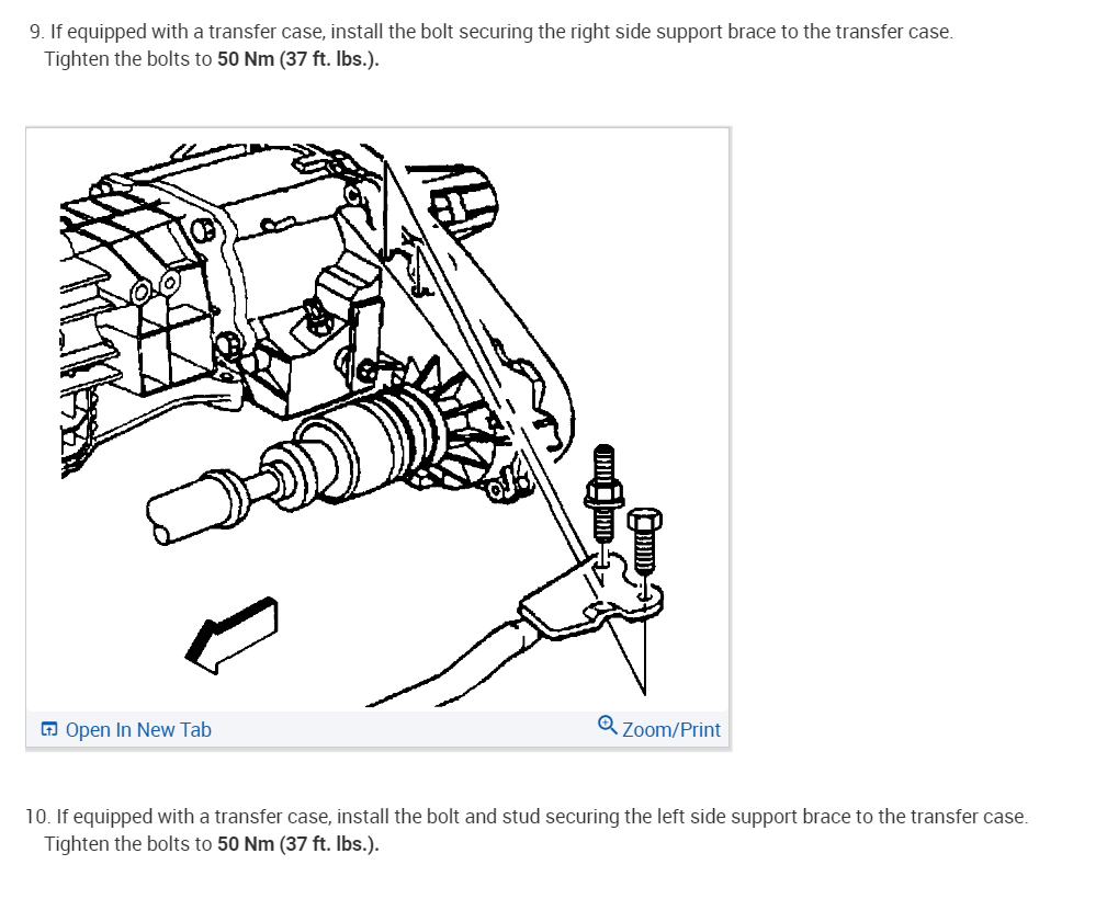

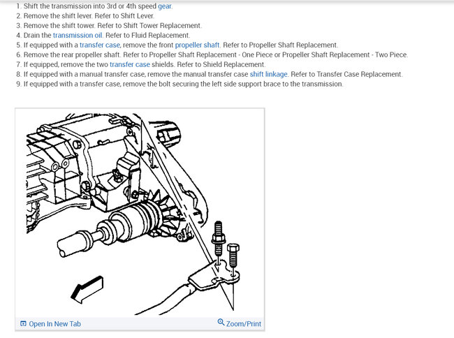

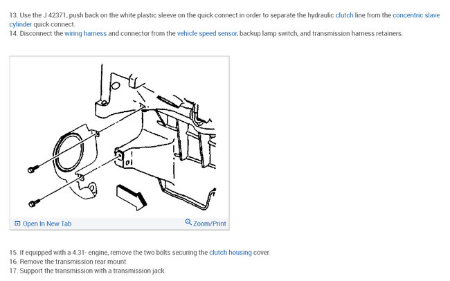

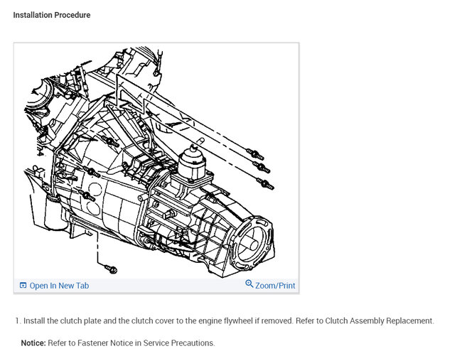

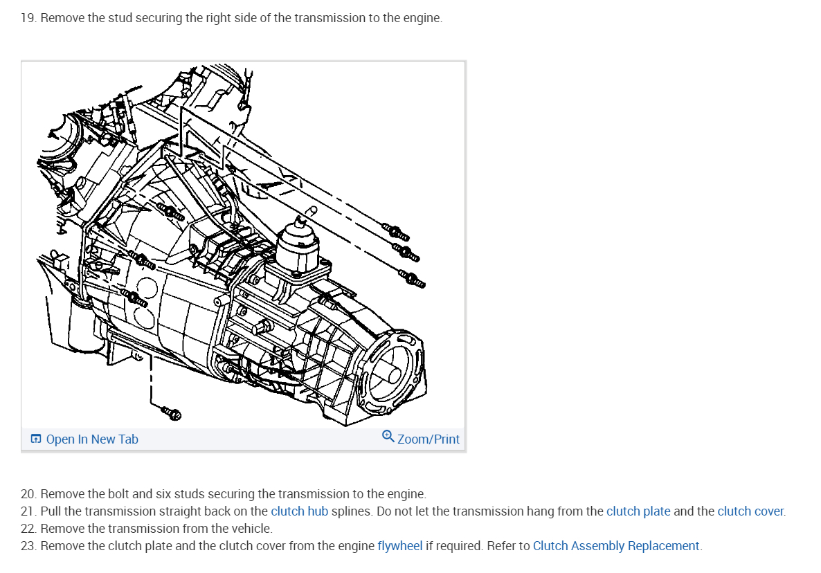

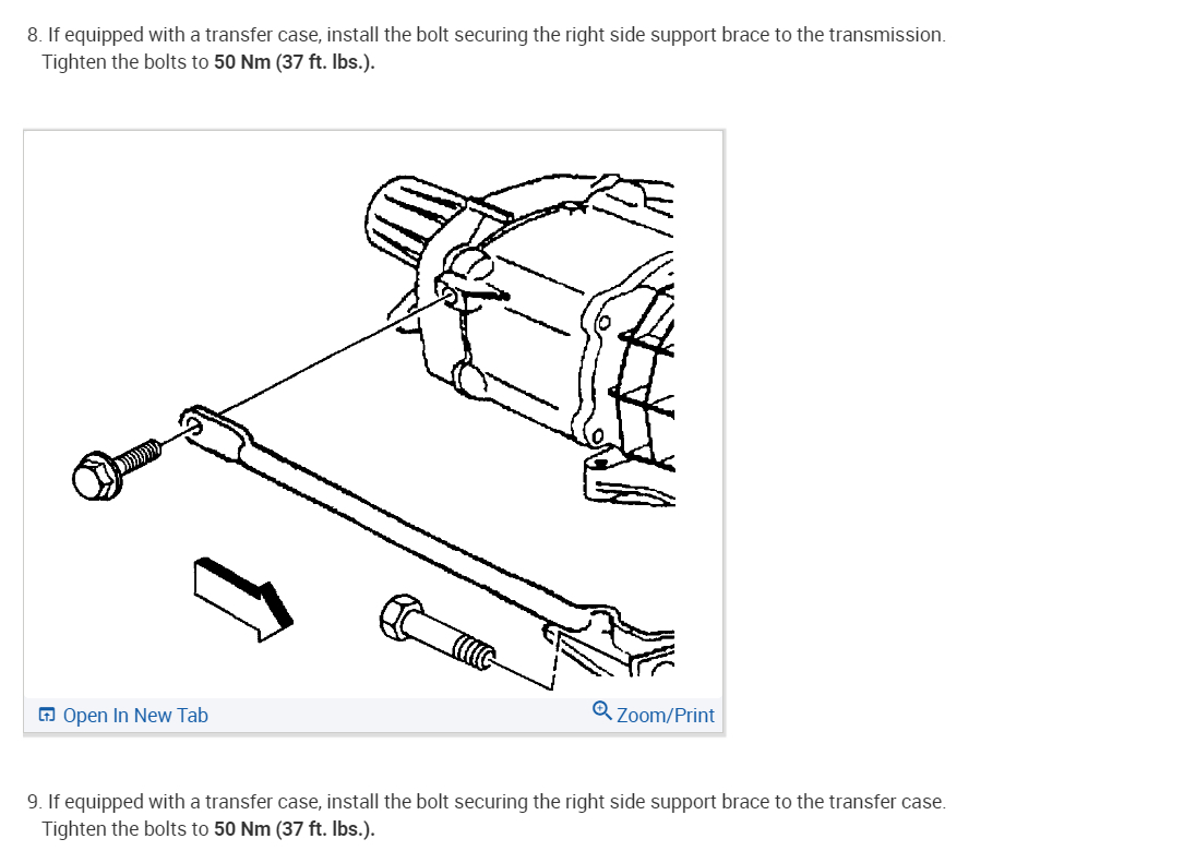

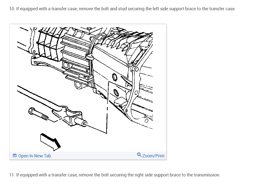

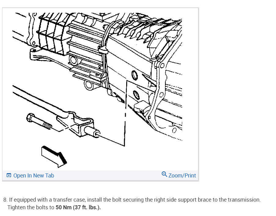

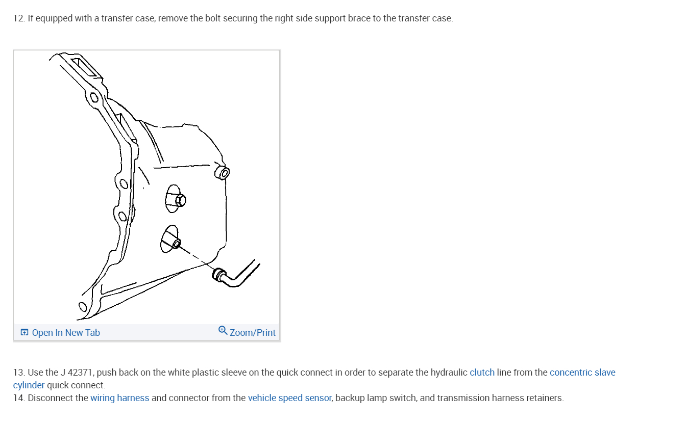

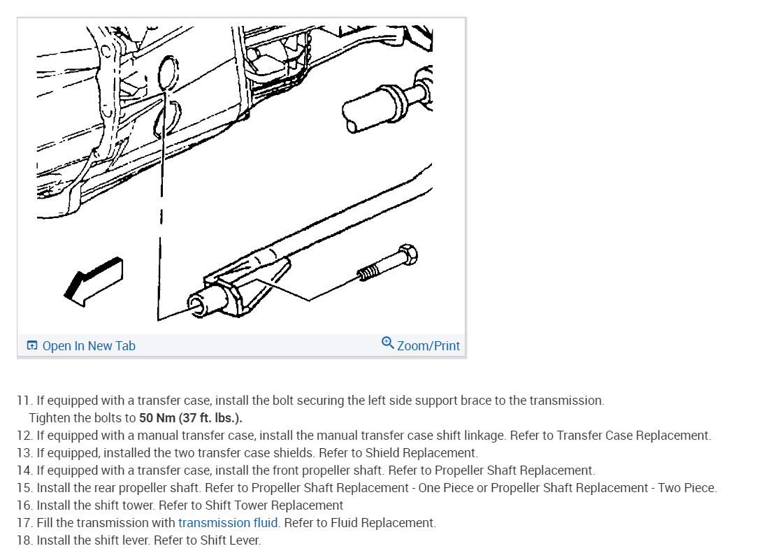

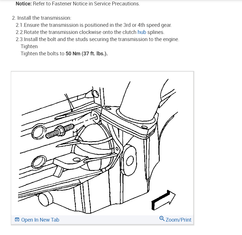

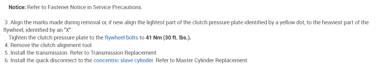

Yep, it happens when the clutch needs to be replaced, here is a video of the job being done on a car, but the process is very similar, and I have included instructions for your truck in the images below.
https://youtu.be/JpzefqEeVGE
Please watch the video, it has a lot of good information about doing the job. Check out the images (below). Please let us know what happens.
