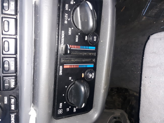

I was wondering if I could bypass the climate control.

Well, my wife was pushing the control up because it was blowing cold air and when she did it started blowing hot air but then the lever popped out .

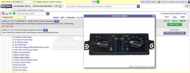

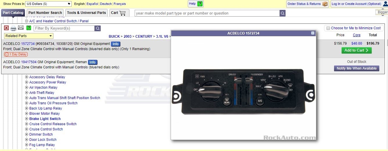

Okay, I found the control on rock auto. I attached it below for you.

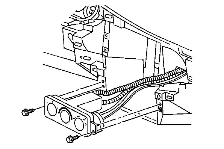

You will have to replace the control head. It is not that difficult to replace.

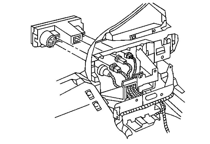

REMOVAL PROCEDURE
1. Remove the front floor console.
2. Remove the retaining screws from the HVAC control assembly.
3. Pull the HVAC control assembly out from the I/P.
4. Disconnect the electrical connectors and the vacuum harness from the HVAC control assembly.
5. Remove the HVAC control assembly.
INSTALLATION PROCEDURE
Jan 3, 2020 at 11:12 PM
RAYMOND ADKISON
The vacuum harness is on the right side of the panel correct? does that need to recharge or will it create it own vacuum again?
Jan 3, 2020 at 11:24 PM
The vacuum is produced by the engine. No need to do anything but plug and play.
