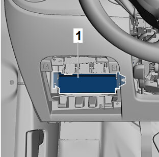

My cigarette lighter fuse is not working, how do I repair? And if so, what fuse needs to be replaced ?

The cigarette lighter when I put a charger inside doesn’t turn on. Nothing online shows how to repair and replace the fuse or cigarette lighter itself. I’m low on funds and need a guide on what fuse needs to be fixed. Please! It’s urgent.

I got you covered, please check the fuse #30 - 20 amp in the fuse panel in the left end of the dash. The ground G44 for the cigarette lighter is at the left bottom of the kick panel. Here is a guide to help you check the fuse:
Here is the fuse box location. Check out the images (below). Please let us know what happens.
