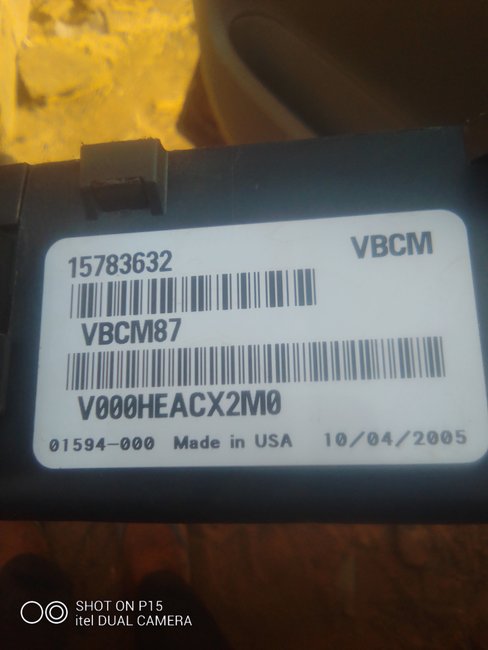

The BCM of my vehicle listed above got burnt. Purchased a new one and replaced it. All other electrical works perfectly but starting disable display on the dashboard.
What do I do to correct it?

When you replace the BCM, it needs set up or programmed for your vehicle. Was this done? If it was, try the procedure listed in pic 1 below and let me know the results.
If you have already tried this, let me know. We may need to get a scanner that can communicate with the BCM.
See pic below.

Thank you for your response. I've tried the programming, but it doesn't accept programming. I don't know what to do again.
Jan 26, 2022 at 12:09 AM

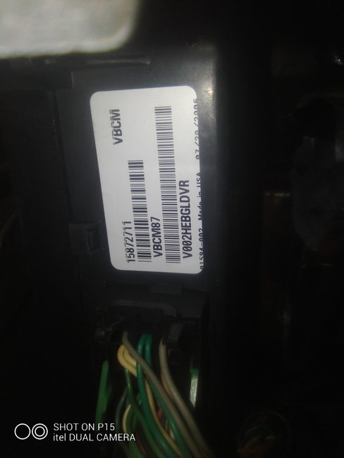

SAHIDAMIN
I've also tried the steps shown in picture sent to me, also not work. The first picture below is the New BCM bought, while the second is the damaged one. Thank you
Jan 26, 2022 at 1:56 AM
  • 110,248 POSTS
They have two different part numbers. Were you told they are interchangeable?
