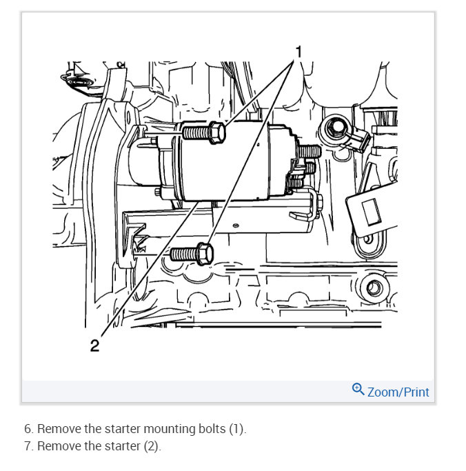

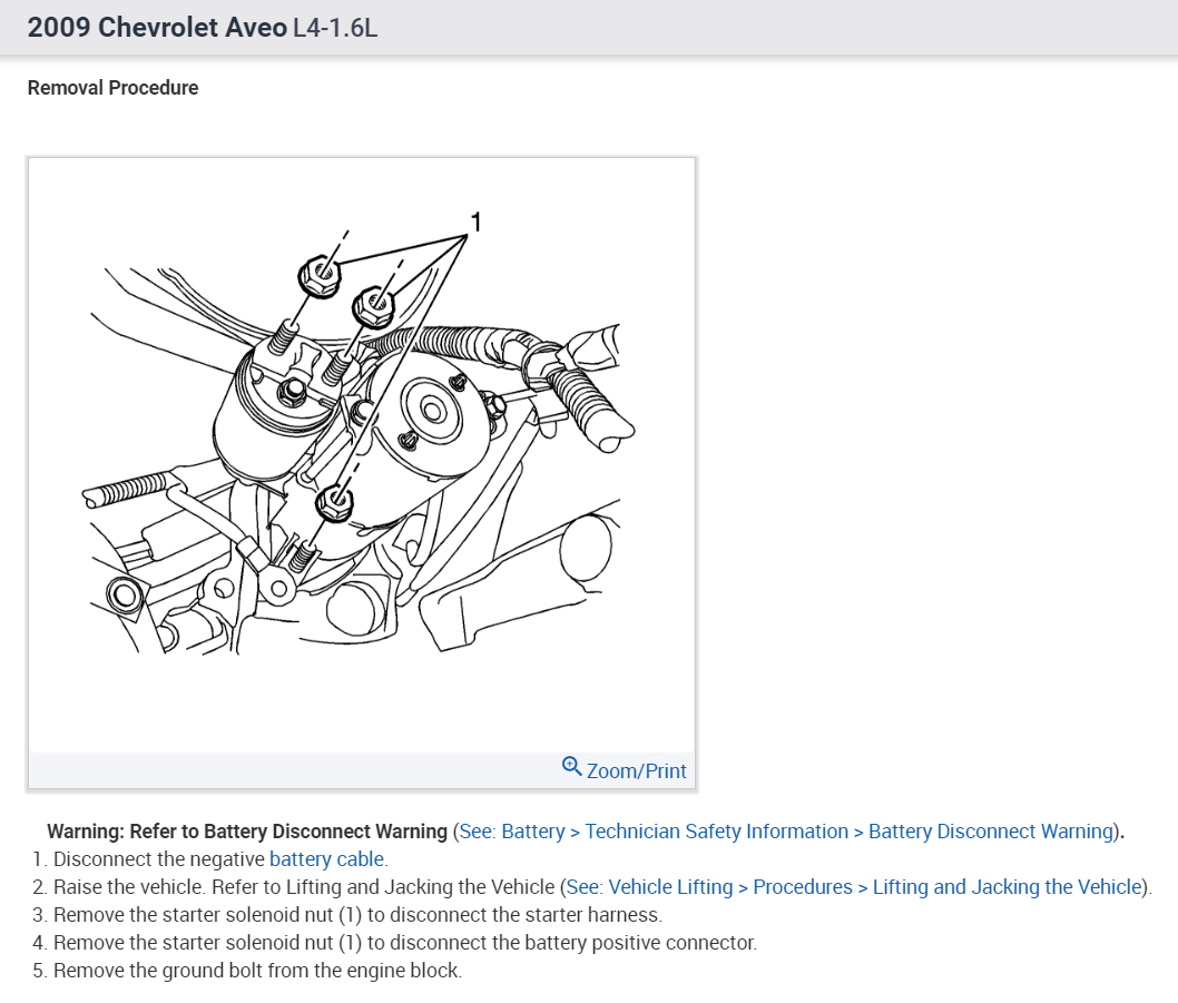

It sounds like you may have two problems here lets handle the non cranking issue you can start a new question for the AC issue. Can I ask if the car was over heating? When the car will not crank over lets use a test light on the starter trigger wire. This will tell us if the starter is getting a signal and if so the starter is bad and needed to be replaced. Here are two guides to help us get started:
and
Please run down these guides and diagrams (below) and report back.

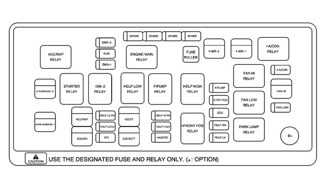

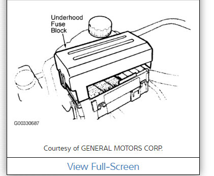

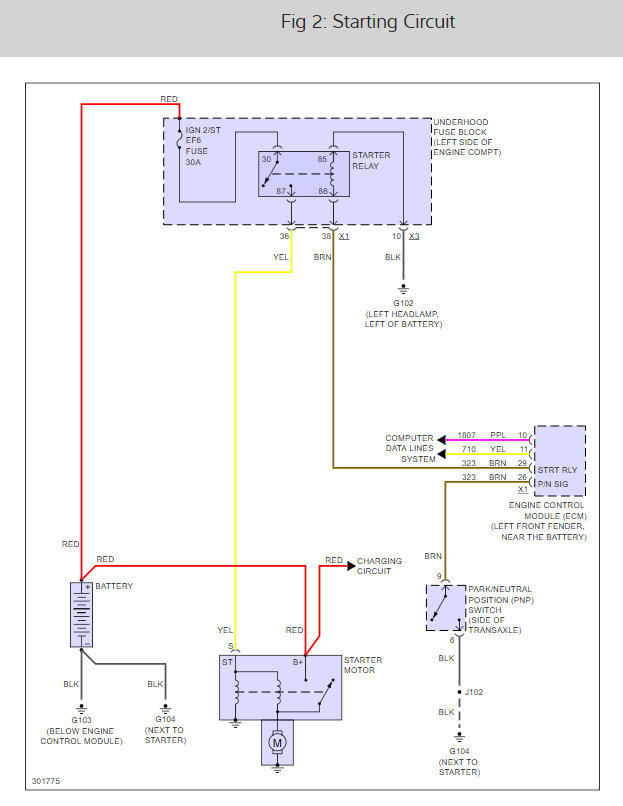

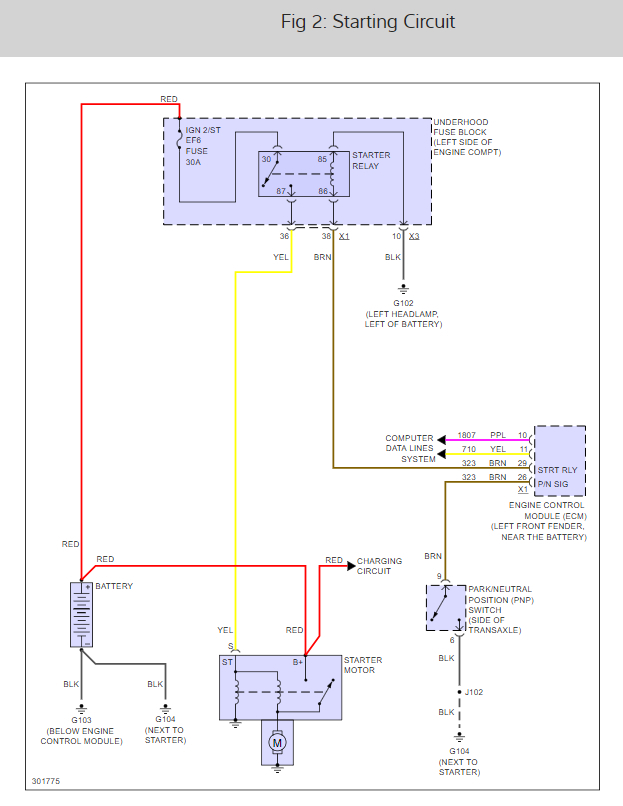

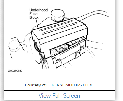

Okay, there is a starter relay we need to check. Here is a guide and the starter wiring diagrams so we can see how the system works and the location of the starter relay below:
