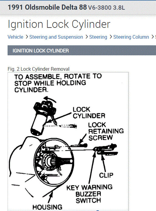

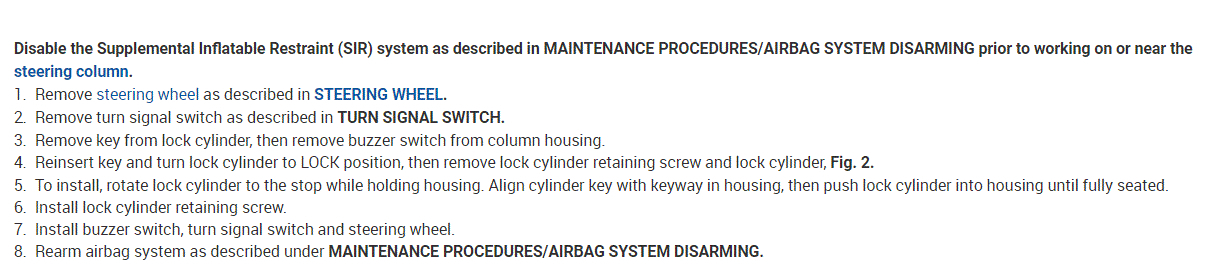

Let me know if that helps. If it doesn't we may need to replace the lock assembly. I attached the directions below in the event you want to do it.
