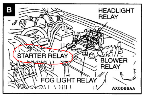

I’ve changed my fuel pump, and it still won’t start My mechanic told me that the only other problem he found was my ECM was bad I got that repaired at G7 computers! And it still didn’t work, when I went to crank it up it was doing the same thing not turning over one of my relays was hotter than the other I noticed when I was trying to start. how do I test my relays ? And do you think that would be the problem even after I was told they interchanged them to see if they was good? And was told they were.

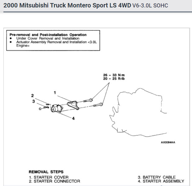

Just a quick question first. When trying to start does the starter motor engage and spin the engine over and crank or does the engine not spin over and do nothing? If it is not spinning over I think you have a starter motor issue. Here are a few no start tutorials and how to test a relay:
I've attached a picture of the starter motor relay location and how to change the starter motor. Let us know what you find and we'll go from there. Hope this helps and thanks for using 2CarPros.
