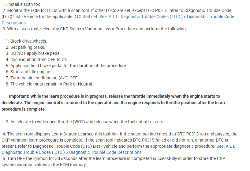

My car stopped working while drive. And I change the fuel pump, still not starting but it will rotate but the engine does not start.
Thanks

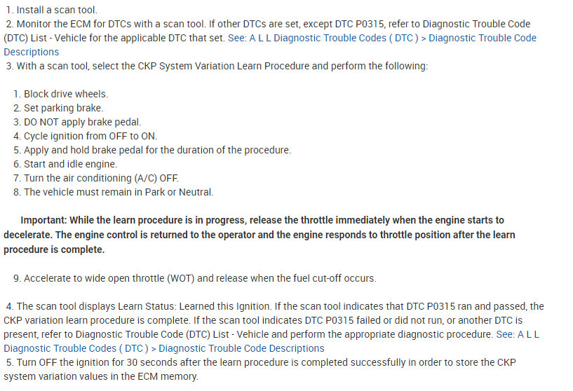

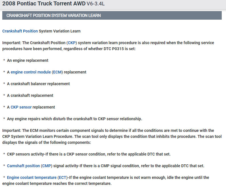

It sounds like you could have a faulty crank position sensor.
When a crank sensor fails the engine will stall, regardless of if you are driving or stationary.
Over time the heat and vibration from the engine can make the crank sensor lose its calibration and it will send error codes to the ECM and the engine will be shut down.
Here are some helpful articles on crank sensor:
https://www.2carpros.com/articles/how-a-crank-shaft-angle-sensor-works
Sometimes a bad crank sensor will trigger the check engine light.
Is your check engine light illuminated?

The crank sensor Is sock when testing it with electrician and the car does not start despite testing some sensor even some cable have been change in order to let the car start fully.
Oct 7, 2021 at 5:21 PM
SQM
  • 6,383 POSTS
Can you tell me what you have replaced so far?
That way we have better understanding of the issue.
