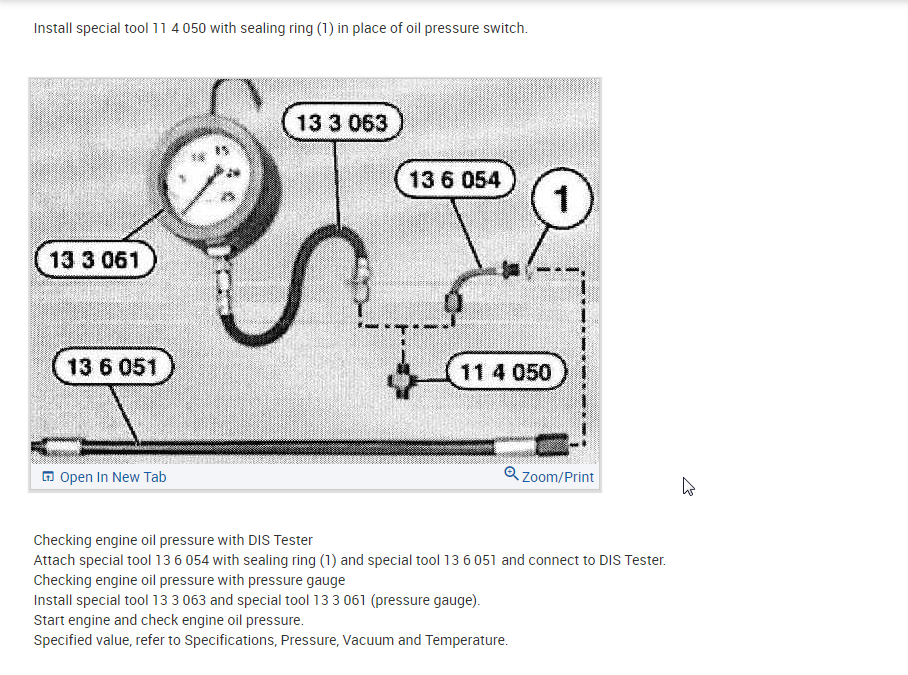

Hi, my car shuts off when i brake or slow down without any warning. It runs and starts smoothly. Mileage on the car is 82,000. Sometimes there is a smell of burning oil and recently the low oil warning lights has come on. Servicing and oil change done in December 2012.

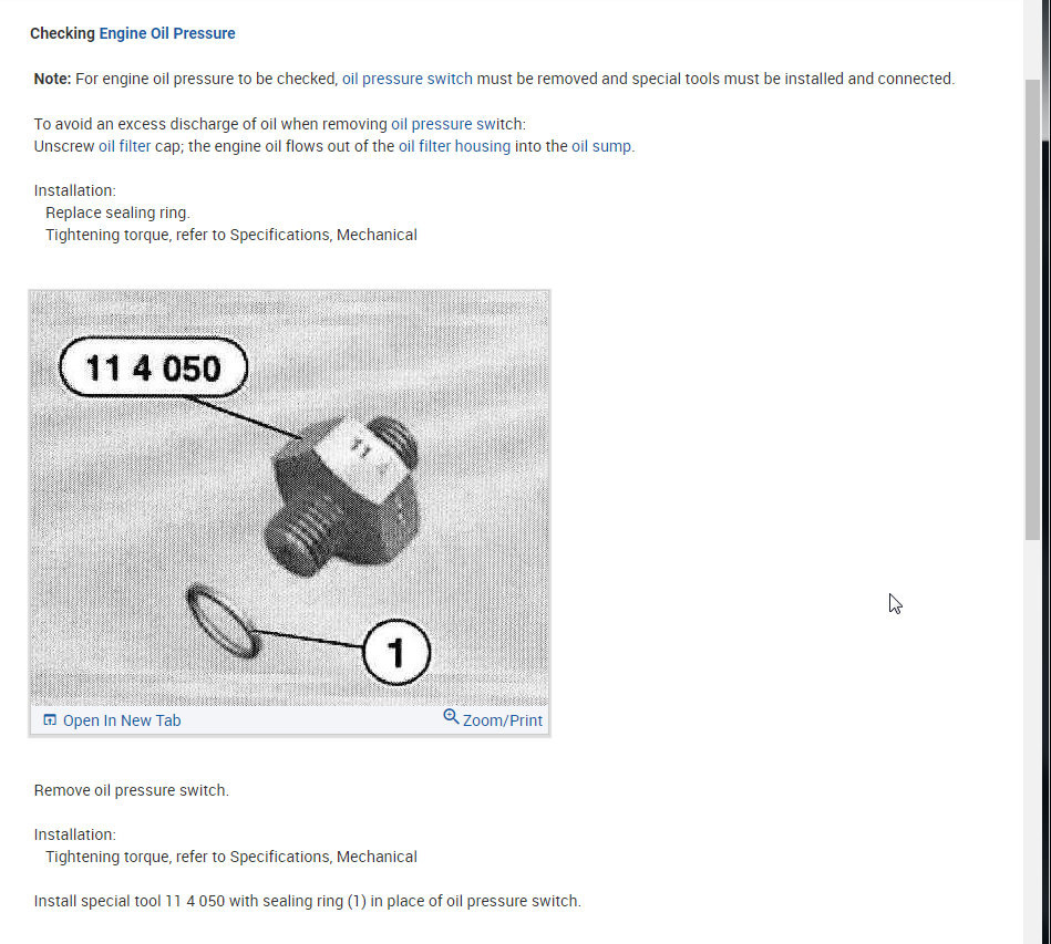

If the oil level is okay then we need to check the pressure. Again, it could be shutting down due to this so we need to make sure it is ok due to the light coming on.
I attached the process below on how to check the pressure. Let's run through this and we can go from there. Thanks
