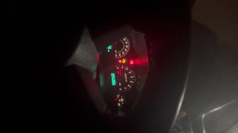

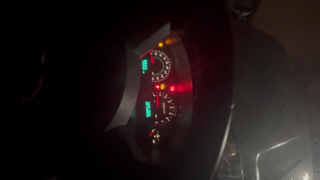

I also have a video to show the RPMs and what the truck does.
Dec 31, 2022 at 1:05 PM
ALEX ZAVALA
  • 8 POSTS
It has a rough idle in park but in reverse it shuts off after a second or two.

Thanks for the video, it helps but I cannot read the code sheet. Can you please take a clearer picture and upload it for me? It sounds like you may have an IPM going out. Please check for vacuum leaks and service the throttle bore. Let me know.

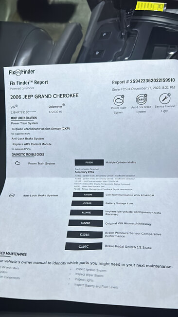

ALEX ZAVALA
  • 8 POSTS
Photo isn’t really clearing up I can just right the codes.
P0300 multiple cylinder misfire
Random misfire detected
SECONDARY DTCs
P2302-ignition coil 1 secondary circuit
P2305-ignition coil 2 secondary circuit
U0100-lost communication with ECM/PCM
U1402-implausible engine temperature signal received
P0732-gear ratio error in 2nd
P2638-torque management feedback signal performance
C2100 battery voltage low
U140E implausible vehicle configuration data received
C2202 original vin mismatch/missing
C121E brake pressure sensor comparative performance
C107C brake pedal switch 1/2 stuck
Jan 2, 2023 at 9:03 AM

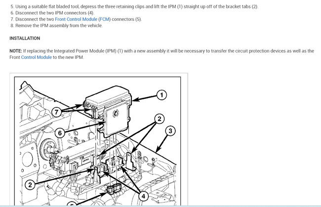

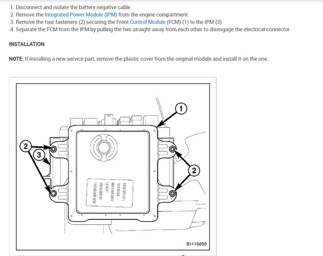

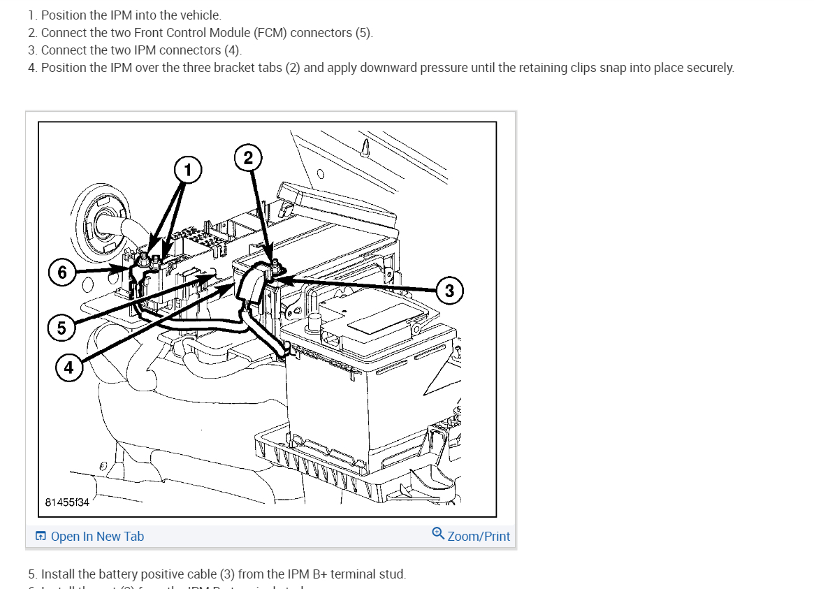

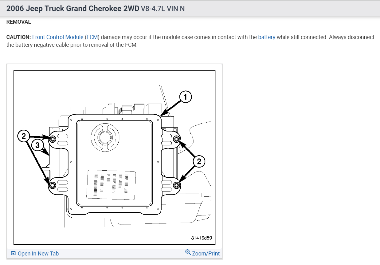

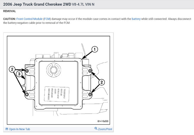

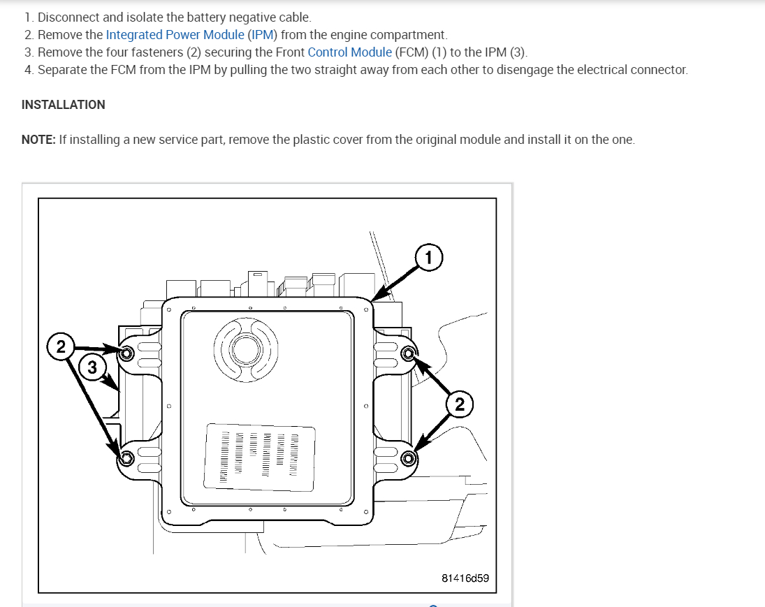

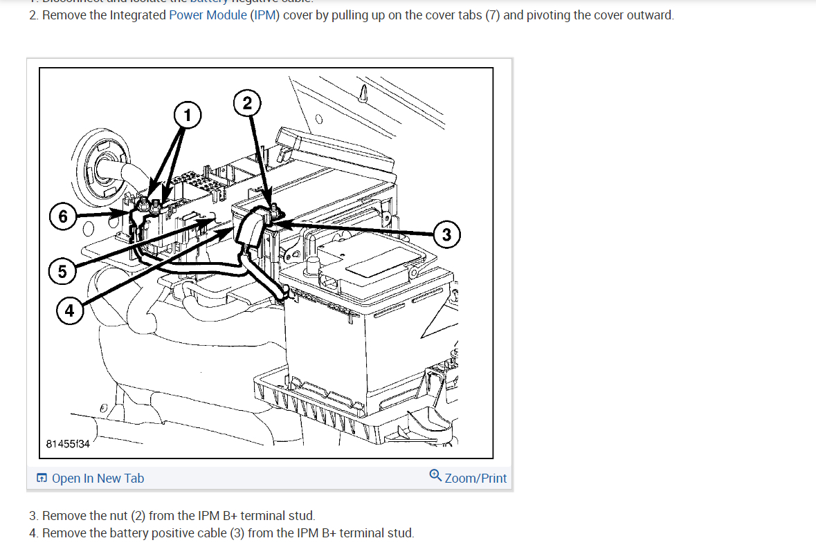

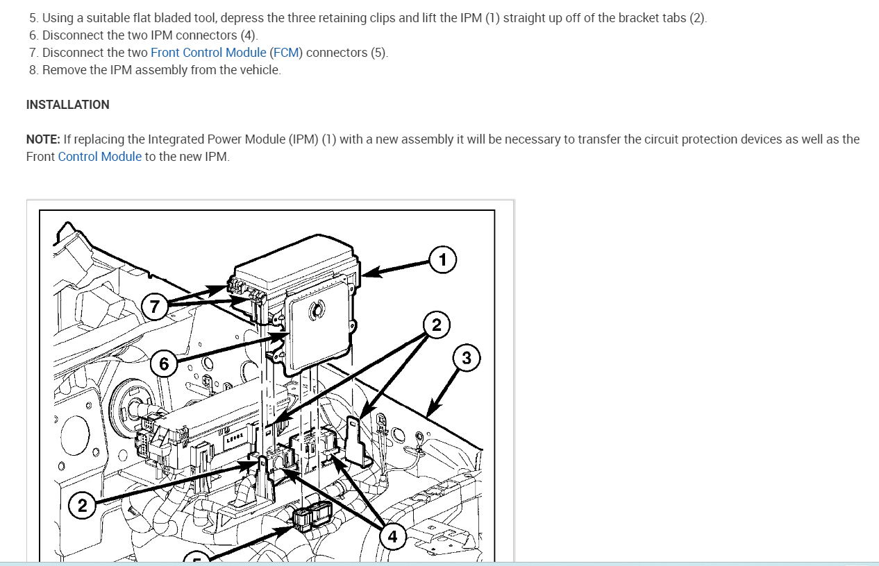

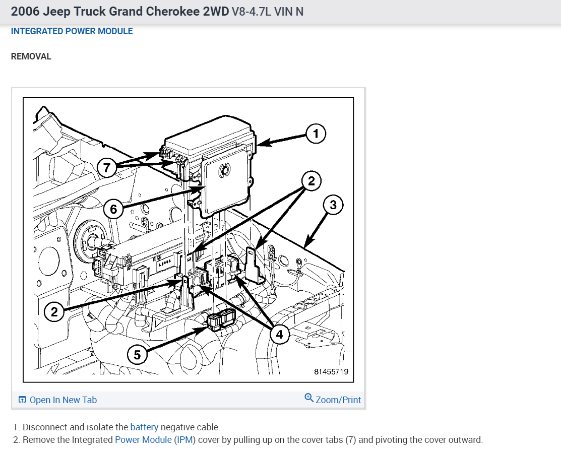

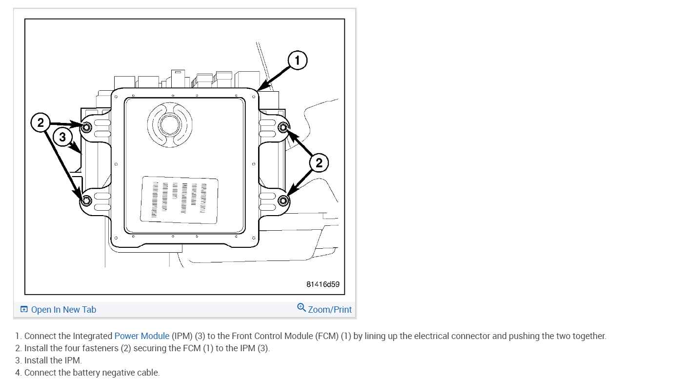

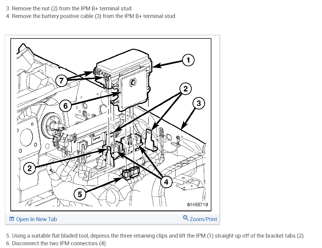

Wow, that is a bunch of codes alright. I am starting to think the IPM, or front control module is the problem. I would replace the IPM first because this is a well-known problem with these cars. Here is the location and replacement instructions for both in the images below. Please let us know what you find.

Hey ken,
I’m back. I’m finally getting time again to work on the truck. So, my question is that is they’re anyways I can test if the IPM or front control module is working or is it only a matter of buying a new one and finding out?
Another thing I try to look it up at a parts store like AutoZone but they don’t seem to have it for my specific truck
2006 Jeep grand Cherokee srt8.
It’s the 6.1L v8.
Jan 3, 2023 at 4:33 PM
  • 55,224 POSTS
Yes, they are difficult to test on your own, a rebuilder has the equipment to do so.
