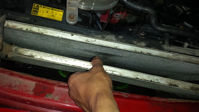

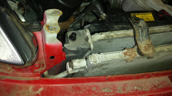

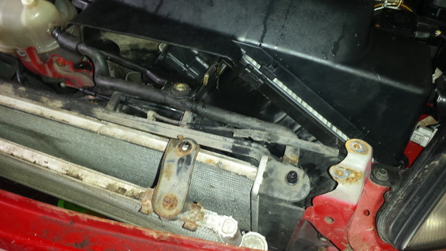

Hello, I started taking apart the radiator. What strikes me is that it looks like there are two pieces of radiator that are currently installed in the car. Is this normal to have to piece of radiator for this type of car?
May 23, 2018 at 6:14 AM
PATENTED_REPAIR_PRO
  • 1,853 POSTS
The one toward the front is the air conditioner condenser.
May 23, 2018 at 7:35 AM
