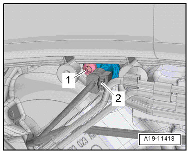

If you are getting exhaust gasses in the coolant, it sounds like a bad head gasket. I will provide the directions. They are extensive. The attached pics correlate with the directions. Note: The directions show one side at a time. The install directions are last.

Disconnect the connector -2-.
pic 1

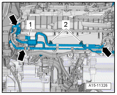

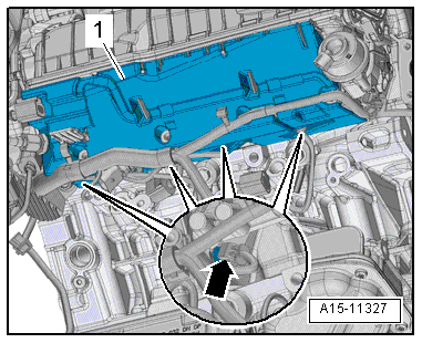

Remove the Cylinder Head Coolant Valve -N489- -arrow- from the bracket and push it forward.
pic 2

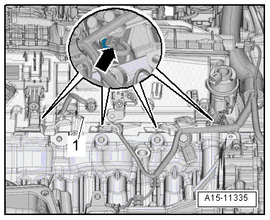

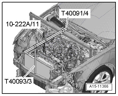

Bring the impact member into the installation position and secure it. Refer to 63 - Body Exterior - Front Bumper; Overview - Impact Member.

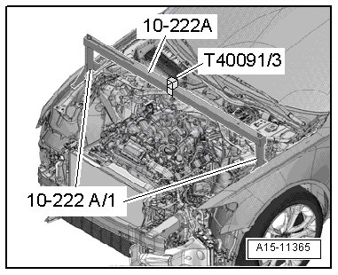

Position the -10-222A- on the left and right suspension strut towers as illustrated.
pic 3

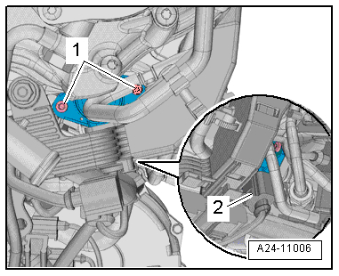

Mount the assembly appliance as illustrated.
pic 4

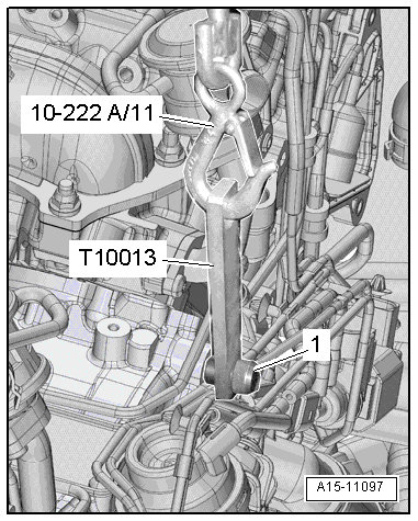

Tighten the -T10013- with the threaded pin -1- of the -T10338- in the left front threaded hole in the cylinder block as shown in the illustration.
pic 5
Engage the carabiner hook of the -10-222A/11- on the -T10013- and pretension the engine slightly.

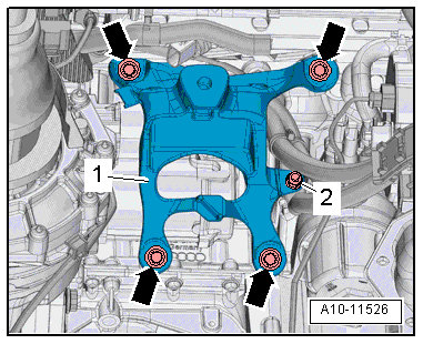

Remove the generator. Refer to 27 - Electrical Equipment - Generator; Generator, Removing and Installing.
Remove the right engine mount. Refer to Right Engine Mount, Removing and Installing.

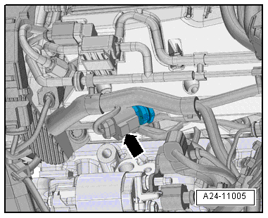

Remove the nut -2- and free up the ground wire.
pic 6
Remove the bolts -arrows- and remove the right engine support -1-.

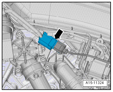

Remove the -N316- -1- from the bracket and free up the wires at the right intake manifold -2-.
Disconnect the connector -arrow- for the -G247- .
pic 8

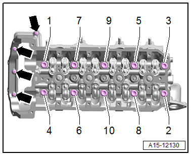

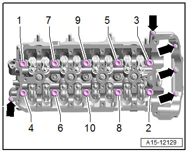

Loosen the cylinder head bolts in the sequence -1 to 10-.
Remove the bolts and the cylinder head carefully.
Lay the cylinder head on a soft surface, such as foam.

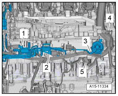

Disconnect the connector -4 and 5- and then free up the wiring harness from the intake manifold.
Disconnect the connector -2- for the Intake Manifold Runner Position Sensor 2 -G512- -1-.
pic 18

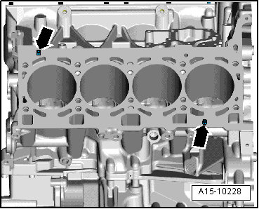

If there are no alignment bushings -arrows- at the locations marked in the cylinder block, insert them.
Install the cylinder head gasket on the alignment bushings in the cylinder block.
Cylinder head seal installation position: Identification "oben" (top) or the cylinder head part number.

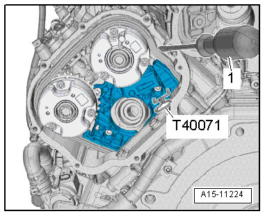

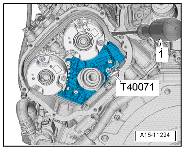

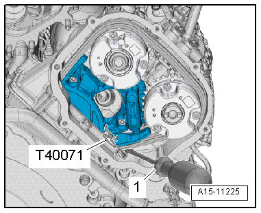

Press the right camshaft timing chain tensioner guide rails in as far as the stop using a screwdriver -1- and secure the chain tensioner with a -T40071- .
The chain tensioner is lubricated with oil and can only be pushed back slowly by applying constant pressure.
The procedure is illustrated with the camshaft installed.
