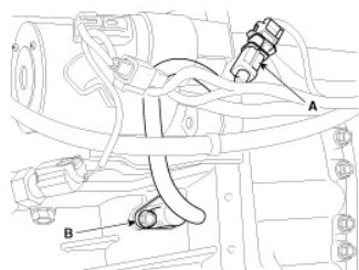

Hello, I would replace the crankshaft sensor. The clue that it is bad is the RPM gauge stops working, and when the sensor fails it will sometimes not leave a trouble code. Here is the location of the sensor to be replaced which is by the starter. Thanks for the detailed questions, it helps. Check out the images (below). Let us know how it goes.

Thank you so much. I will definitely let you know how replacing my sensors goes on Monday! Thank you for your help, I’ll check back in ASAP!
