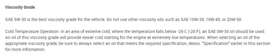

My car will not drive when it is warm only when it is cold. but I did not have any issues with it until I took to Grease Monkey to get the oil changed. why is this happening?
Oct 27, 2019 at 2:07 PM
The only thing that would be related to this is if they used the wrong oil however, I still don't see this causing the engine to stall. This sounds more like a temp sensor issue or even an ECM issue.
However, we need to start with what oil they used and if there are codes. This will help us determine if it is related or just a coincidence.
Let me know and we can go from there. Thanks

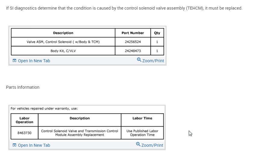

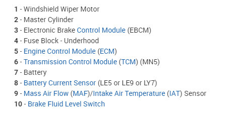

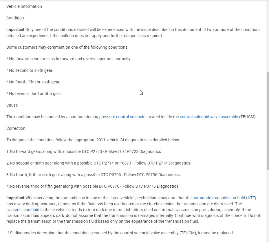

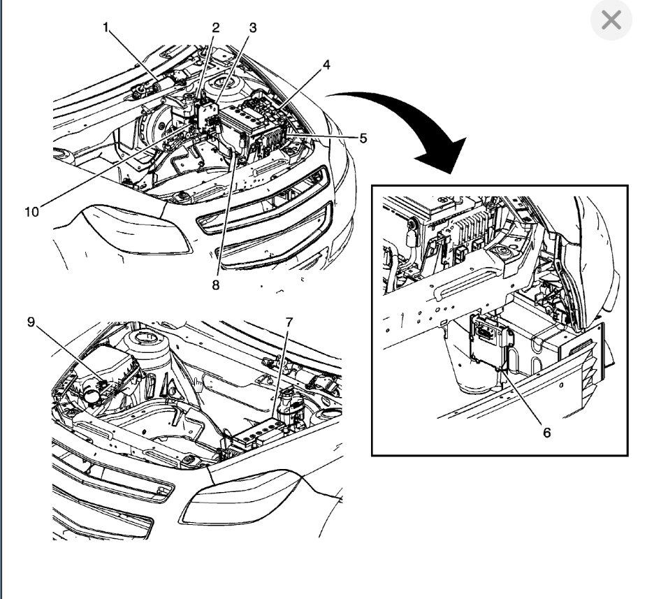

Okay. This sounds like internal transmission issues. Do you have a manual shift mode? Paddle shifters? See if using the manual shift mode gives you the movement or at least more than in auto.
If it does then we need to dig into the transmission. I attached a TSB that I think talks about this. This points out the pressure control solenoid inside the valve body. Let me know if you need more information. Thanks

Okay. Check out the TSB. I think you have an issue with the valve body.
