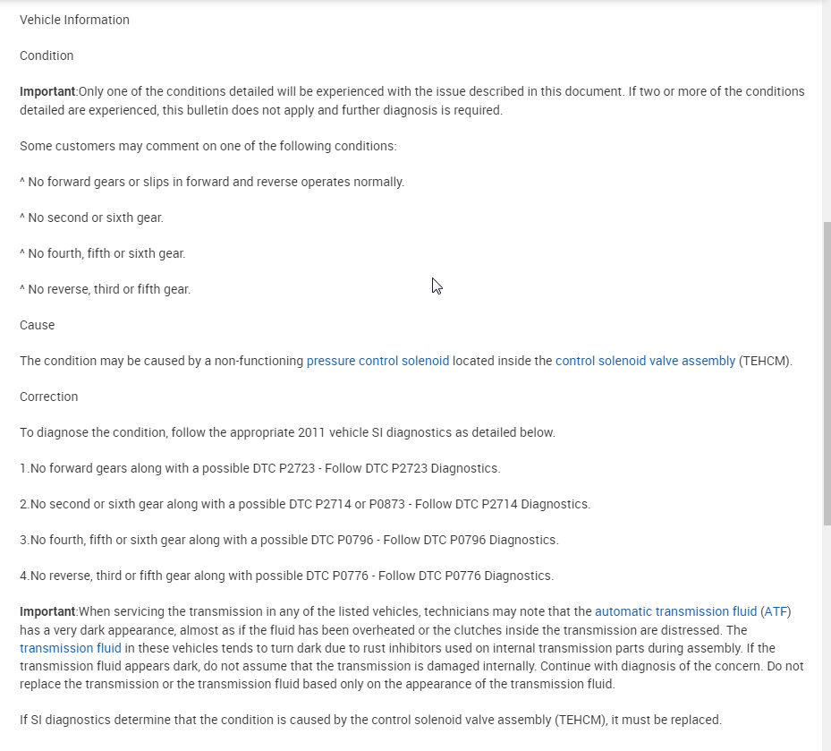

They put the high grade oil so today I figured out my car will go into gear for like 3 or 4 blocks then the transmission will stop working so I turn the car off wait 10 min start it up again an the transmission will go agaun for a few blocks but it will drive if my car is cold not warm
Oct 28, 2019 at 11:22 AM
Okay. This sounds like internal transmission issues. Do you have a manual shift mode? Paddle shifters? See if using the manual shift mode gives you the movement or at least more than in auto.
If it does then we need to dig into the transmission. I attached a TSB that I think talks about this. This points out the pressure control solenoid inside the valve body. Let me know if you need more information. Thanks

Okay. Check out the TSB. I think you have an issue with the valve body.

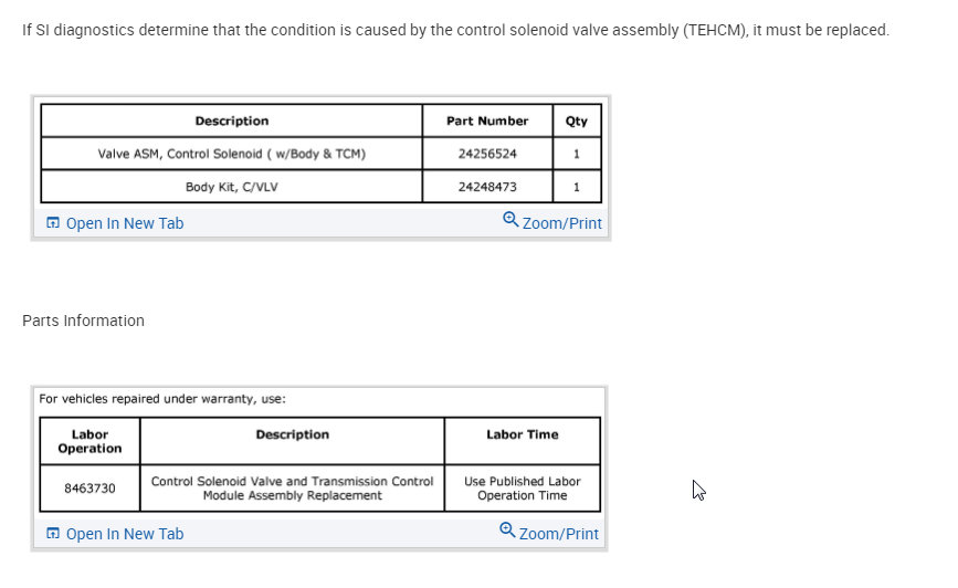

Okay, how would i do that and is that expensive to fix? my car is my sons life line an i have to try to fix it.
Oct 28, 2019 at 1:19 PM
We need to start with checking for codes. I would not recommend just replacing this without confirming it. This is not a very expensive repair compared to changing the transmission but it is not like an oil change either. It is hard to give you an estimate because the labor is going to vary. Let's start with getting the codes and we can go from there.
