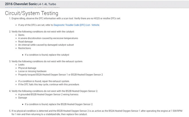

We have replaced the fuel cap and have changed one purge value and after a couple of days the check engine light came back on. so, we put another purge value on it, and it didn't come back on in over a week, and this morning i used auto start and it came right on after i got in the car. Would there be a reason why it could be doing this or is there another reason why?

The code, P0420, is related to a catalytic converter not operating properly. Is this the only code you have? I ask because it could be related to the heated oxygen sensor as well. However, if there is no code for the sensor, chances are the converter needs replaced.
Take a look at the pic below. It provides a basic inspection of the converter. Check through it and perform any of the steps you can and let me know the results.
See pic below.
