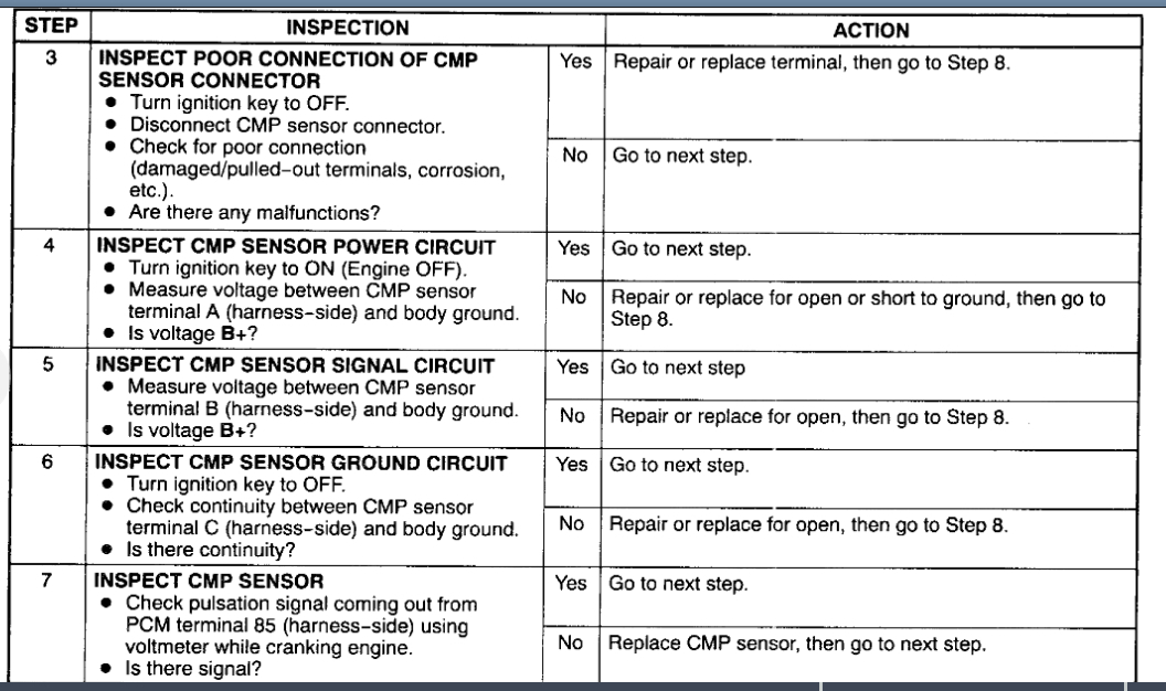

Code P1345
2000 MAZDA PROTEGE
100,000 MILES • 1.6L • 4 CYL • 2WD • MANUAL
RODNEY OAKES

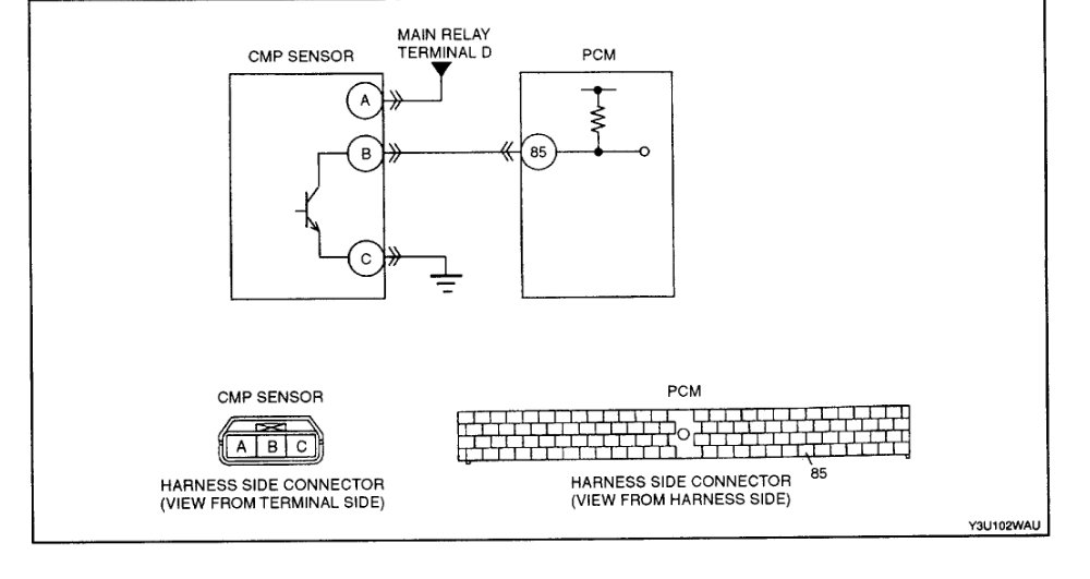

It is getting fire, fuel and will not start.
May 22, 2019 at 9:35 PM
SCGRANTURISMO
  • 4,897 POSTS

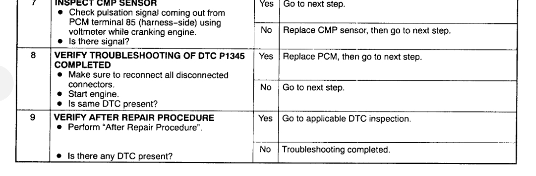

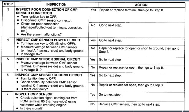

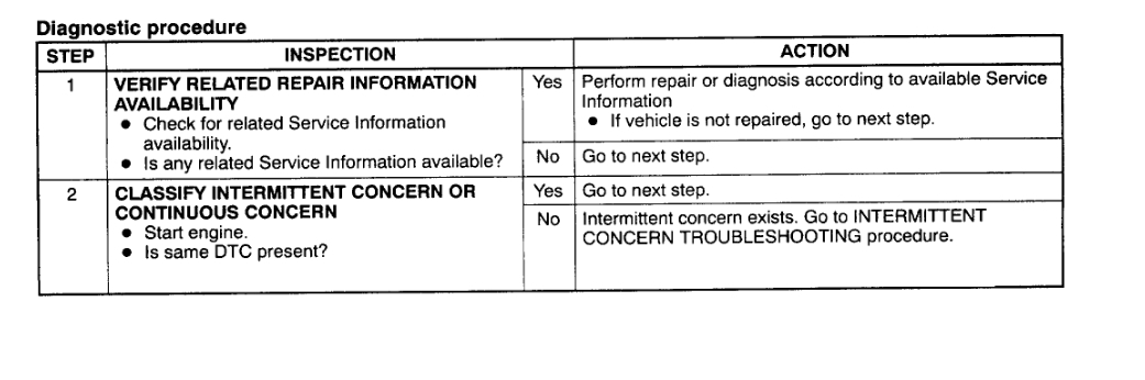

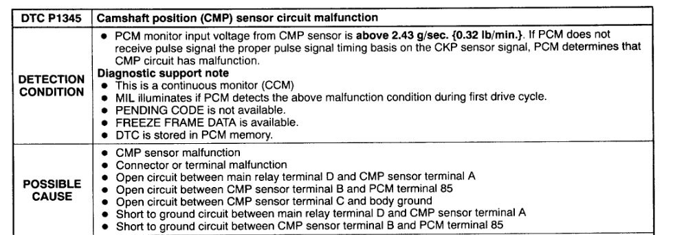

In the diagrams down below I have included the factory troubleshooting flowchart for Direct Trouble Code (DTC) P1345. Please go through this guide and get back to us with what you find out.
