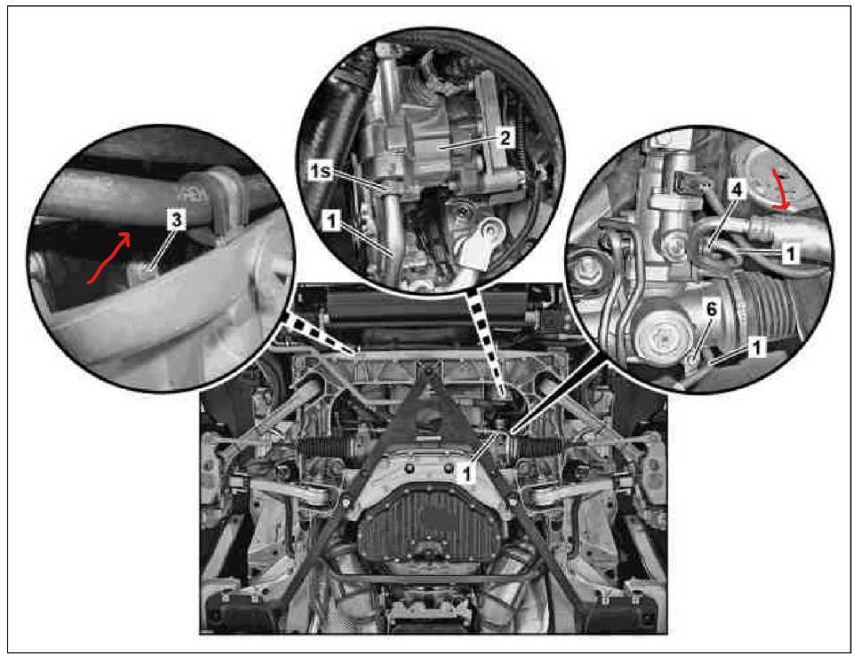

The ABC Malfunction light came on when I started the car. There was no power steering. Oil was spraying over the front of the motor. I checked the hydraulics, and the car would rise and lower with no issue.

It sounds like the system has a leak, probably the high-pressure hose which will make the light come on. If you need to clean the engine compartment and refill the steering with fluid. Then start the engine and let it idle while watching the hoses or pump leak, make sure to wear safety goggles. Here is what I think is leaking. Check out the images (below). Please upload pictures or videos in your response so I can see.
