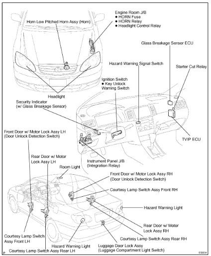

from the attached pictures where is the starter relay and fuse?
2004 TOYOTA COROLLA
164 MILES • 4 CYL • 2WD • AUTOMATIC
BELLAT1
Hi Expert, I would like to know from the attached pictures where is the starter relay and fuse in my car listed above LE model?
Please can you crop on them?
By the way, I am not able the start my car, I have a new tested battery, the starter is also tested and working fine, I am thinking the issue is limited between the relay, fuse and ignition.
Comment :
1. The lighting is working fine in my car, including dash board, radio and all other lights.
2. No sound or sign that my car is trying to start when I turned the key-switch to start mode.
My car inspection is due in few days and would like to fix it my self with your appreciated help of course.
Thank you for your help in advance.

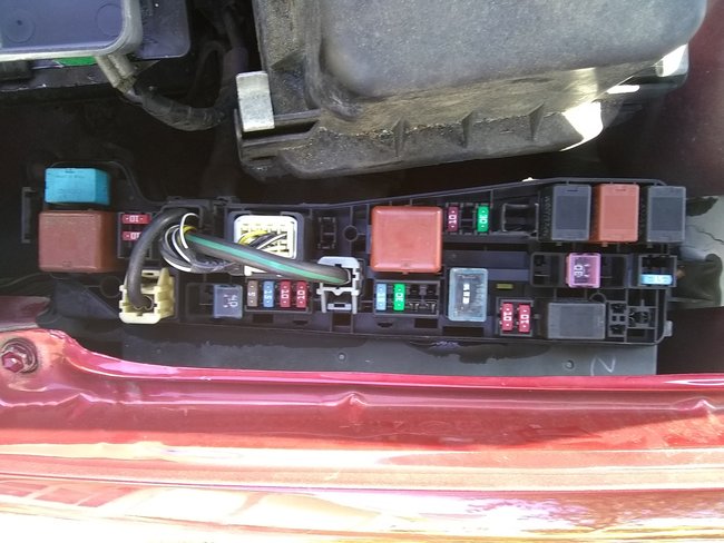

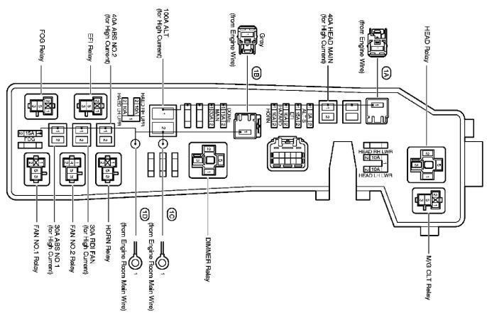

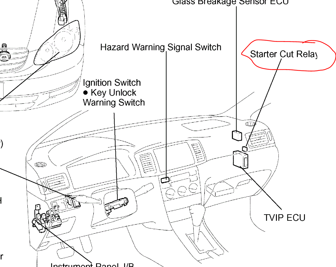

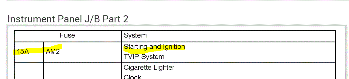

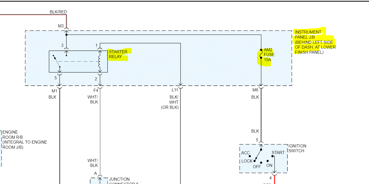

I don't have regular pictures. However, I can tell you that the starter relay is in the junction box under the left side of the dash. Also, there is a 15 amp AM2 fuse that I need you to check. It is in the same box. See the two pictures below.

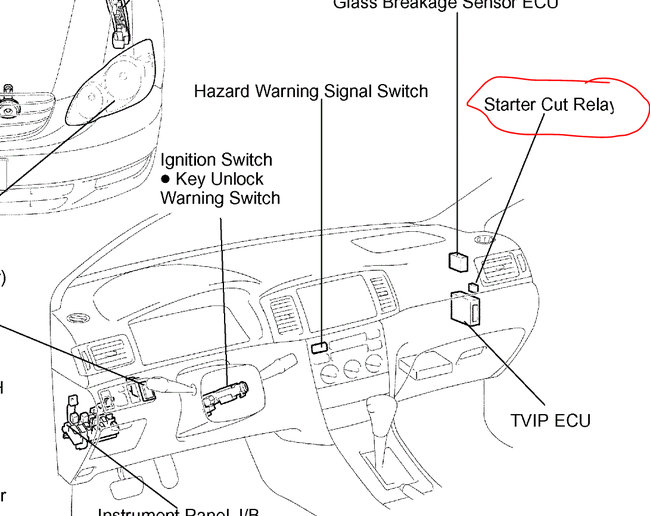

There is also a starter cut relay located under the dash on the passenger side. See pic 3.
Try to see if it will start if you place it in neutral. There could be an issue with the neutral/park safety switch.
Let me know if this helps.

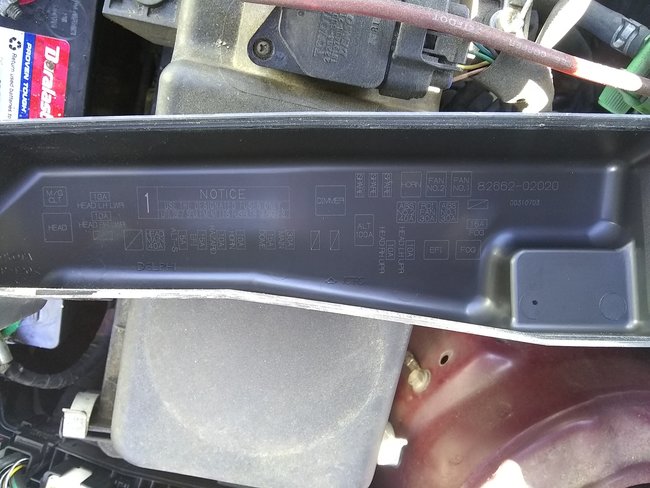

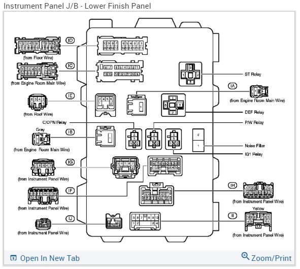

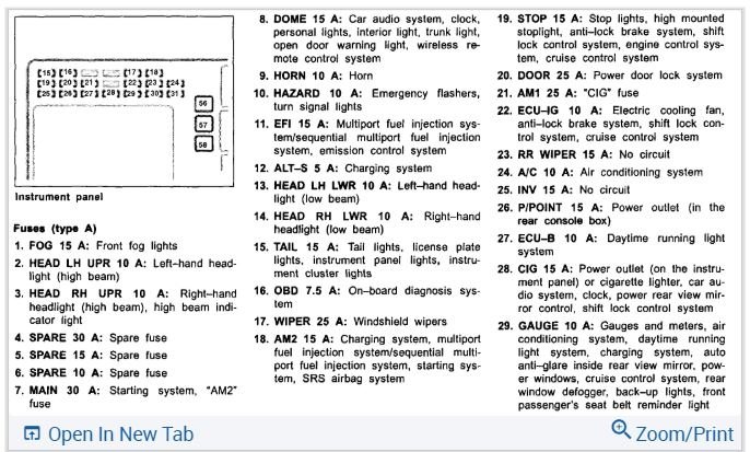

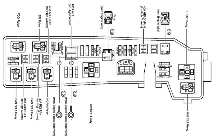

Here is the legend for your engine compartment fuse box. you should be hearing some of them click. A click when you turn to on position and another one it the start position. If you touch with someone one the key then you should be able ton feel the one the one that's the starter but your starter relay is at the Instrument Panel Lower Finish Panel.
Let me know how you make out.
Tom
