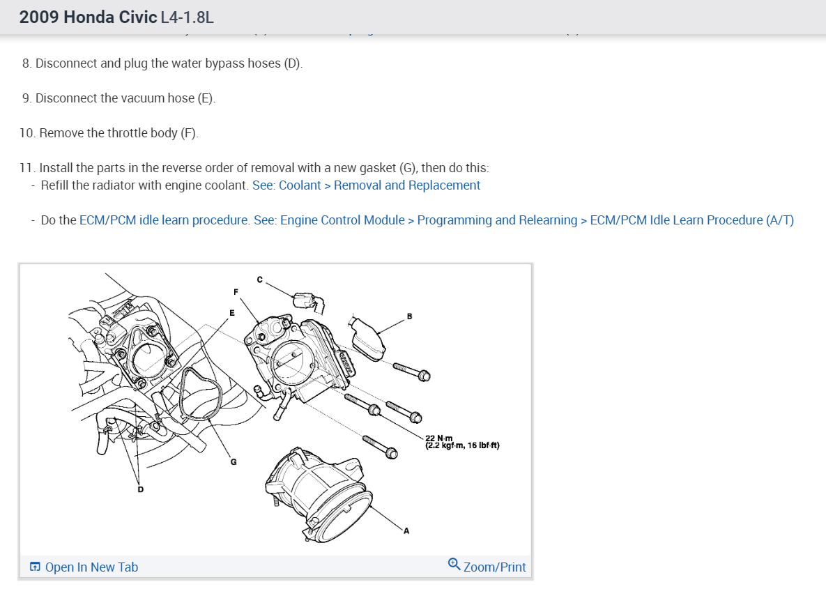

Okay let me try it then i'll also check the throttle, but now i can't locate the throttle position clearly.
May 7, 2019 at 9:31 PM
  • 55,433 POSTS
Here is a guide to help you with diagrams below to help walk you through the steps:
