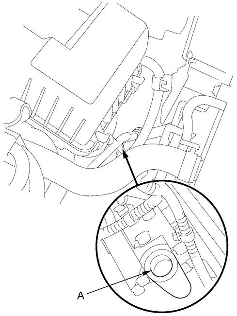

my car is late for gear change.

3. Remove the dipstick (yellow loop) (A), and wipe it with a clean cloth.
pic 1

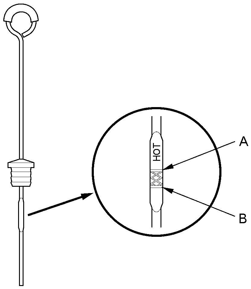

4. Insert the dipstick into the transmission.
5. Remove the dipstick and check the fluid level. It should be between the upper mark (A) and lower mark (B).
pic 2

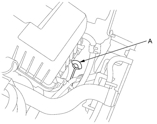

8. If necessary, fill the transmission with the ATF through the dipstick guide opening (A) to bring the fluid level midway between the upper mark and lower mark of the dipstick. Do not fill past the upper mark. Always use Honda ATF DW-1 (ATF-Z1 has been replaced with ATF DW-1, Honda Service News Nov 2010) Automatic Transmission Fluid (ATF). Using a non-Honda ATF can affect shift quality.
pic 3
9. Insert the dipstick back into the transmission.

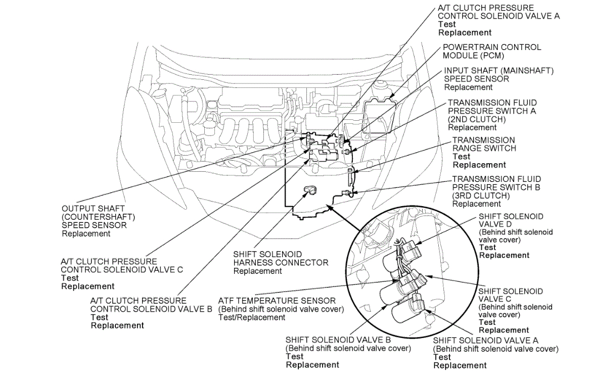

There are other things such as a pressure control switch, clutch pressure control switches and so on. Does this happen in all gears and regardless of engine temp? See pic 4 for pressure switches.
This leads me to the next step. Because of the model year, the vehicles system should be scanned to determine if there are diagnostic trouble codes. The CAN bus system should be scanned to conform issues within any of the computers / modules. CAN stand for computer area network. They are tied together via a few wires. If one fails, this type of scan should pick up on the issue.
