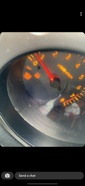

Multiple warning lights turned on
2005 NISSAN MAXIMA
20,000 MILES
HELPME2020
A bunch of lights are on and i do not what the problem is.

From what I can see, the lights are all related to the traction control. The likely cause is a failed ABS sensor at one of the wheels.
You have two choices to check that theory. First, have the computer scanned for diagnostic trouble codes. It will require a scan tool able to read more than engine codes. Or, you can check one sensor at a time to confirm operation.

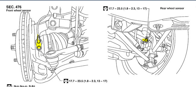

It isn't hard to check them. Here is a link that explains how it's done:
https://www.2carpros.com/articles/abs-wheel-speed-sensor-test
I attached a pic below showing the sensor locations for both the front and rear.
Try this and let me know what you find. Also, please feel free to let me know if you have other questions.
