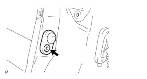

  • 55,433 POSTS
The first thing I would do is check the dome light switch at each of the doors. I would remove them to see if the light stays on with the doors shut. Let me know what you find. Check out the images (below).

  • 116 POSTS
I followed your earlier advice and tested the door courtesy switches. With a door open, I manually press and hold a door switch (simulating the door closed), then lock the car while still holding the switch. When I release my finger from the switch after the car is locked, the abnormal behavior immediately appears: the parking lights flash and the dash displays “TURN LIGHTS OFF” for about 20 seconds. This happens with any door, not one specific switch, and the dash door-ajar indication behaves correctly while pressing and releasing the switch. During this event, the dome light does not flash (although the dome light still stays ON continuously in AUTO mode).

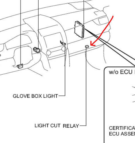

  • 55,433 POSTS
So to confirm the dome override switch was replaced, the dome light trigger switch's have been checked, I don't see the image that you attached from your post above. Also, I was looking at the wiring diagrams and the trunk has a interior light switch as well so that must be included in the passenger door switches. I would disconnect all door and trunk switches to see if the problem remains, (the trunk pin switch is inside the latch so disconnect the latch electrical connector). There is a light "cut" relay on the right side of the dash that maybe stuck on as well so lets pull it to see if the lighting issues stops. If not it sounds like the BCM is having issues we need to do the CAN scan to help confirm the BCM failure. The BCM controls the interior lighting system. Here is the location of the cut relay. Check out the images (below). Let us know how it goes

  • 116 POSTS
Thanx , but can you help me with steps to remove glove box , as i see 2 plastic hinges for door of glove box , in other words , how to reach the relay ?
Jan 10, 2026 at 9:08 PM
BEBOBEBO
  • 116 POSTS
Hi , want update what i did , i removed the light cut relay and the dome light which was on door open mode turned off , but i tested the relay and it function well ( no resistance beeps when touch 30 and 87 leads) and resistance between 85 and 86 is 170 ), so it looks relay is ok .
