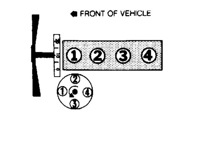

when driving it just backfires and it wont go any faster and sometimes dies
1992 NISSAN 240SX
180,000 MILES • 2.4L • 4 CYL • RWD • MANUAL
ABANDONEDTEDDY
When I give it gas when it idles or just when i am driving it just backfires and it wont go any faster and when I push the pedal all the way down. It also sometimes dies when I put it into neutral. I do have a new fuel pump installed, new plugs, wires, injectors, MAF.
Sep 26, 2016 at 1:11 PM
HMAC300
  • 48,601 POSTS
scan for codes and check compression make sure the firing order is correct as this can cause a backfire as well.
