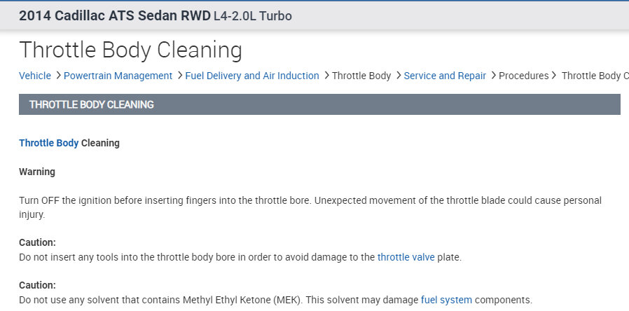

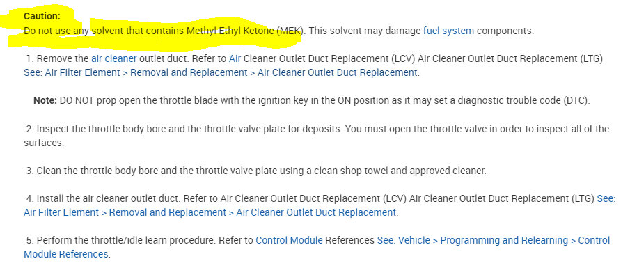

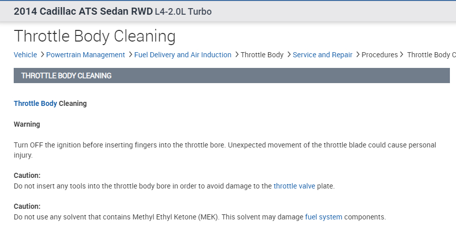

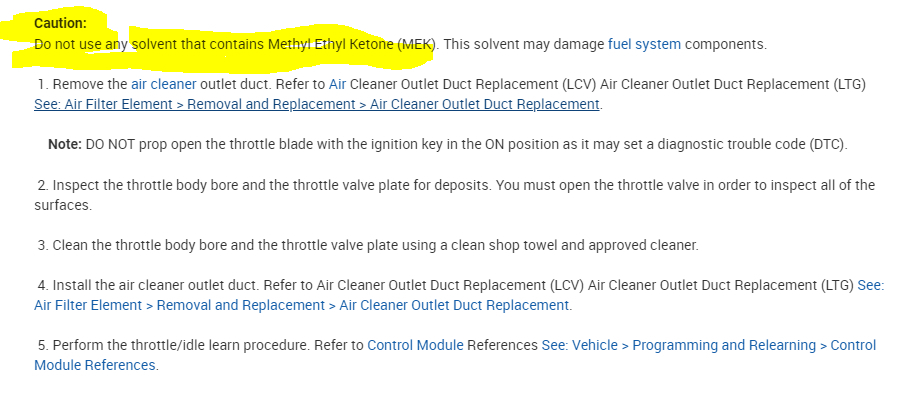

I attached the directions for servicing the throttle body specific to your vehicle below.
Try these things and let me know the results.
