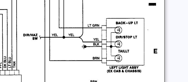

When I go to apply the break my break lights turn off and then I do apply the break my interior lights also turn off. Also my breaks are very dim. There are two wires that I connected to my breaks they are both white and one wire is hot there is a third wire hanging down under my dash and I believe it is a ground wire it is black. In addition I don't know if this has anything to do with it but I am getting power to the fuse but not to the switch with the original connection. Anything helps thank you.

Faulty grounds can cause some funny issues. Your brake lites are wired through the turn signal switch. Turn and brake use the same bulb filament, just not at the same time. At the brake lamp, yellow wire is voltage and black wire is ground. Did you check the actual voltage reading at the brake lamp wiring?

Yes we are getting 12volts

In that case,I'm thinking it's the ground. You could run a redundant ground, see if it helps anything?

Just a clean part of the chassis/ metal part of vehicle. You may have to clean a little paint. You could track the black ground wire where it is mounted. It could just be the wire and not the contact point. Just make sure the contact point is clean metal.

You already said you had good voltage at the brake bulb, with the brake pedal depressed. If they are dim, I'm still thinking ground.
Do you want to check voltage to and from brake switch? Orange wire to brake switch is hot all the time. When you activate the brake switch by stepping on the brake pedal, the white wire goes hot, carries voltage to turn switch and then to brake lites.
