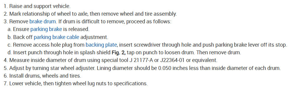

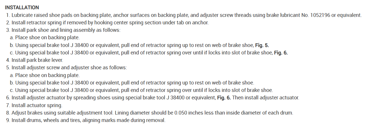

My brakes went out, so I replaced brake pads wheel cylinders one of the calipers bleeders but and it bled them but I'm still getting I'm getting some brake but not the way it was.

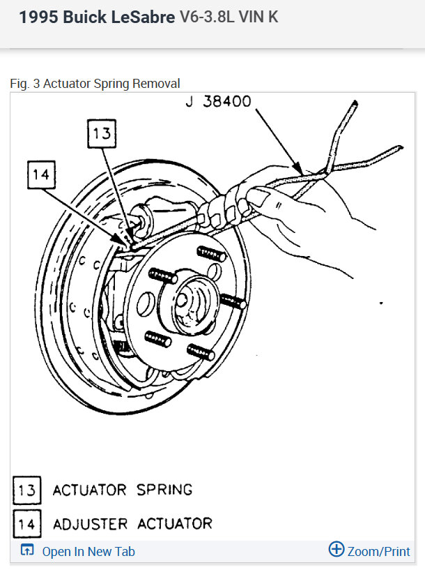

Because this car has ABS brakes you may have air stuck inside the ABS controller in which case the valve will need to be opened while bleeding. Please go over this video to show you what I am talking about:
https://www.youtube.com/watch?v=nQRnKyVyMuQ&t=449s

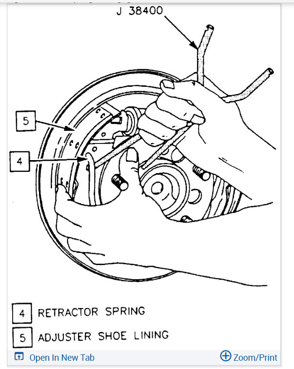

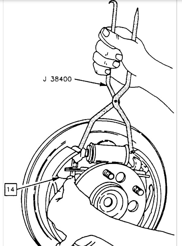

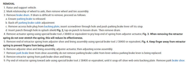

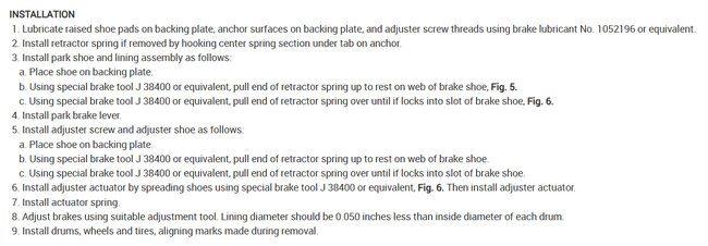

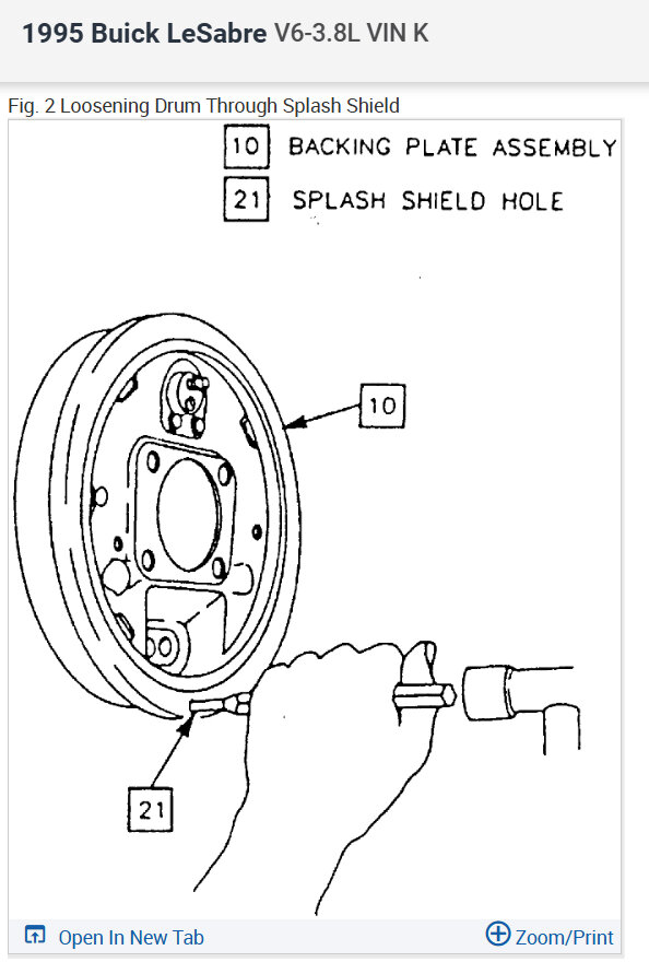

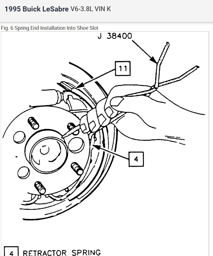

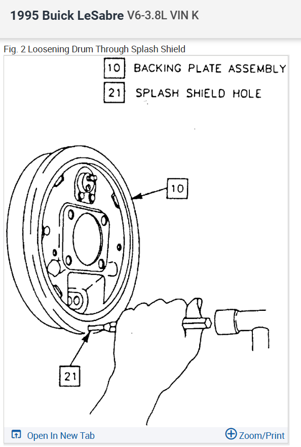

Also, it could be the rear brake shoes are not assembled or adjusted correctly. Here is a guide that goes over the reasons you can have a low brake pedal:
https://www.2carpros.com/articles/brake-pedal-goes-to-the-floor
Here is the correct way to adjust and replace the rear brake shoes. Check out the images (below). Please upload pictures or videos in your response of any problems so we can see what to help you with.
