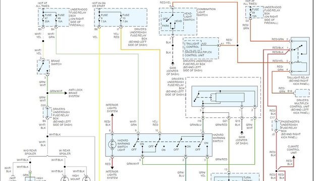

I replaced my bulbs and everything, my tail lights work fine but when I step on the brake the brake lights don’t turn on. I can’t find the fuses to the brake lights. Any suggestions?
Apr 15, 2019 at 10:21 AM
Good evening,

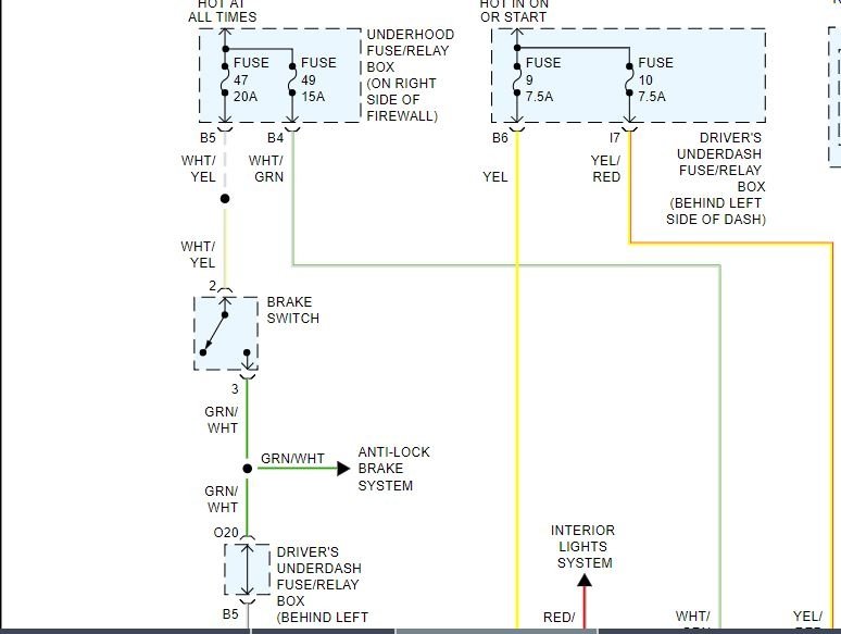

I attached the diagram for you to view of the circuit. The fuse is marked with the location of the fuse block and the fuse. Use a test light to verify power on both sides.
