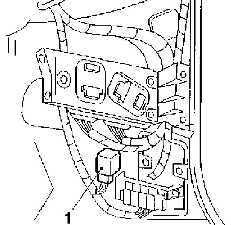

Hi guys, please help my car's fuel pump relay turns on and off as I switch on the engine and the car does not start.
Mar 5, 2022 at 4:19 PM
BORIS K
  • 836 POSTS
When then fuel pump relay clicks on/off can you hear the electric fuel pump running?
The relay is located behind the right kick panel at the bottom of the A-pillar, see image 1 below

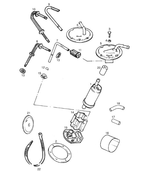

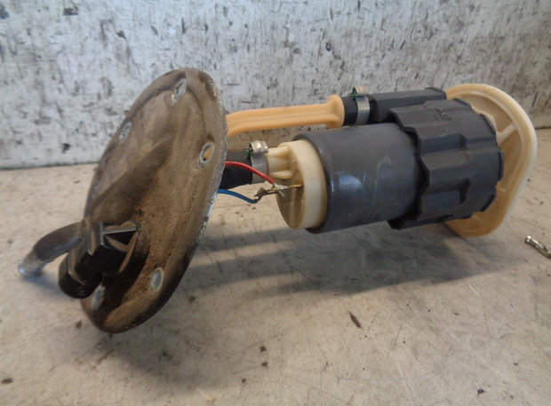

The fuel pump is located inside your fuel tank.
See image 2+3 below
To access the fuel pump connectors, you will need to remove the rear seat.
Once you have access to the fuel pump you can test the 12V supply to pump.
There are 2 wires for the fuel pump, 12V feed is on the red/blue wire and the brown wire carries the ground.
The easiest way to test 12V supply would be using a test light. Use the brown wire as the ground and then probe the red/blue wire. Cycle the ignition and when the fuel pump relay clicks in the test light should light up.
