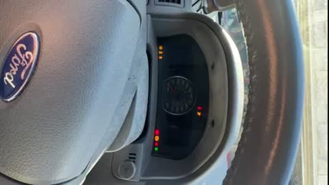

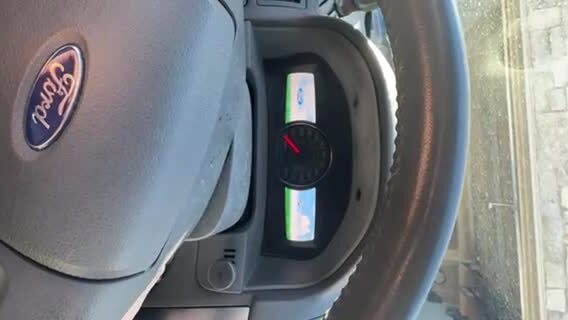

After replacing the battery, the vehicle runs rough then shuts off?
2010 FORD FUSION HYBRID
86,000 MILES • 2.5L • 4 CYL • 2WD • AUTOMATIC
MEH7777
After installing the new battery in my vehicle listed above it starts but runs rough then shuts off with the Triangle display and message "Pull Over for Safety" and then shuts off. It has to be something simple since it ran just fine before replacing the battery. I also had Ford check the Hybrid battery's not too long ago and they said they were strong. I've already tried disconnecting the negative cable and letting it set then reconnecting and restarting but it does the same thing. Attaching a video.
Thoughts? Things to try?

Hey Mike,
This is strange, it seems like you have had a voltage spike that has taking out a sensor or module, I would run a CAN scan on the car to see what codes are stored.
https://youtu.be/u-4syLc-ifQ
Here is a note from Ford on changing the battery:.
When the battery (or PCM) is disconnected and connected, some abnormal drive symptoms may occur while the vehicle relearns its adaptive strategy. The charging system set point may also vary. The vehicle may need to be driven to relearn its strategy.
You might want to try a hard system reboot which can't hurt.
https://www.2carpros.com/articles/step-by-step-guide-performing-a-hard-system-reboot-for-your-vehicles-electronics-systems
Please go over these guides and get back to us.

Thank you! The second option actually worked. Thank you again for the advice. I appreciate it!
