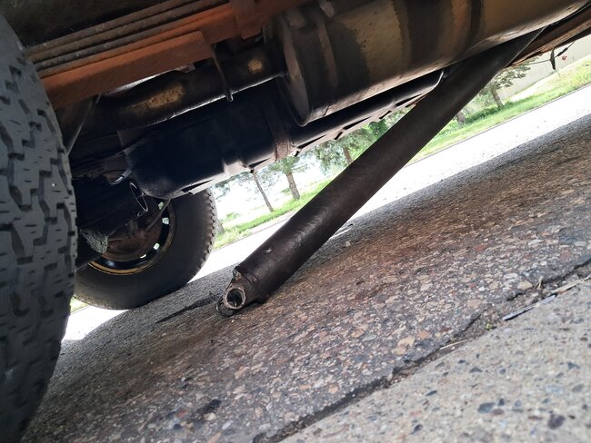

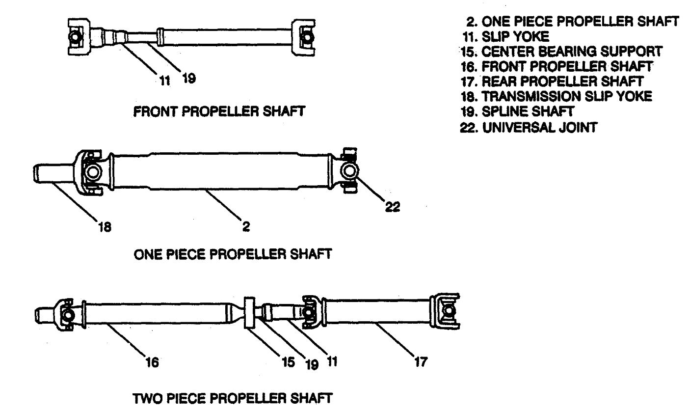

I was driving and I heard a noise, like it was breaking underneath the truck. I came to an instant stop. And the bad tires locked up the dry shaft hanging. And I want to know is my dimension or something like that. Is bad
Aug 16, 2024 at 2:15 PM
SMITH EVON
My drive shaft broke.
Aug 16, 2024 at 2:39 PM
  • 55,065 POSTS

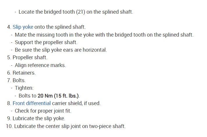

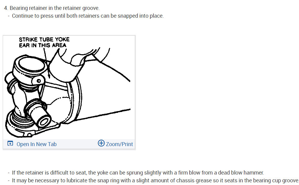

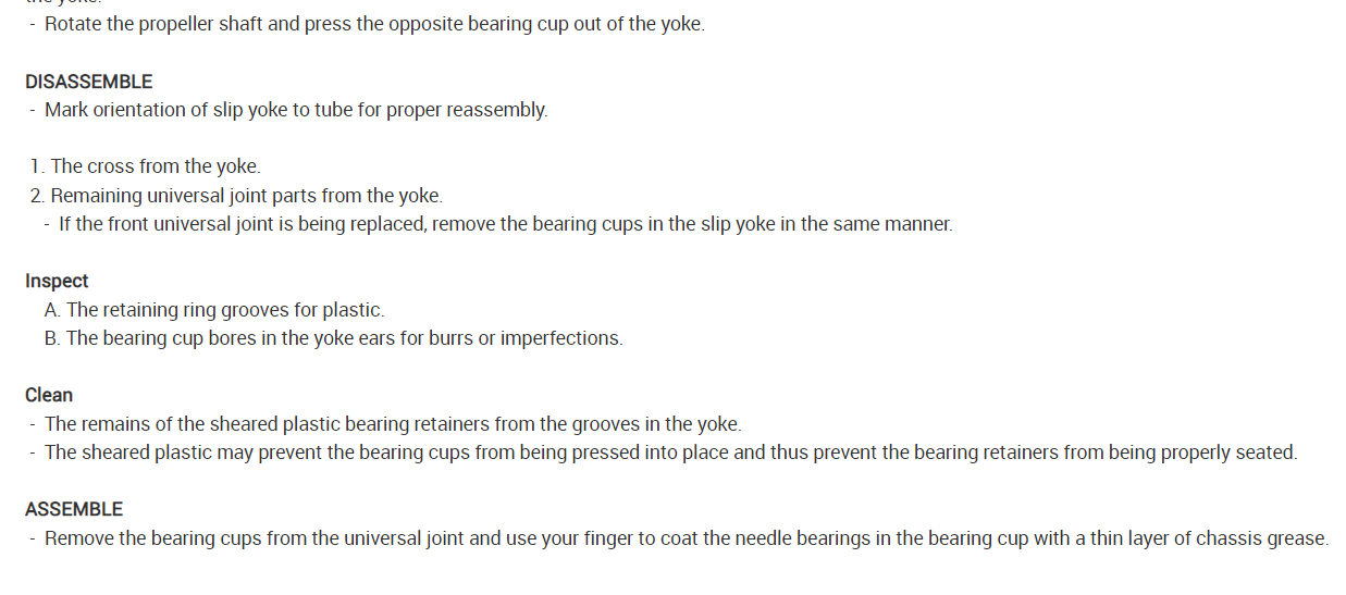

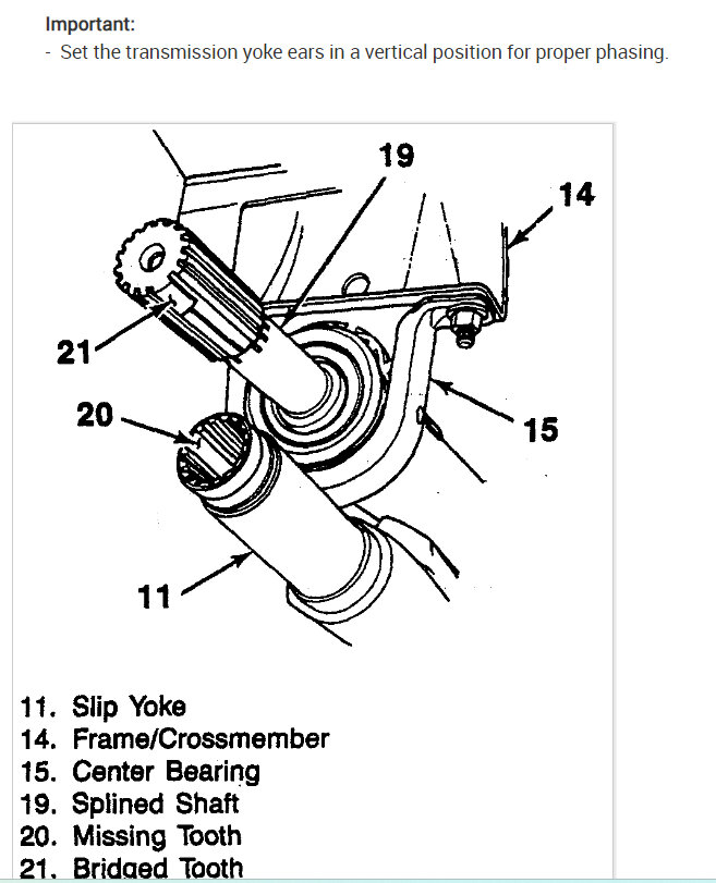

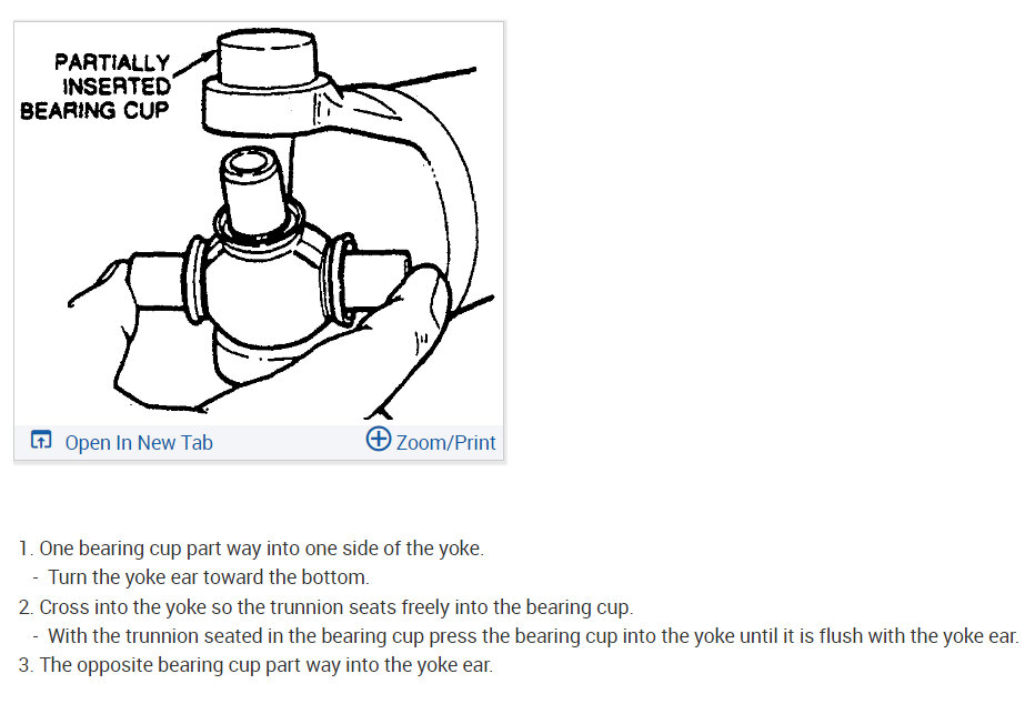

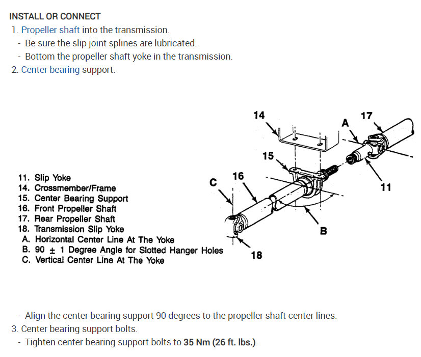

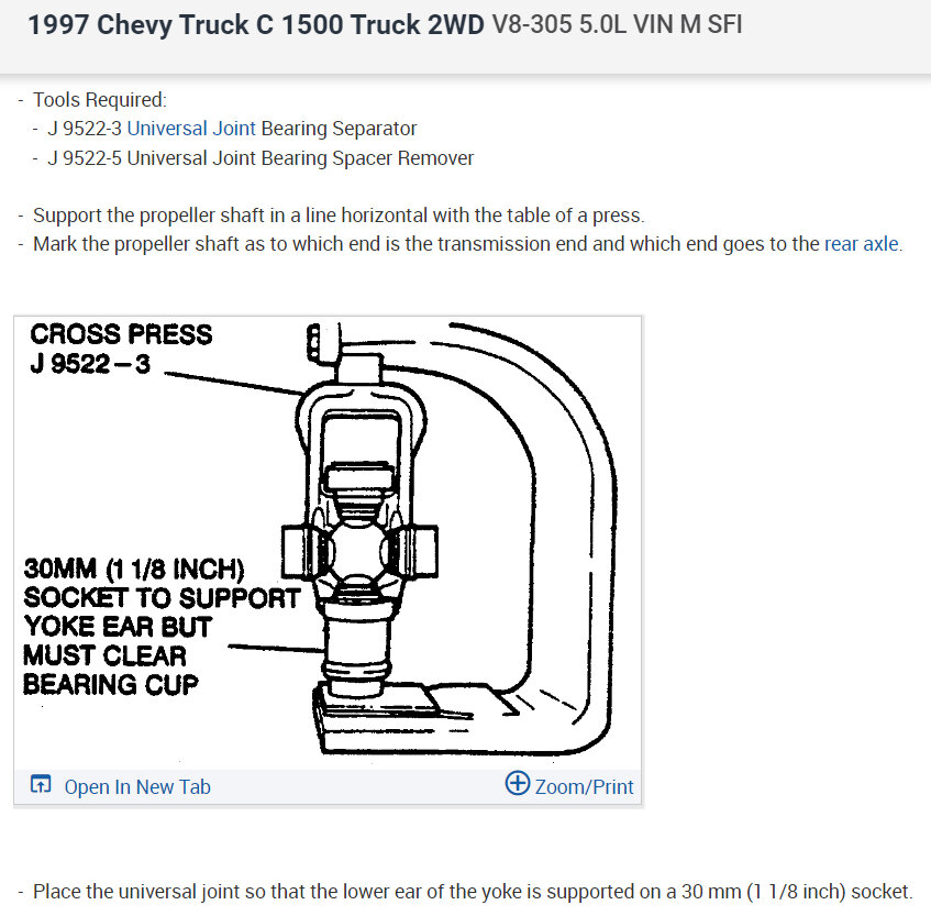

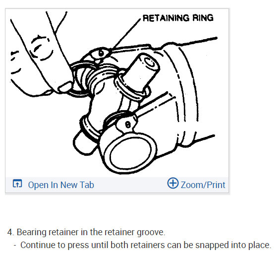

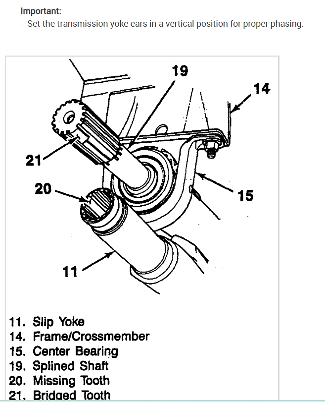

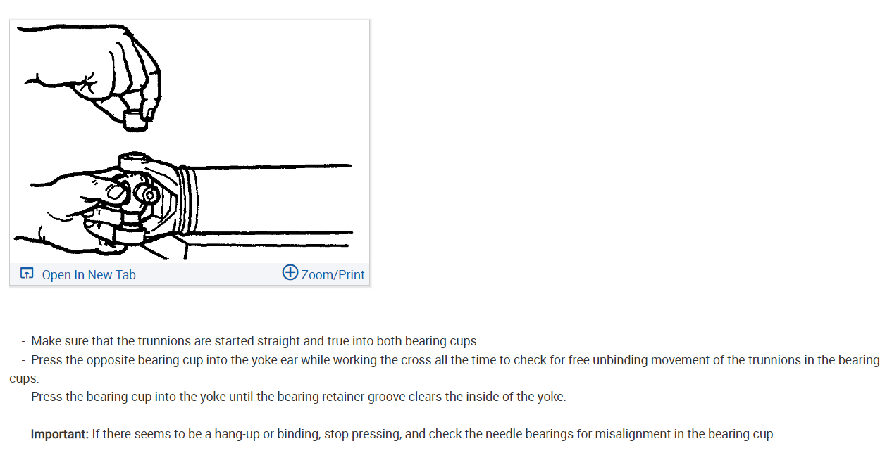

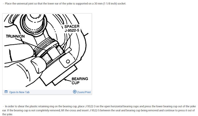

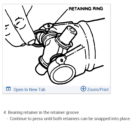

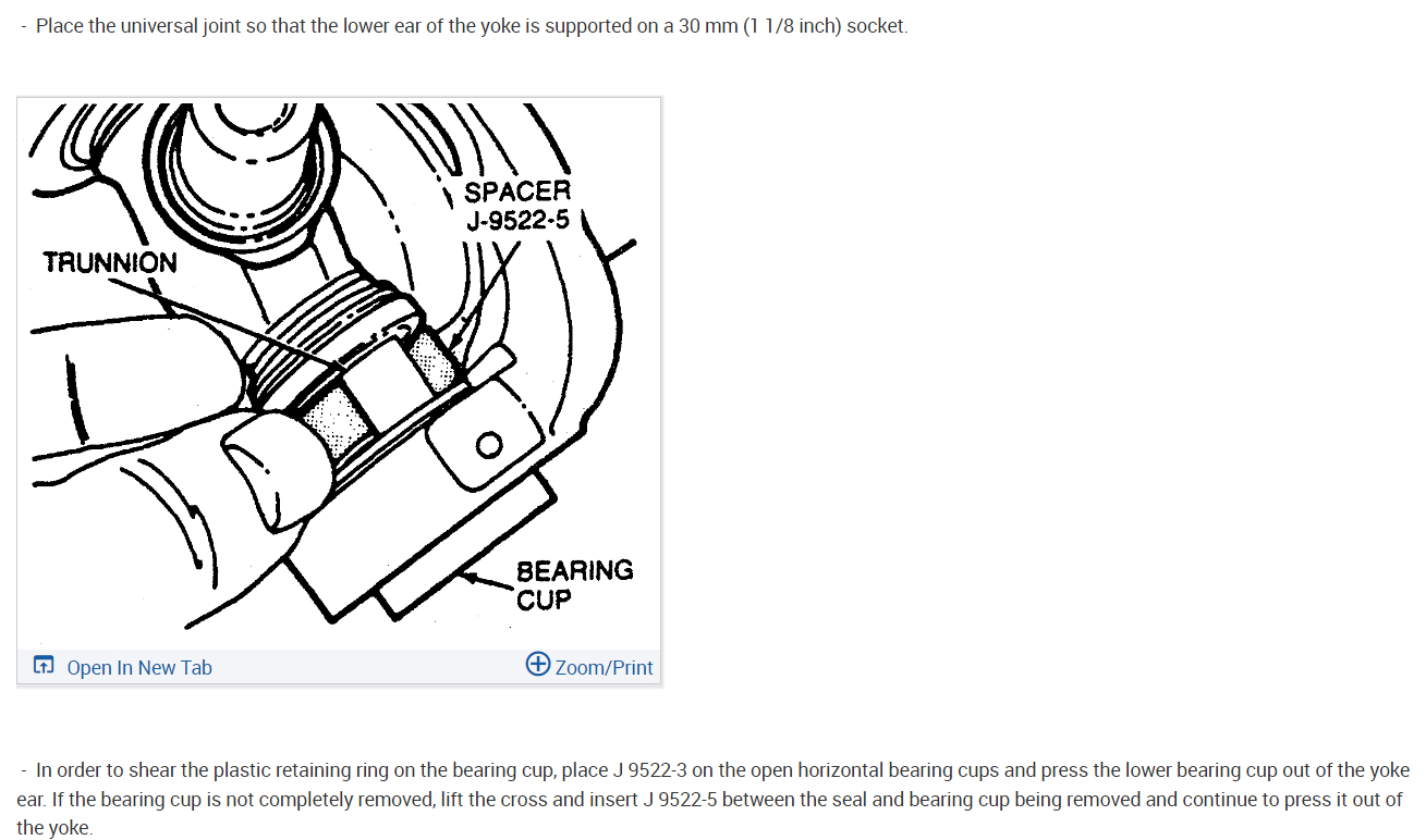

Thanks for the image, yep you have a broken driveline, but I would raise the rear of the truck to see if the rear wheels will turn. It could be the driveshaft broke due to the rear differential issue, here is a guide that can help:
Here is a guide to help with the U joint replacement:
https://www.2carpros.com/articles/how-to-replace-a-universal-u-joint
If the rear wheels turn, I would service, the differential. This video will show you how, and you can look for metal in the gear oil:
https://youtu.be/6F26Kir0OCg?si=hpH62tS8CnpEAffs
Check out the images (below). Please upload pictures or videos in your response of any problems so we can see what to help you with.
