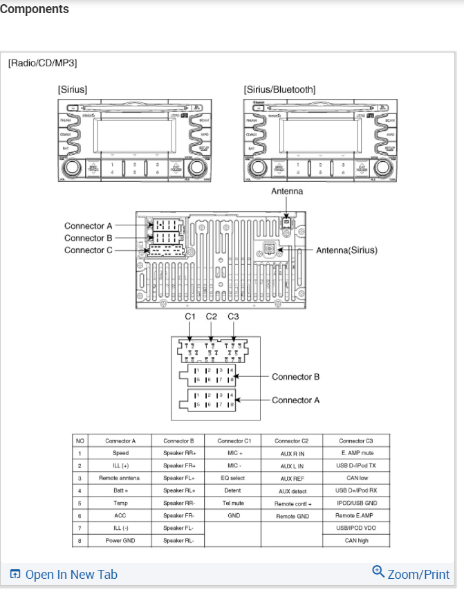

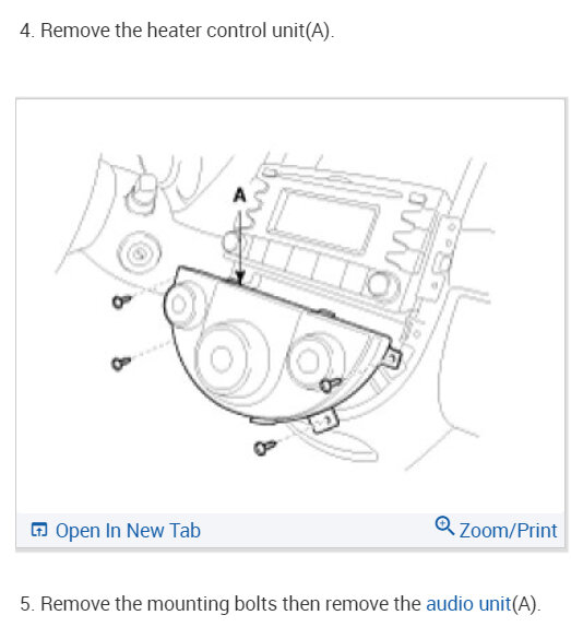

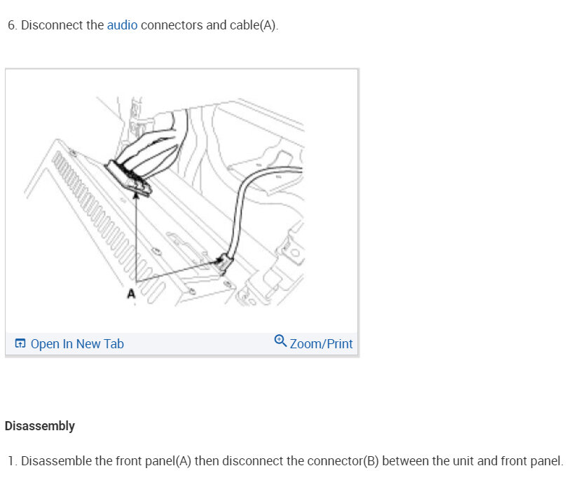

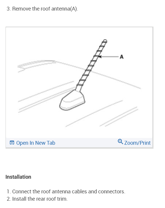

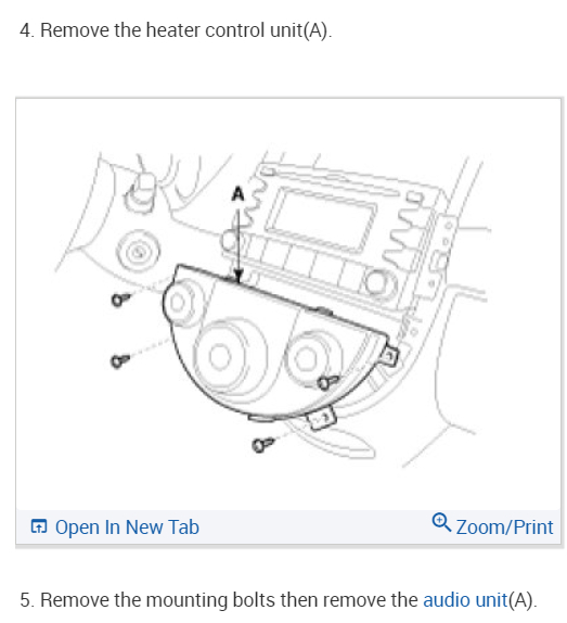

stock radio without navigation. I bought it used; AM never worked, FM, CD, Bluetooth they all work great. I am not getting any AM radio stations; I am within AM range. Already checked the cables behind radio, they are all connected. Is this likely head unit, cable, or antenna issue? Which one should i go to first?
Sep 25, 2023 at 4:51 AM
  • 55,433 POSTS

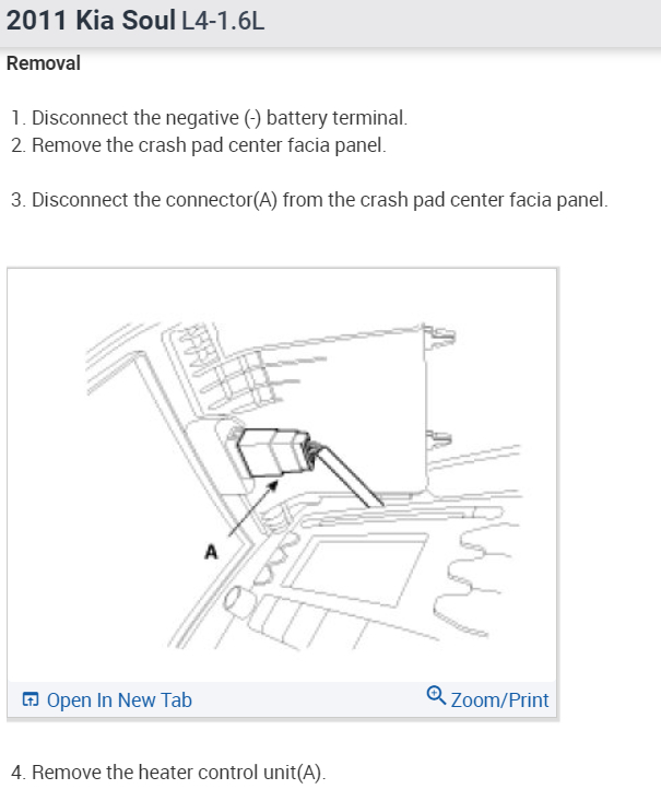

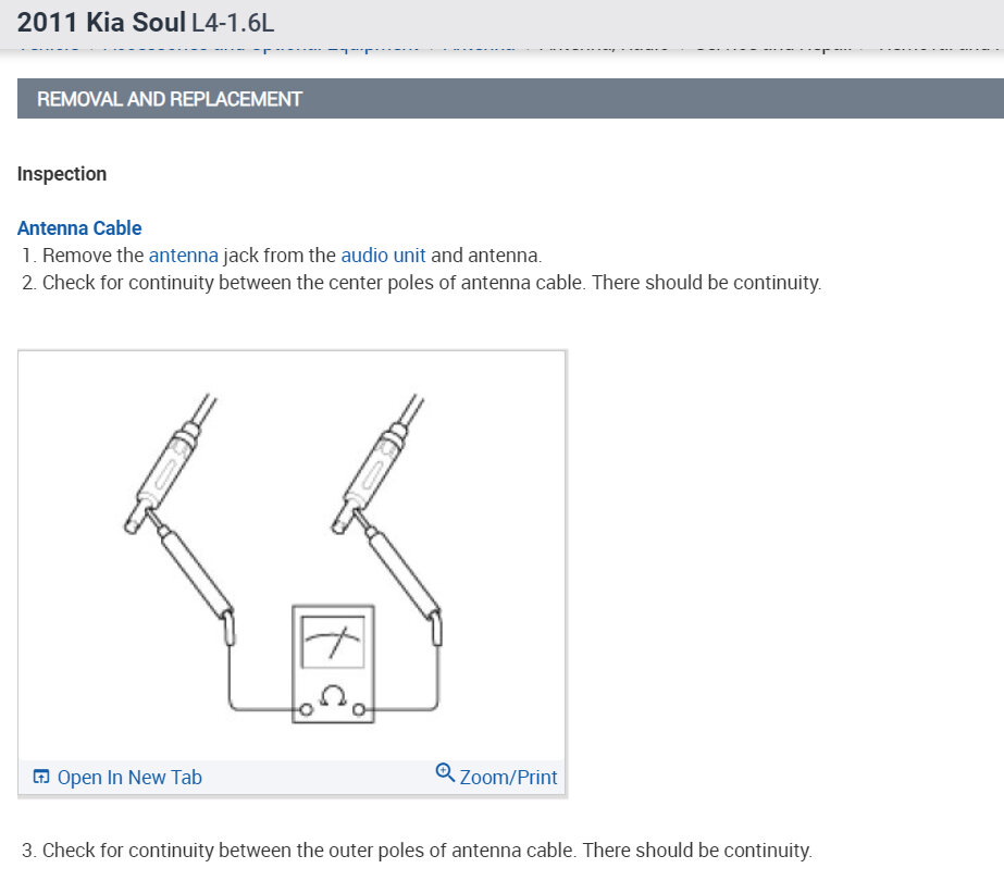

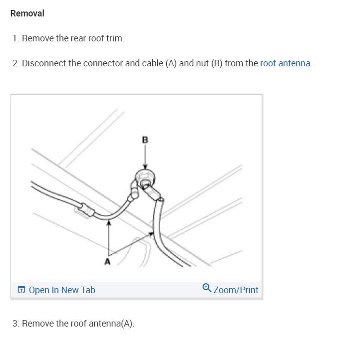

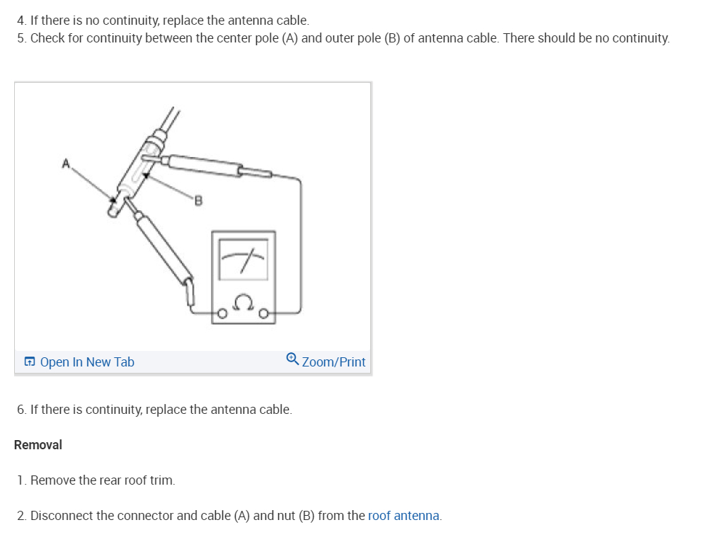

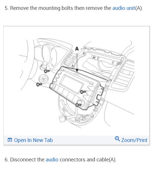

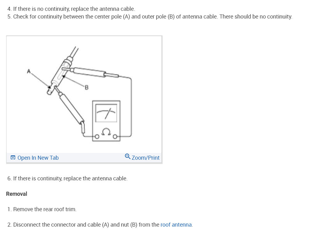

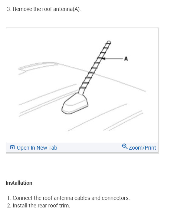

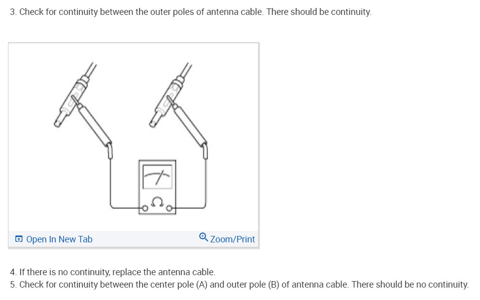

Let's check the antenna first and if that is okay the radio is no good, I have seen the antenna go bad and cause this issue. Here is how to test and change out the antenna. Check out the images (below). Let us know what happens and please upload pictures or videos of the problem so we can see what's going on.
Sep 26, 2023 at 5:45 AM

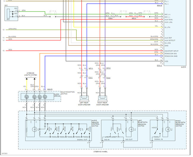

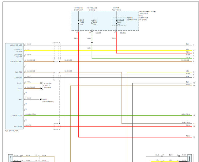

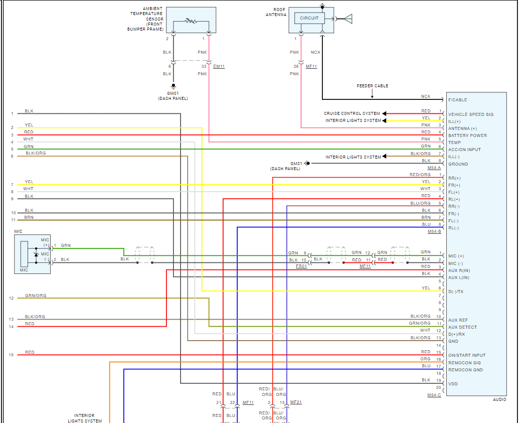

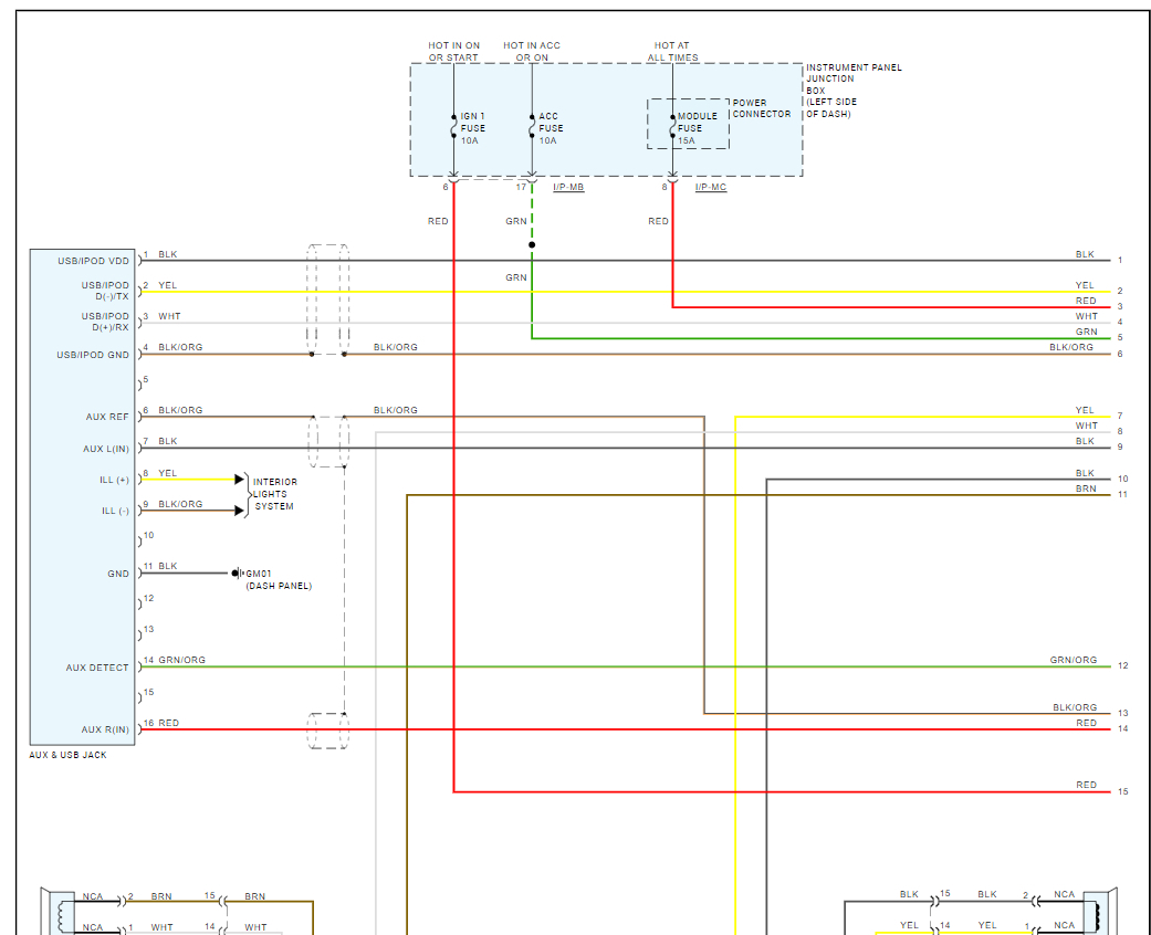

Alternator appears to be fine. Besides, radio always has a problem whether the engine is running or not.

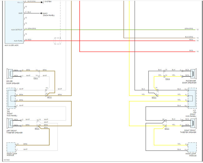

i suspect cable is the problem. Could you give me a diagram for radio cables?
Do you have any other suspects you can think of?
Dec 19, 2023 at 8:51 AM
  • 55,433 POSTS
It does sound like grounding issue, here is the radio wiring and a guide to help you test the connections.
Also, how did the antenna testing go? Check out the images (below). Let us know how it goes.
Dec 21, 2023 at 2:03 AM
JUJU201731
  • 28 POSTS
antenna appears to be fine.
By the way, could you also give me the location of the radio and antenna cables?
Dec 24, 2023 at 8:09 AM
  • 55,433 POSTS

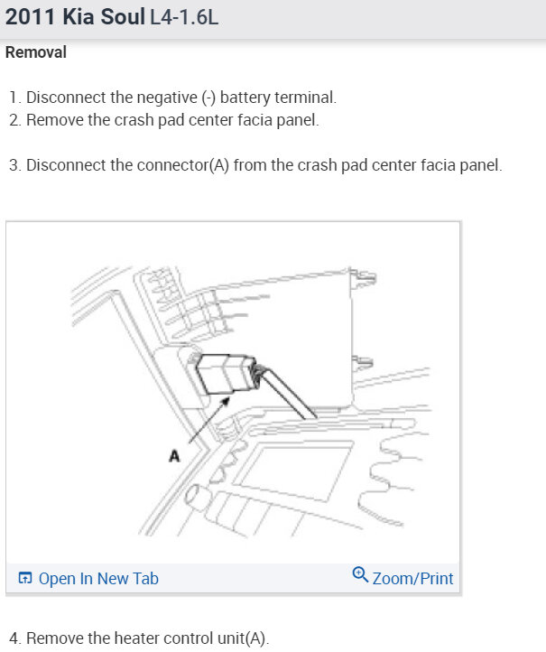

The diagrams in the images above are the only images they give us for the antenna. If you have any questions about the service, please upload images so I can see what's going on.

can you tell me where you get all these images? is there a book available?
Jan 20, 2024 at 9:04 AM
  • 55,433 POSTS
Yes, they are from AllData or Mitchell 1 both have online subscriptions.
