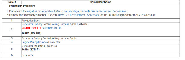

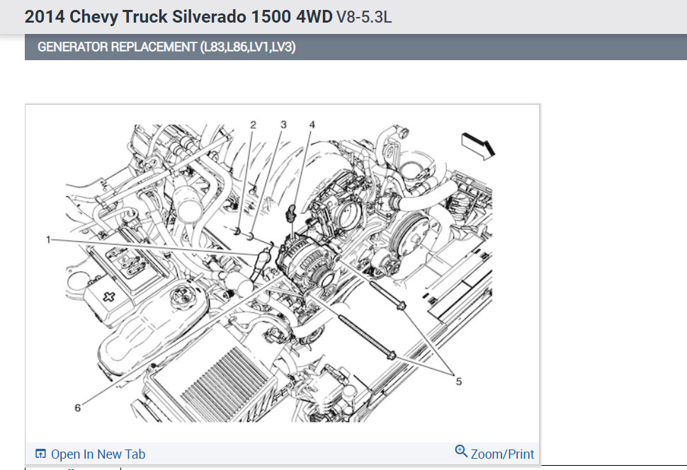

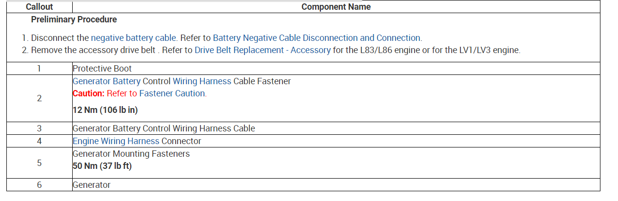

My alternator grounded against a price of metal, I fixed the wiring but the alternator needs replacement.
Aug 12, 2019 at 12:39 PM
Experienced Mechanic
55,540 POSTS
This video shows the job being done on a similar car but the process is the same:
https://youtu.be/d3dt5cQGhmM
Here is a guide to help you step by step with instructions in the diagrams below to show you how on your car:
https://www.2carpros.com/articles/how-to-replace-an-alternator
