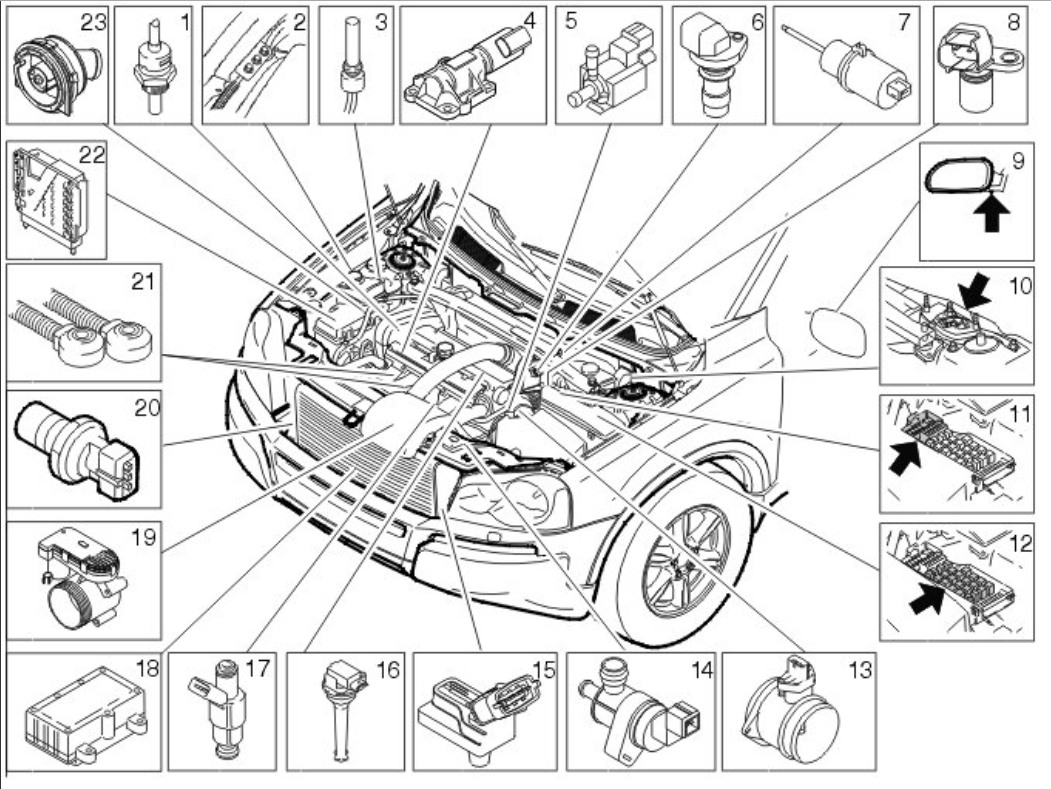

My car is showing P0072 code. i would like to have the description of the code and the location of the ambient air temperature sensor circuit low.

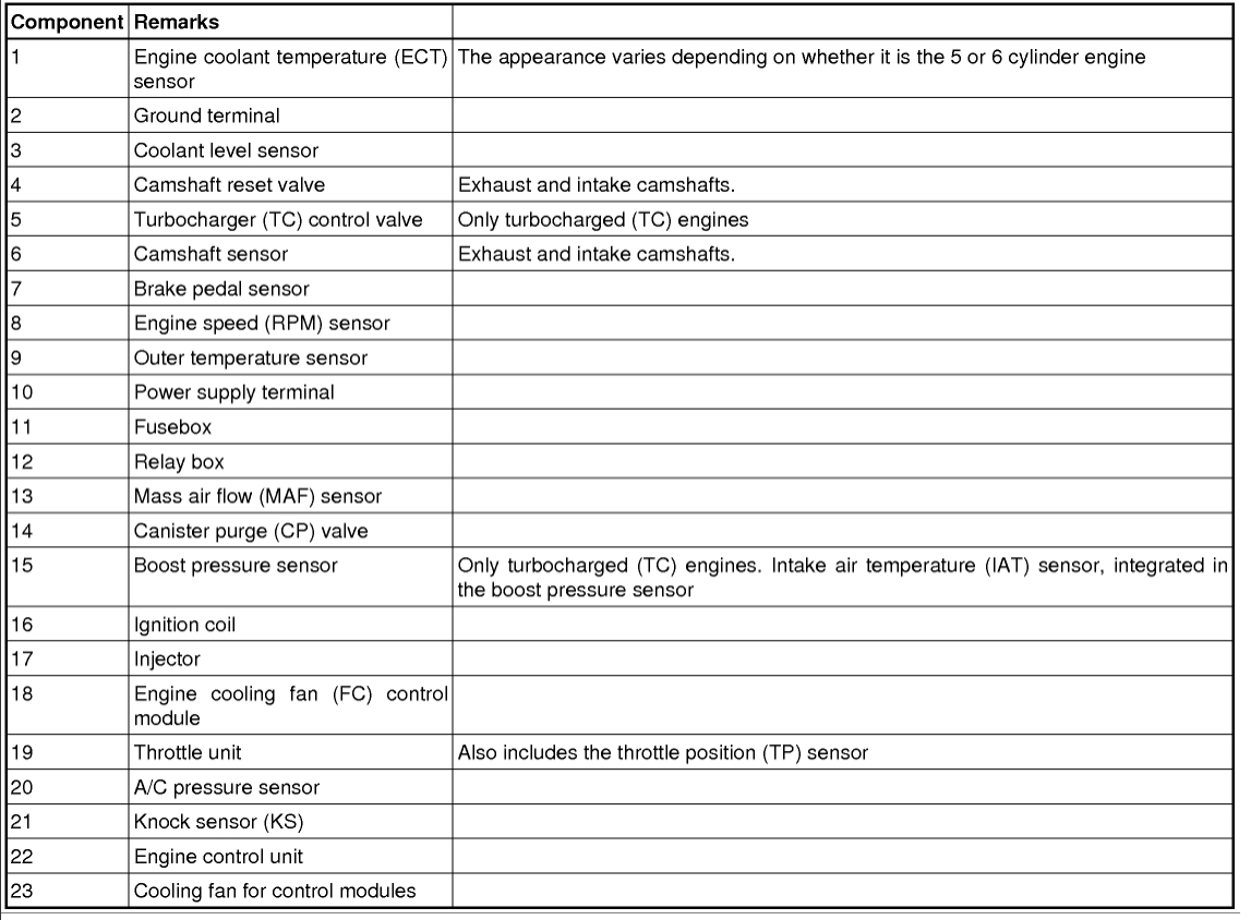

This codes means one of two things; first is the sensor could just be bad and the second is you could have a bad connection. Check out the connector of the sensor first to see what kind of shape it is in.
There is a list on all the sensor in the diagram (below).

But am not getting the diagram of the image clearly.
Oct 25, 2017 at 8:39 PM
  • 55,845 POSTS
It is number 15 in the image integrated into the boost sensor. Click on the image so it will enlarge.
