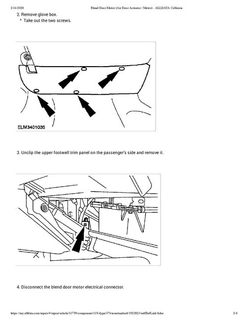

This car's heater doesn't work. The blower works, and the A/C works as far as I know. I want to know what I should look into first as far as fixing this problem. There hasn't been any fluids leaking into the car's passenger side, the fuses are all fine, so could it be plugged up somewhere?

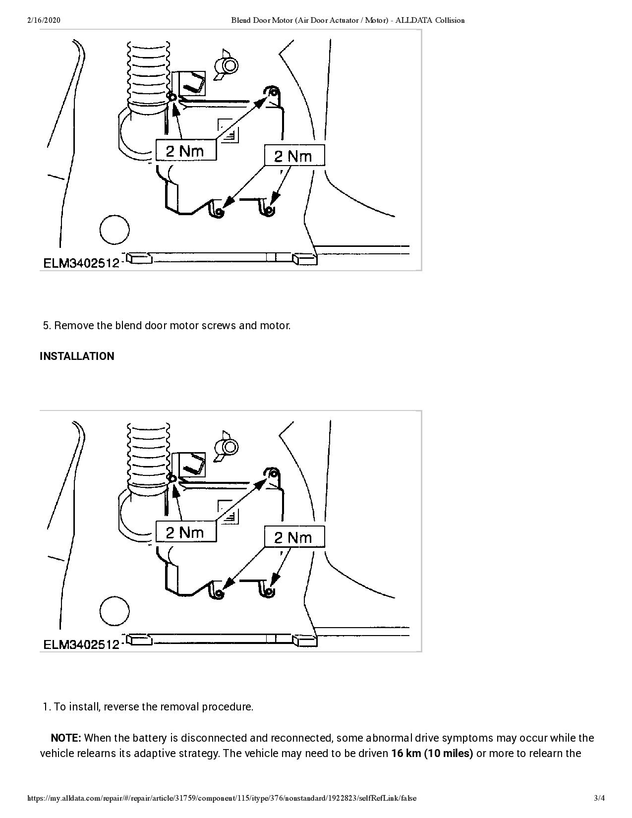

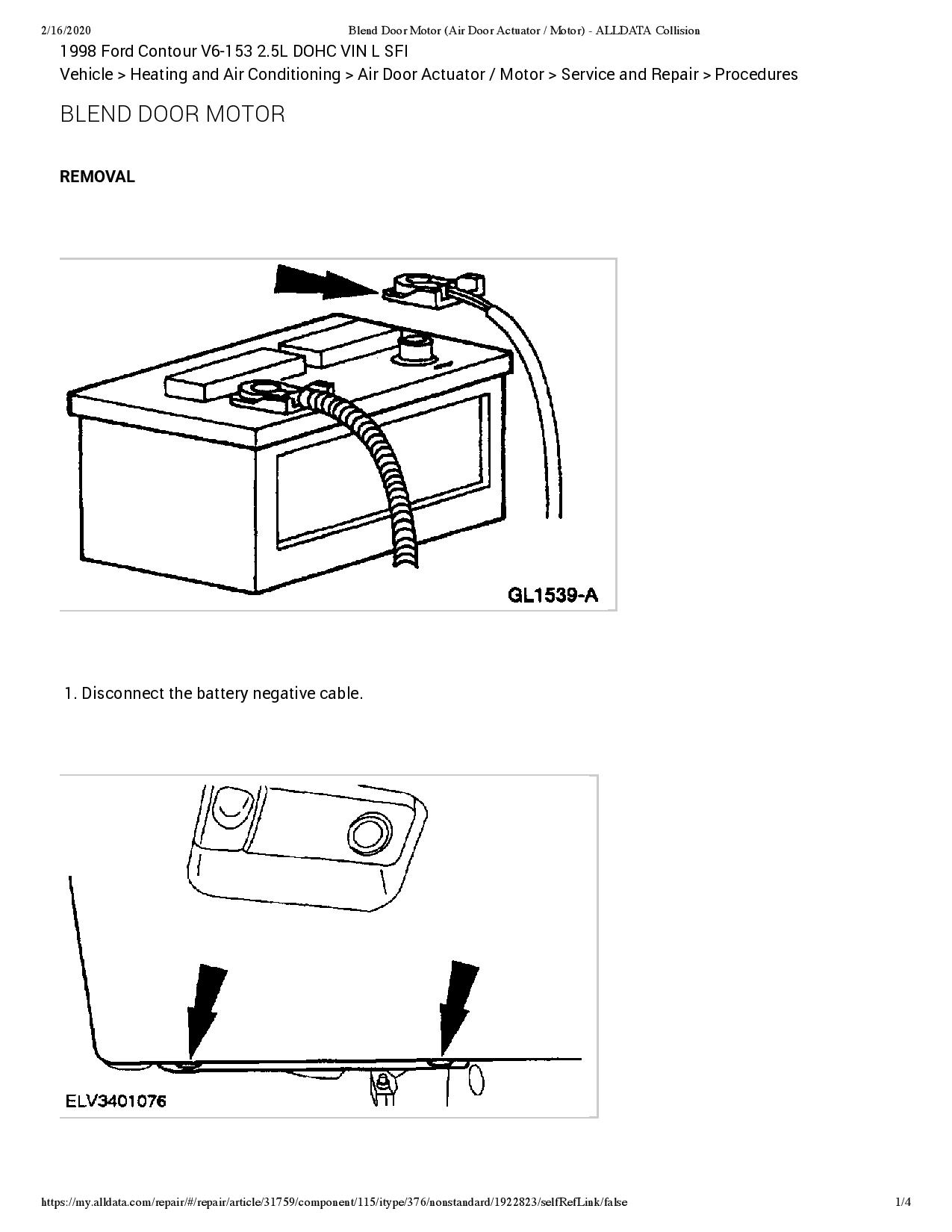

If you have even heat at both hoses of the heater core then you may have a problem with the blend door motor not moving the blend do to channel hot air.
I have attached the instructions for replacing the blend door motor below.
If you change the heater control from hot to cold can you hear/feel the blend door motor moving?
