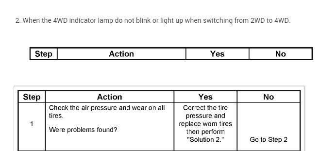

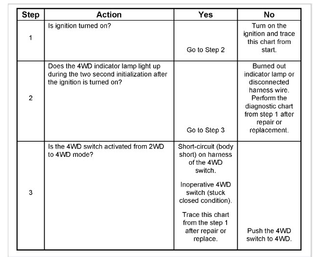

When I turn the switch there's no sound, or click but there is power indicator light.
Dec 29, 2022 at 1:58 AM
  • 110,244 POSTS

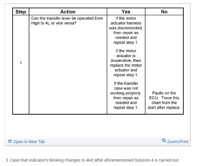

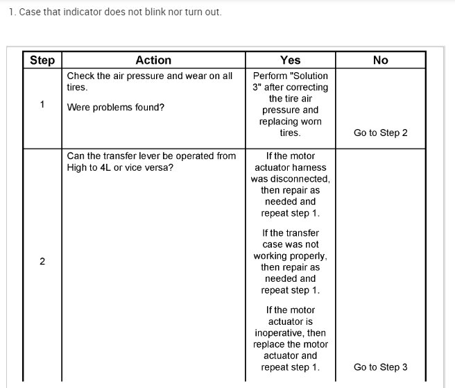

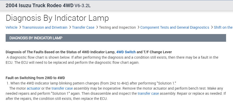

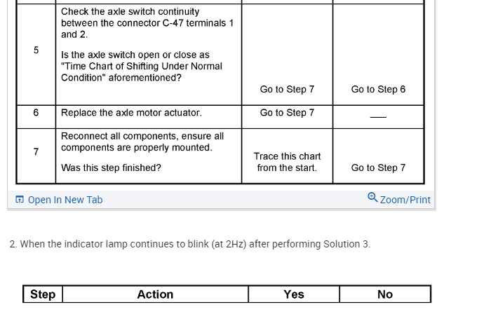

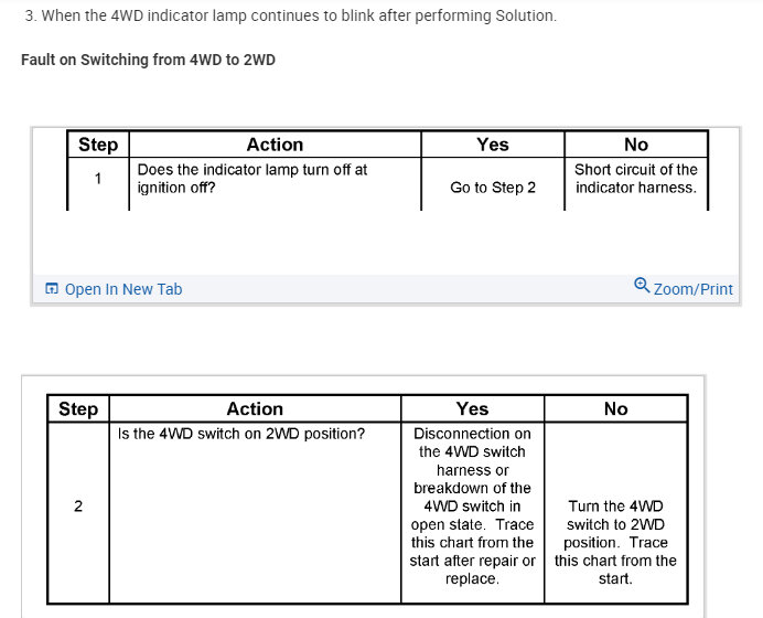

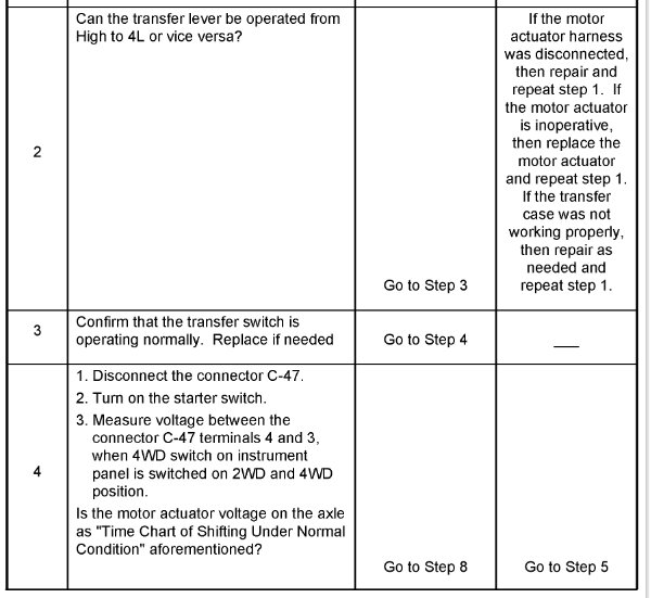

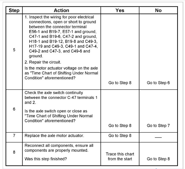

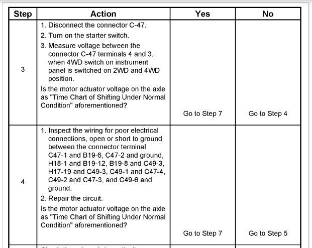

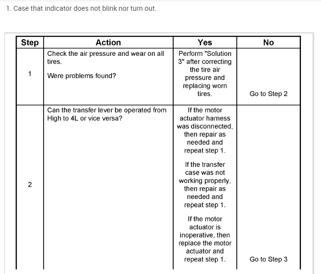

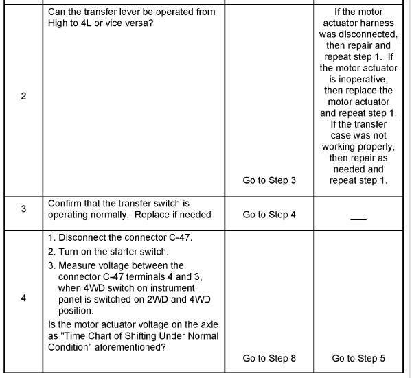

When you select 4wd, does the indicator lamp flash or stay on steady? I ask because the diagnostics are somewhat extensive, and I want to eliminate what I can for you.
I attached the diagnostics below. Take a look through them and let me know if you have questions. Also, if there is anything I can do to help eliminate the steps, let me know that as well.
