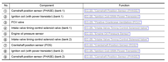

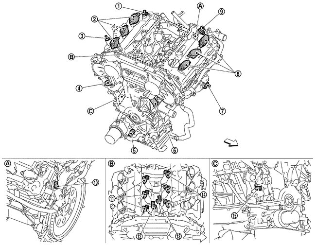

If you find the pressure us good, then I suspect the sensor is the problem. I attached two pictures for you to see. Locate number 7. That is the crankshaft position sensor. Here is a link that shows in general how one is replaced:

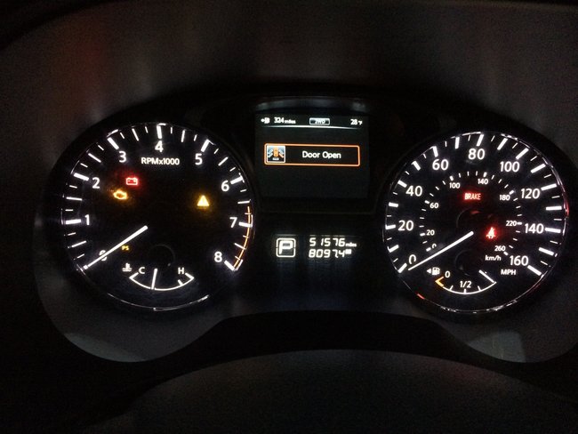

This is what it looked like when it stalled except:
-The warning light was on because the tire pressure was low, not because the door was open.
-There was 1/4 tank of gas, not full.
