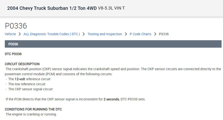

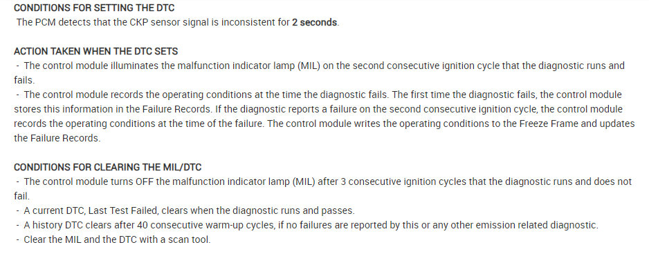

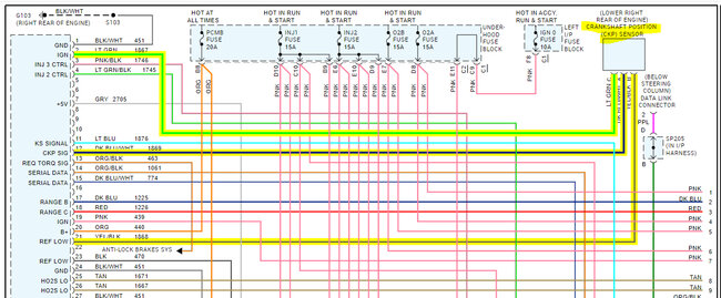

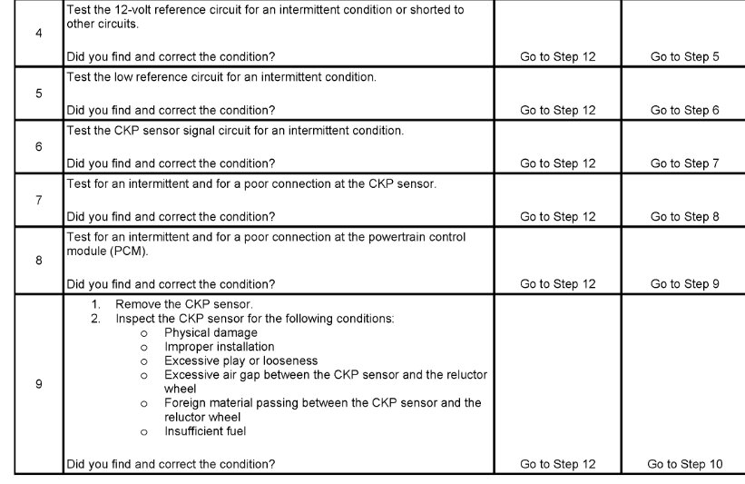

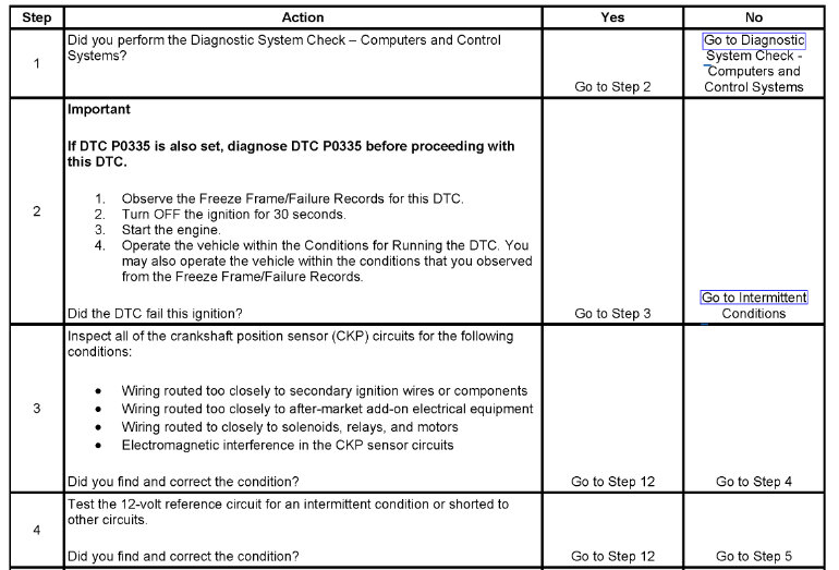

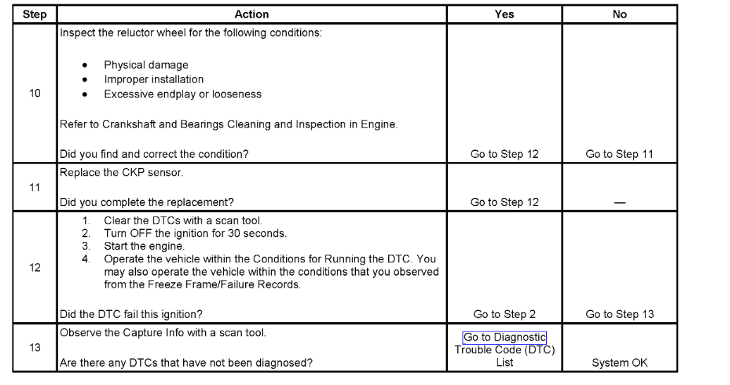

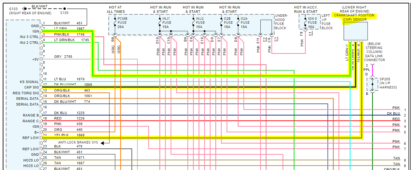

Alright some developments have been made, so the truck threw the code p0336 crankshaft position sensor code. I replaced the sensor and its still doing it. I suspect a wire is messed up somewhere, I've been trying to find a diagram to give me an idea of where to follow the harness to. Haven't found one yet, what other could throw that code if the sensor is good?
Sep 19, 2024 at 6:50 AM
  • 110,248 POSTS
No problem whatsoever. I attached the wiring between the sensor and the powertrain control module for you below. Additionally, I included the diagnostics related specifically to the code you have.
Take a look through things and let me know if it helps or if you have other questions.
