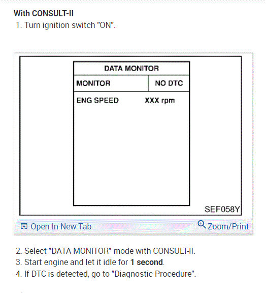

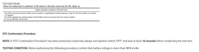

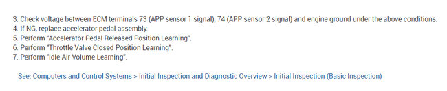

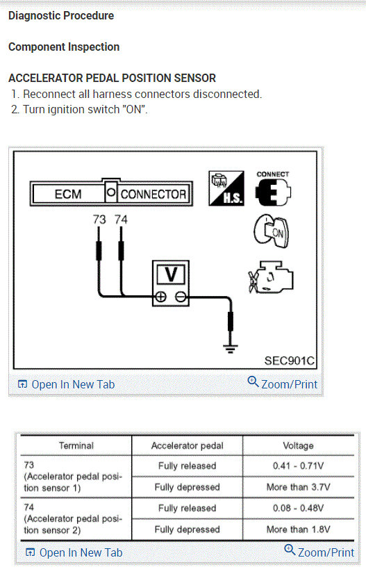

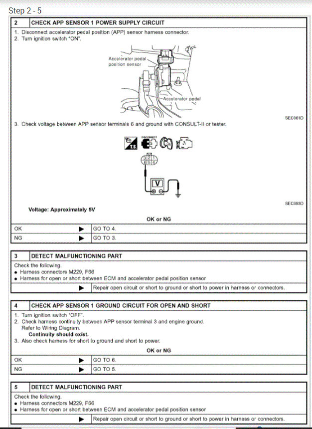

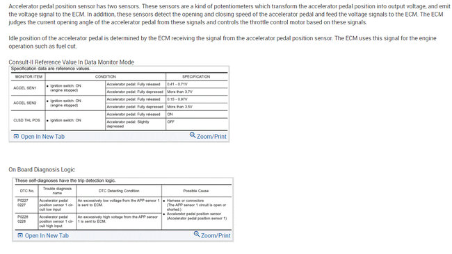

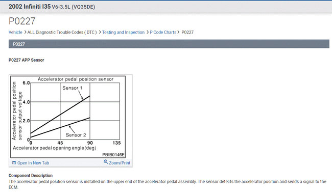

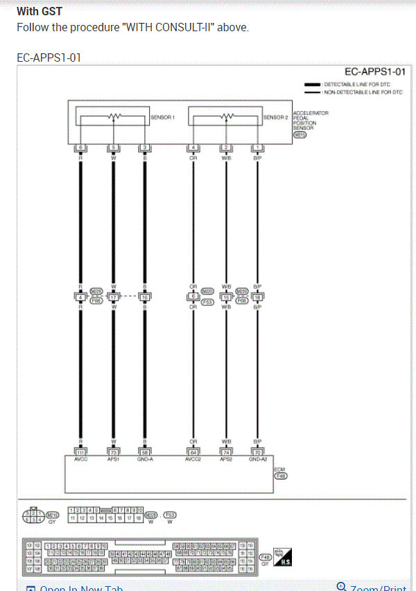

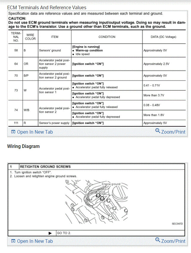

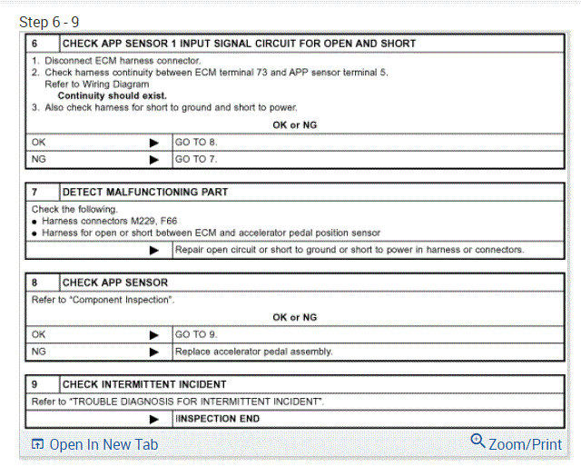

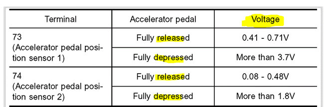

Voltage to the APP isn't an indication that it works. Simply, it indicates it is receiving the power needed to work. You need to check voltages out from the APP to determine if it is working. The APP has two sensors in it that will signal different voltages to the ECM based on the pedal position. If you look at the last pic below, it shows the voltages out. Now, the 1612 (nats) which is related to the immobilizer leads me to believe the vehicle wouldn't start. At this point, it isn't a good indicator that the ECM is bad.
So what I suggest is testing needs to be done. That is the only way to confirm where the problem is coming from. I have to be honest, I suspect it is the APP, but as I mentioned, the only way to be sure is to check.
If you look at the attachments below, they explain how to diagnose the P0227. Once we confirm that isn't the issue, then we can check the ECM if needed. The interesting part about this is if it is a wiring issue, you could replace both and still have the same problem.
If you feel comfortable performing the tests below, here is a link that you may find helpful:
Take a look through the attachments and let me know if you are comfortable doing them. Also, if the mechanic is suggesting to replace both because he isn't sure, start with the cheapest one first, the APP. Why arbitrarily replace both. Don't spend the money on the ECM unless he tells you it's needed. At that point, I would confirm that he is willing to not charge you if it isn't fixed.
