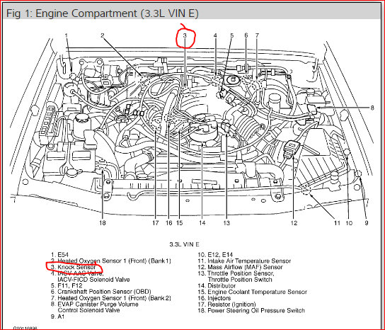

Multiple misfires
2001 NISSAN XTERRA
280,000 MILES • 3.3L • 6 CYL • 4WD • AUTOMATIC
KELSEY M. GIENAU
Knock sensor 1 circuit bank 1. We have changed new plugs wires cap timing belt. Yes engine is in time. Idle is fine. Revs to 22-25 just fine then starts misfiring. And the distributor is working.
Jul 6, 2018 at 6:59 AM
DANNY L
  • 5,648 POSTS
Hello, I am Danny.
Just a quick question to start. Was the Knock sensor tested/replaced? That should have set a check engine light code P0325. I have attached a picture location of the sensor. Danny-
Jul 8, 2018 at 4:06 AM
