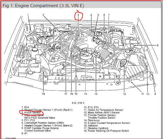

Knock sensor 1 circuit bank 1. We have changed new plugs wires cap timing belt. Yes engine is in time. Idle is fine. Revs to 22-25 just fine then starts misfiring. And the distributor is working.

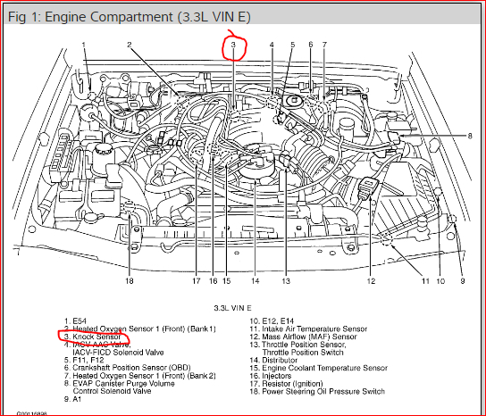

Just a quick question to start. Was the Knock sensor tested/replaced? That should have set a check engine light code P0325. I have attached a picture location of the sensor. Danny-
