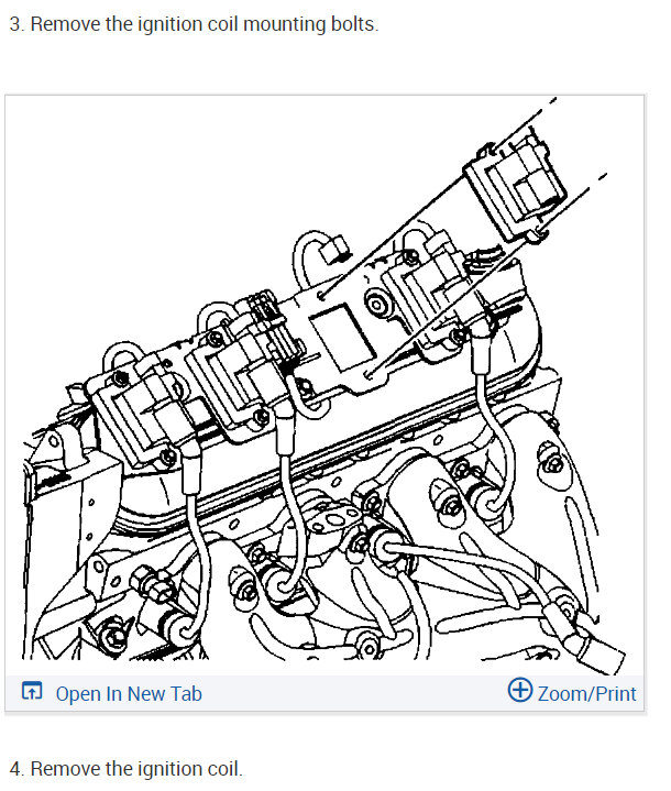

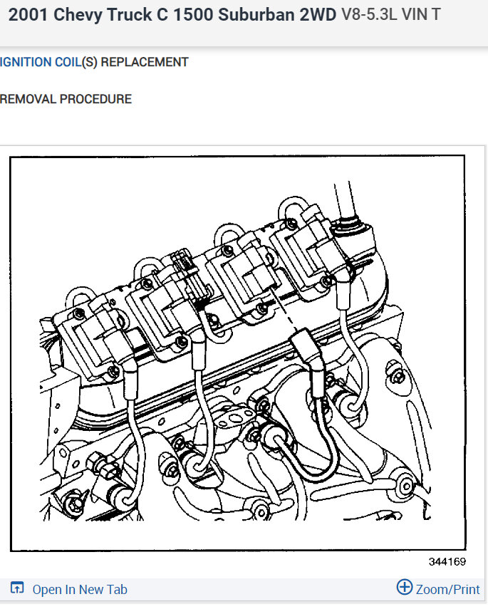

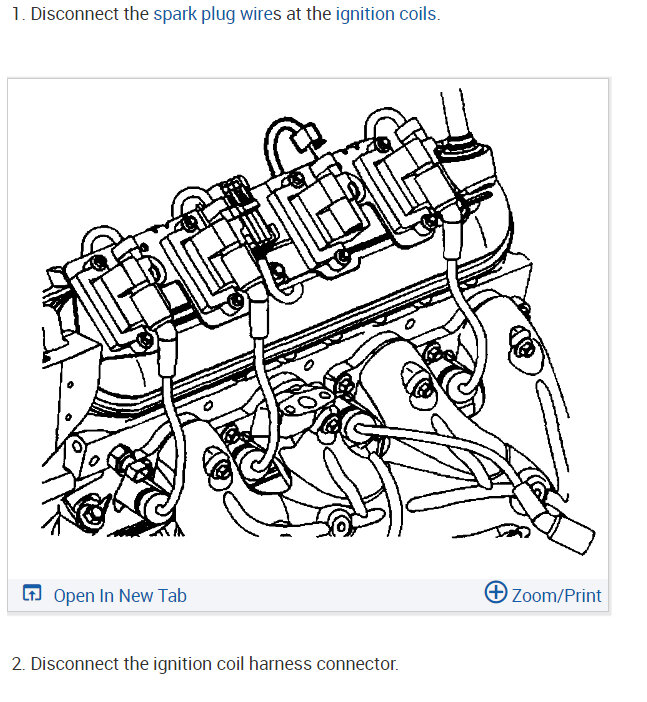

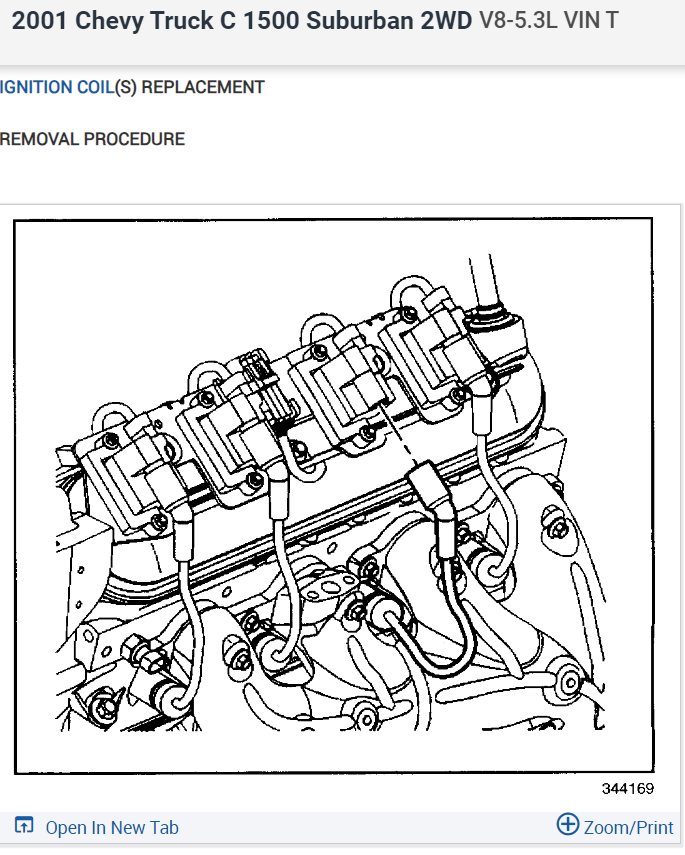

I would start with a tune up with coils and spark plugs and I would service the throttle bore and IAC valve. Here are guides to help us rule these things out, also can I ask if the check engine light is on? If so we should run the codes to help point us in the right direction.
and
https://www.2carpros.com/articles/how-to-tune-up-a-car-engine
And this video to show you step by step on how to service the throttle bore:
https://youtu.be/Z3LDHdS1upo?si=dN6oiJTnUJ4IcYxI
I would replace the spark plug wires as well.
Spark Plug Type .................... Denso: PTJ16R15
Check out the images (below). Please upload pictures or videos in your response of any problems so we can see what to help you with.
